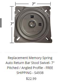

July 14, 20188 yr comment_154106 9 hours ago, PeteM said: Thinking of the recent discussions here about woodworking, your stools are the why of it. Nice custom jobs. How'd you do the swivel "back to center" thing? There are two types of chair swivels 1) those that are flat and just go round and round https://www.woodcraft.com/products/swivel-flat-1-thick http://www.rockler.com/heavy-duty-swivel 2) those that have a slight tilt, rotate only so far in each direction and return to zero. https://www.woodcraft.com/products/swivel-return-1-1-16-thick http://www.rockler.com/3deg-tilt-swivel-select-standard-or-deluxe-swivel Edited July 14, 20188 yr by kmealy Report
July 14, 20188 yr comment_154109 1 hour ago, kmealy said: There are two types of chair swivels 1) those that are flat and just go round and round http://www.rockler.com/heavy-duty-swivel 2) those that have a slight tilt, rotate only so far in each direction and return to zero. http://www.rockler.com/3deg-tilt-swivel-select-standard-or-deluxe-swivel I am confused. I thought that he was talking about a swivel that rotates back to zero not a seat that tilts back to level. I have never heard of the former, a swivel that would rotate the seat back around to facing the counter after a person got off. Herb Report
July 14, 20188 yr Author Popular Post comment_154110 24 minutes ago, Dadio said: I am confused. I thought that he was talking about a swivel that rotates back to zero not a seat that tilts back to level. I have never heard of the former, a swivel that would rotate the seat back around to facing the counter after a person got off. Herb This is the swivel I purchased from chairpartsonline.com. It is tilted approx 3 deg and has a spring which allows the seat to return to the same position it was at when you sit on the stool. Danl Report
