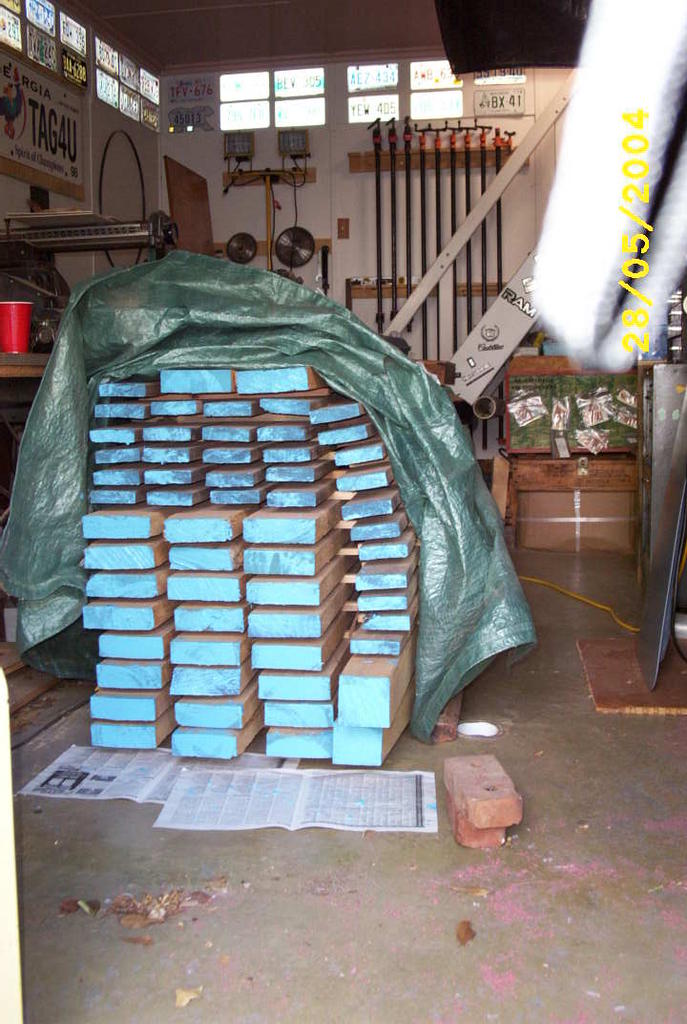

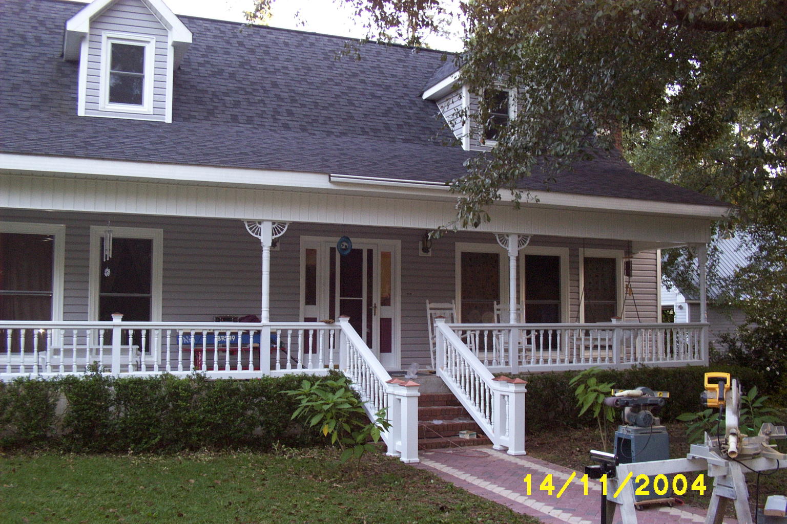

July 8, 20188 yr Popular Post comment_153488 Larry, my son & I turned about 80+ balusters and made the handrail for our front porch. Probably done about 10 years ago and they have held up very well. Turning the cypress was very easy. I bought it directly from a local mill and had it kiln dried before starting the project. Report
July 9, 20188 yr Author comment_153591 Thanks, looks very nice. What diameter are the spindles? Report
July 10, 20188 yr comment_153601 Love the porch Cal...classic deep South look that just exudes "come on up, have a sweet tea and sit for a spell. Of course a warm slice of pecan pie along with the sweat tea would make it just that much better. Report
July 10, 20188 yr comment_153612 On 7/8/2018 at 5:26 AM, Cal said: and made the handrail for our front porch that's some 1st rate Cal... Report
July 10, 20188 yr comment_153613 On 7/8/2018 at 5:26 AM, Cal said: and made the handrail for our front porch. that is some serious 1st rate you have there Cal... Report
July 10, 20188 yr comment_153618 14 hours ago, Larry Schweitzer said: Thanks, looks very nice. What diameter are the spindles? Just measured the blank at 1 7/8 square. I probably tuned half a dozen or so from scrap lumber before deciding on this shape. This was a simple, easily replicated shape that our son & I knocked out over the course of a couple weeks after work & school. Report
