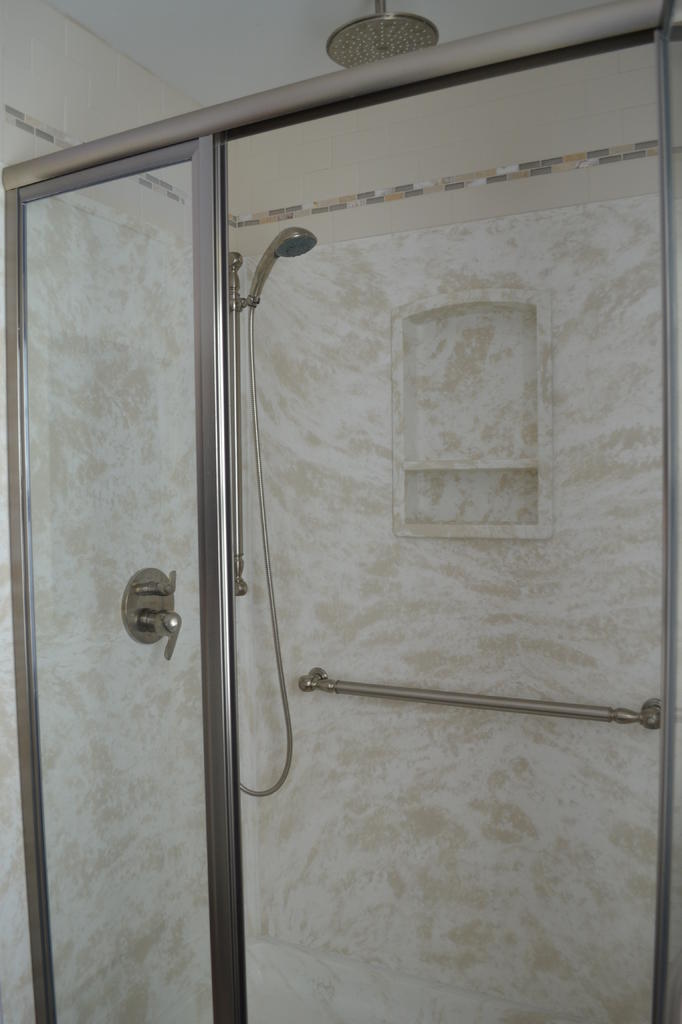

June 26, 20188 yr comment_152571 Mike, are you committed to tiles? I did this a couple years ago, but went with some type of man made marble or something. Shower pan and walls, real happy with the finished product. Report

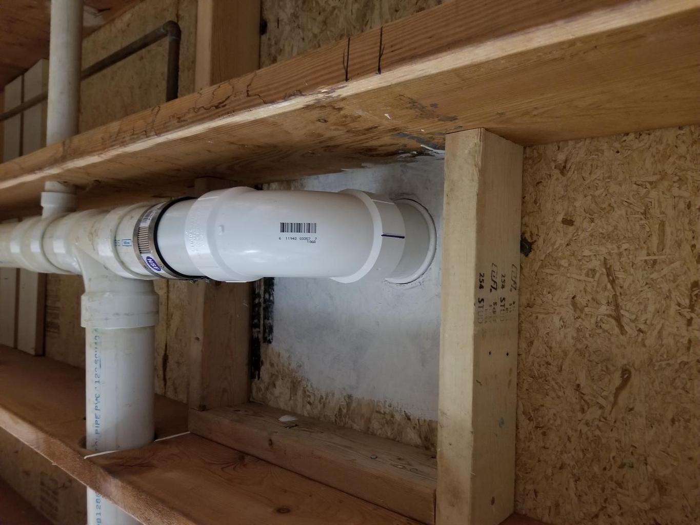

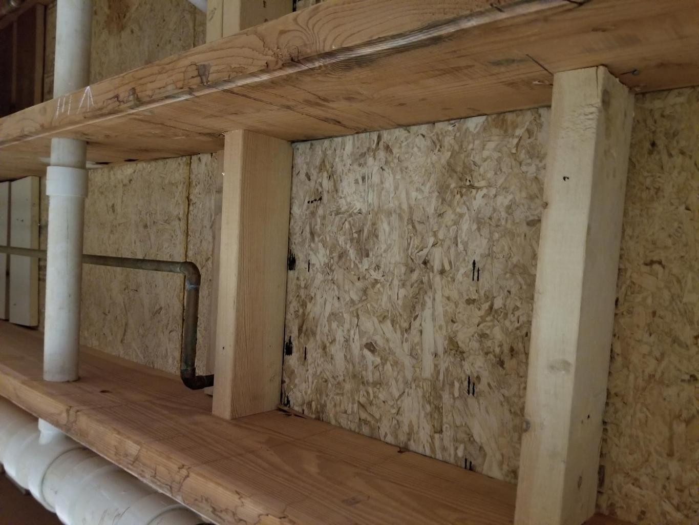

October 2, 20188 yr Author comment_161376 I will be posting pictures soon. So far found the joists were comprimized by the plumber and engineer is recommending some corrective action. How ever electrical and plumbing are in the way of sistering the joists. So we are going to install LVL's then a cross beam to carry the load of all the compromised joists. The OSB had water damage and was never sealed. Had to install 2X4 ledges for the floor to sit on. Painted sealed and now the shower pan is down. More to come. Report

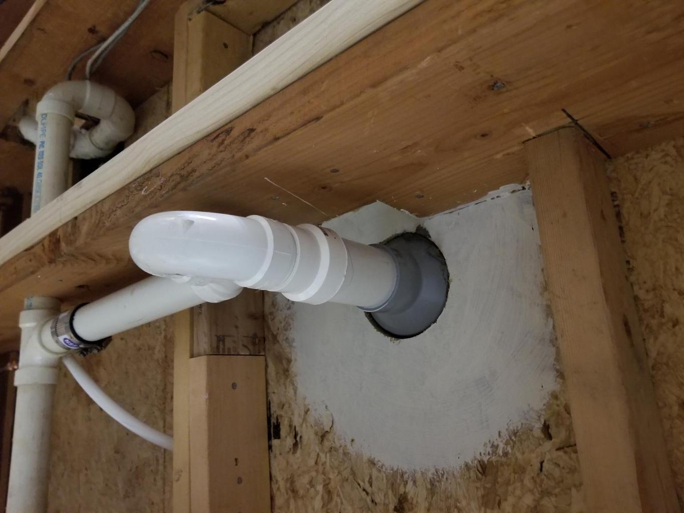

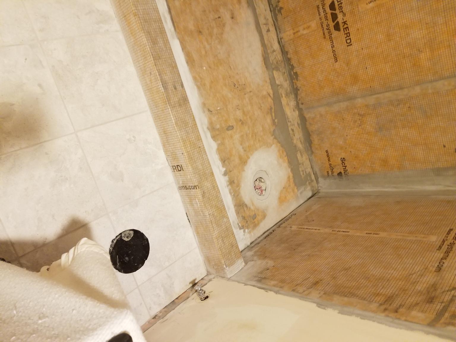

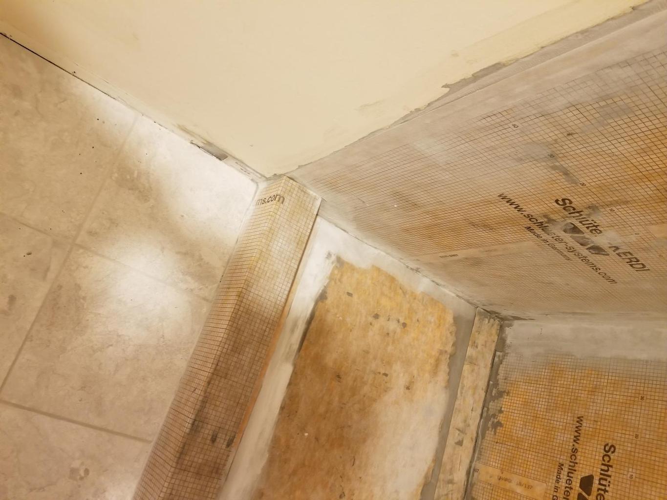

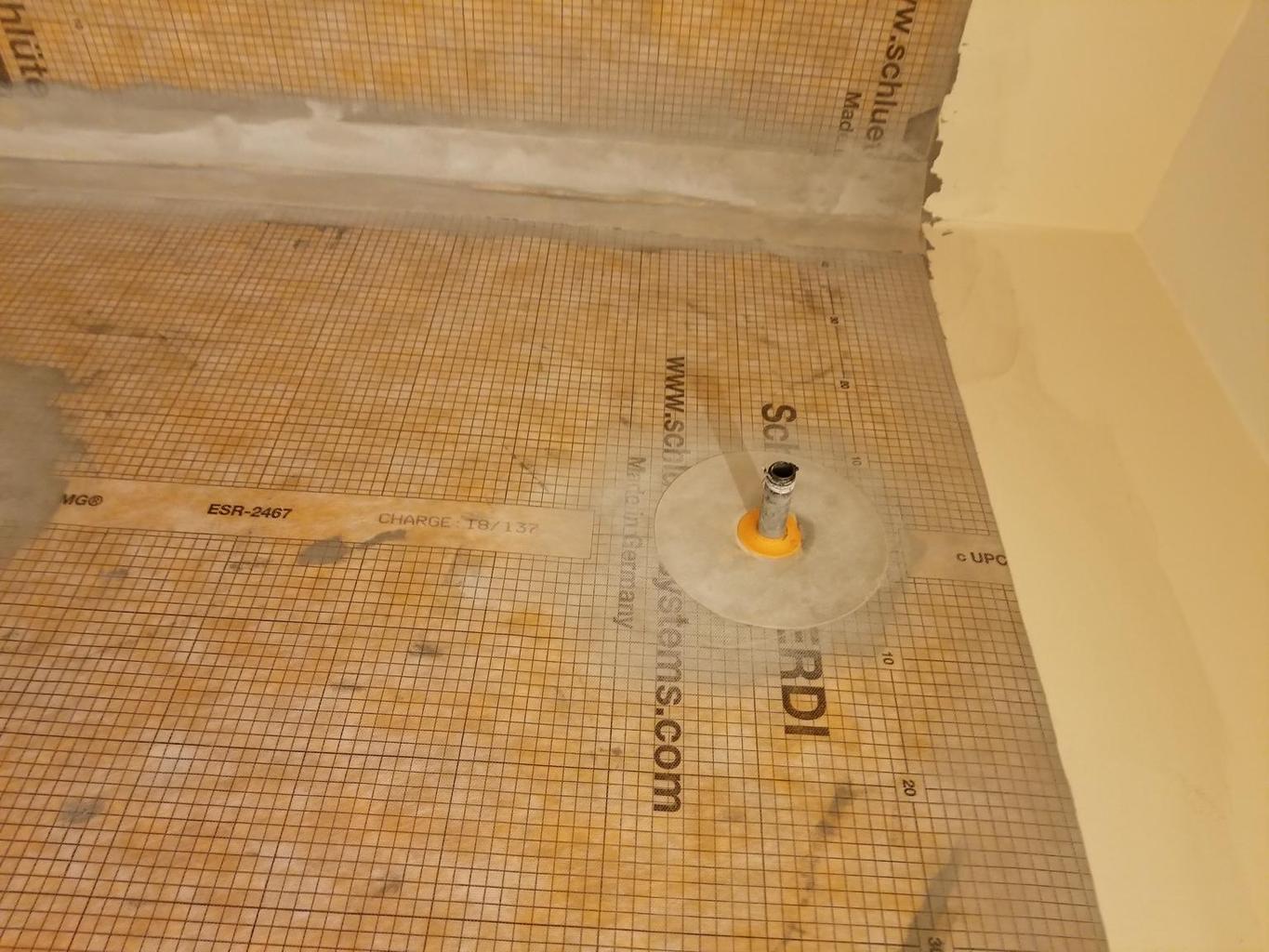

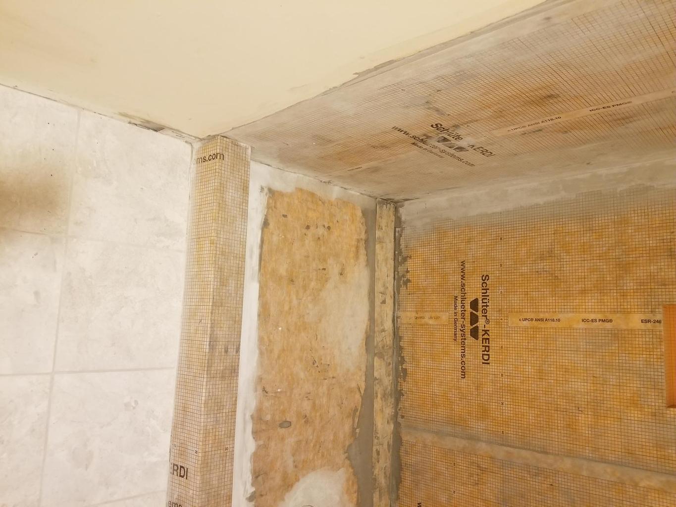

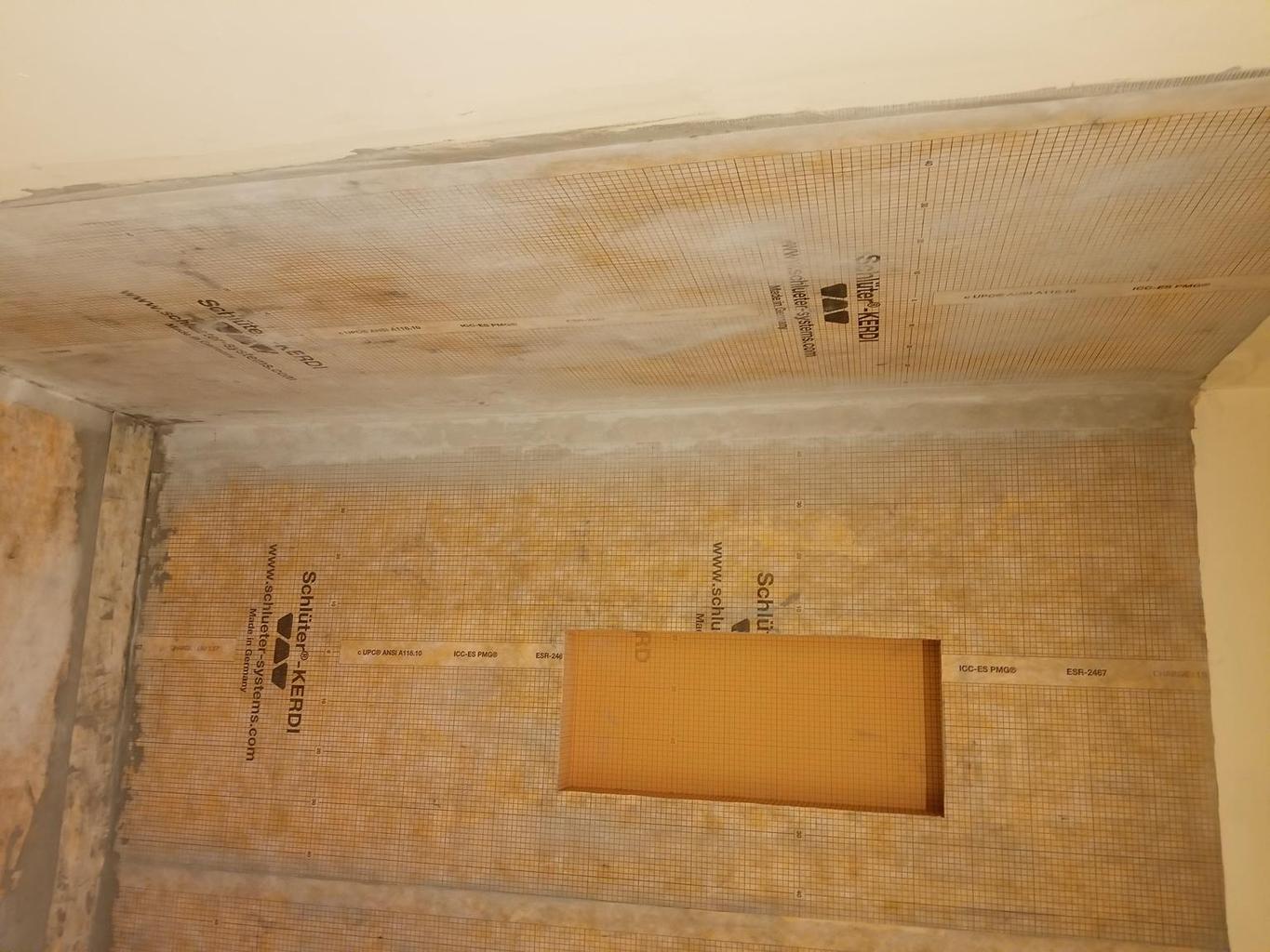

November 5, 20188 yr Author comment_165374 All Shulter may have cost me more $ but so far thier product is really easy to work with. Turns out the bathroom floor is flat but slopes toward the midline of the house. Which by the way is an aid to channel water to the drain. We did level the curb and had about 3/8" to 1/2" of more material on one side than the other. We went with Ditra Xl but I had to get it installed before I couuld post pictures. Due to a plumber visit to set the vanity. The shower base and curb are Shulter poly styerene. Much warmer than fiberglass. The said we had to dry pack the shower floor 3 1/2" away from the wall to put the drain between and not in the middle of joists. Then we applied a Shulter shower kit and put their orange fleece lined water proof sheets on the walls and floor. Then we will apply tonight the corners and kerdi band around the permiter of the shower base to finalize the waterproofing. Then we start the tiling hopefully this coming weekend. I will post some pictures tonight. Report
November 5, 20188 yr Author comment_165383 Rotten OSB replaced The the Shulter system. Sorry I am not better about uploading pictures. Report
