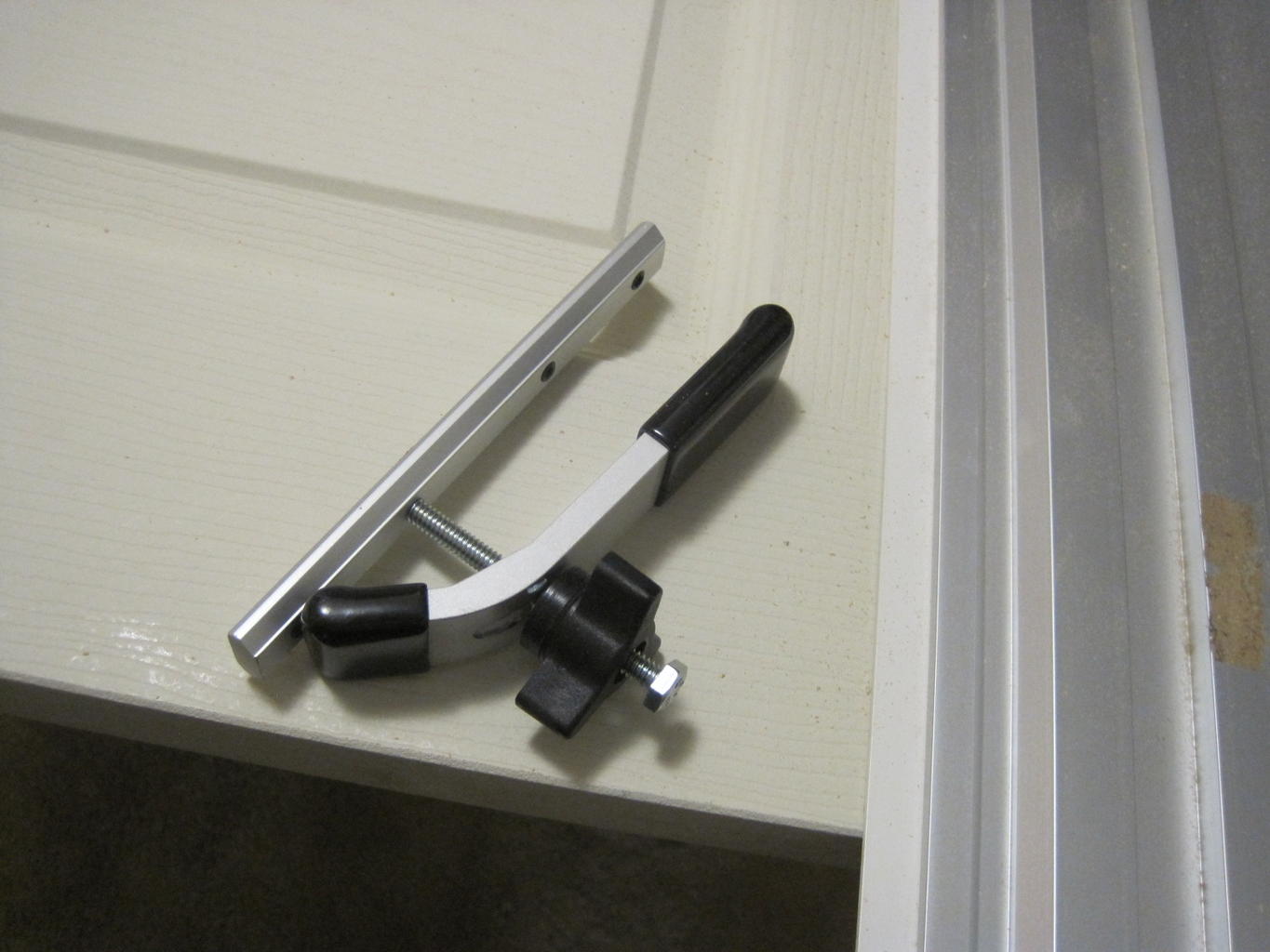

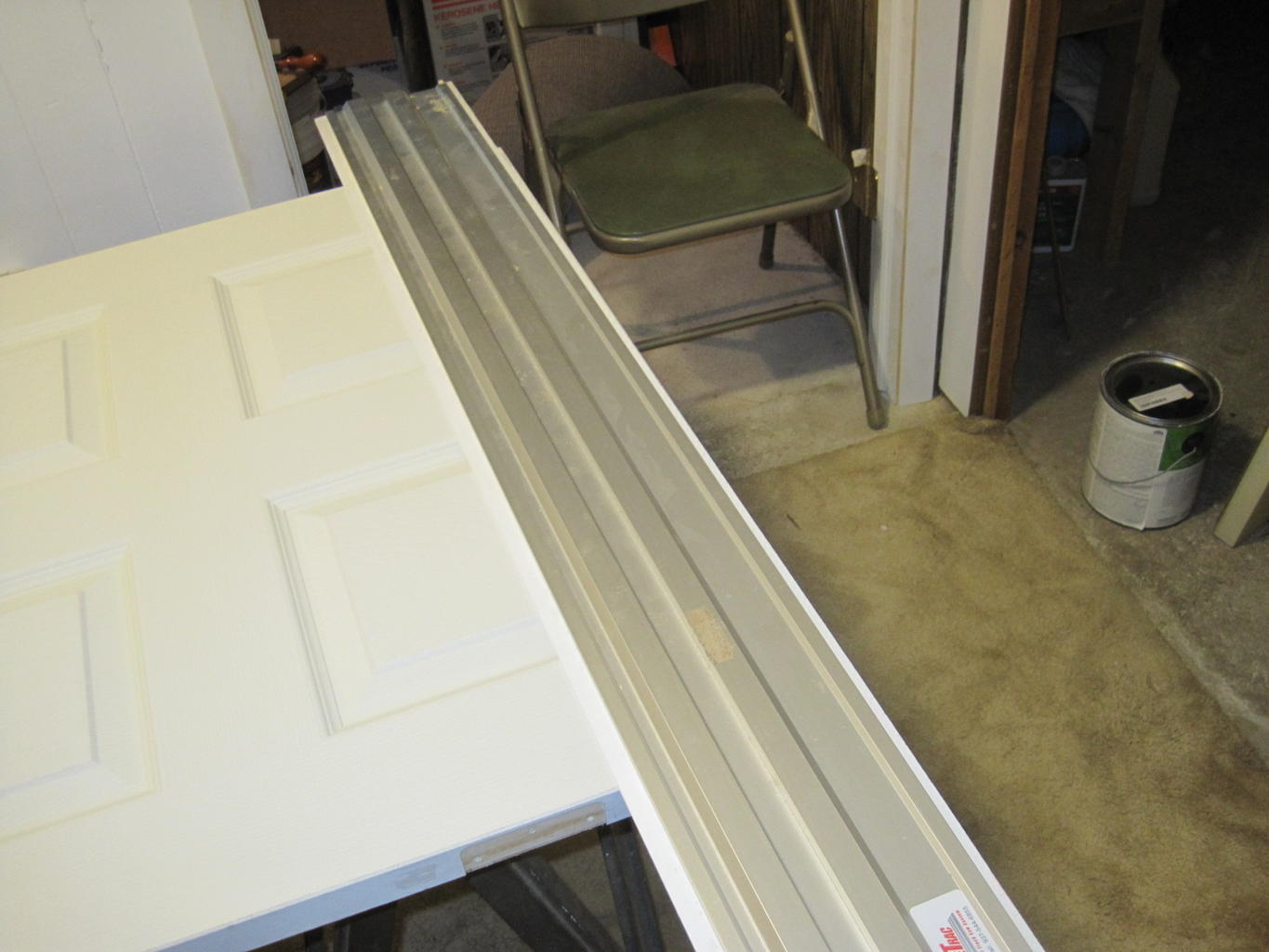

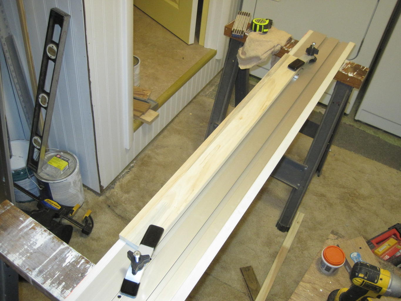

May 23, 20188 yr Popular Post comment_149976 I have a Tru-Trac, the first rail I bought many years ago. It's my first choice when cutting off doors, shown here trimming up a panel that I biscuit-joined from two smaller ones. I have since switched to Eurekazone because they seemed to be expanding their product past just a basic track - I have their bridge/router set-up for cutting dadoes across panels - but still reach for the Tru-Trac for straight cutting. I feel that their tapered alignment on the track is much easier/quicker than trying to line up the square rib seen on other brands (even Festool), the saw almost seems to line itself up with the track. EZ had more to offer in the way of clamps and other accessories which was my main reason for switching. Here the track is set up to trim the bottom of a door - you can see the partial label at the bottom. At the time, Tru-Trac didn't offer a clamp, this is what I cobbled up using a piece of connector extrusion. Here a tapered filler is being cut - the cut line is marked on the top of the part, the anti-chip edge aligned with the pencil line and the track clamped to the part. With the track flipped over, showing the part trimmed to the required taper. As an aside, part of the reason that I like the Tru-Trac may be the Milwaukee saw that I have set up to use with it, perhaps the smoothest circular saw that I've used. Take care mounting the saw to the base - I'm guessing that they still provide a little jig for setting the base parallel to the saw blade (a critical step if you want good results), very basic but it gets the job done. Report

May 23, 20188 yr Popular Post comment_149992 3 hours ago, Fred W. Hargis Jr said: That system does look interesting. I'm a big fan of track saws but am wondering: the only circ saw I have is a PC with the blade on the left side, would it work with such a system? A lot of folks often mention the Eureka zone system, this is the first I had heard of Tru Track. I believe that Eurekazone came first and Tru-Trac is an offshoot - a little history there as I understand. With a LH blade saw, the blade runs down the anti-chip strip on the left of the (symmetrical) track, and the "offcut" would be to the left, with the keeper part on the right and under the track. Otherwise, you would have to offset the track by the width of the saw kerf. Before the Tru-Trac, I had a homemade guide - 1/4" tempered hardboard with a plywood fence - both work the same way but the track seems a little more convenient somehow. The commercial tracks normally come with some type of "anti-slip" feature so they don't need to be clamped in most situations - pre-finished plywood and melamine both need to have the track clamped, but I normally clamp the track when I'm trimming a door too, but then I'm kind of a belt and suspenders type. Report
