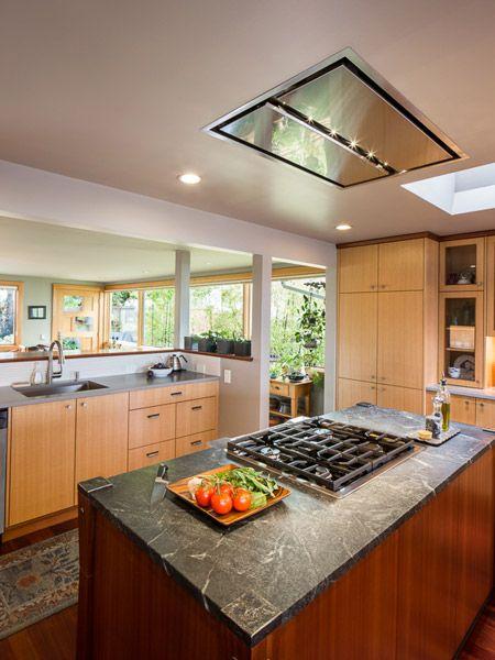

May 11, 20188 yr comment_149021 We having our kitchen remodeled. The current setup has an electric Jenn air range with downdraft vent, and in all honesty it works quite well. But we want a gas cooktop, and we'll also have an electric wall oven installed in the new kitchen. Because the cooktop will be on an island, it would have to be a downdraft model, or we would need an overhead range hood installed. I'd like to avoid the overhead hood, since having it hanging in the middle of our smallish kitchen would block the openess we now have, plus it's fairly expensive. That leaves us with a choice of a downdraft cooktop, or an unvented one with no other venting. The 36" downdraft cooktops I've found all really look like crap, at least in the photos I see. The vent is in the center portion of the range with one burner on the right and 4 burners on the left. The unvented ones are much nicer looking with the burners arranged symmetrically. Here's my question: how bad is it to have a gas range in a kitchen that doesn't have an exhaust vent? Are there CO problems, or steam, or heat that are any different than an unvented electric range would have? Report

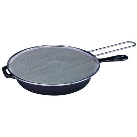

May 11, 20188 yr comment_149043 Also Ron, it does not have to be a low overhead vent system. At this point with the design you have going, you should only be concerned with moving unwanted air out, that may stay in, for example seafood, or other aromas that are excellent around dinner time, but not so pleasant hours after or the next day. So with that being said, use an anti grease splatter if you don't already when frying, we do, and they work great! Now to move the air while cooking, if you are able to place a small vent hole with a fan directly above the cooking area in the ceiling, I'd say go for it. And you could do it quite handsomely if we get creative (creativity is your middle name Ron) you can even make it look really cool. How about a small tiled area applied directly to your ceiling around the small fan, how about something made from wood? How about some recessed lighting above the cooking area, but one of the lights will actually be a small fan. Remember, we are not concerned with filtering out grease in the air etc, you got that covered pretty good with the splatter guard. But what you can draw out is the unwanted aromas, and steam. Just doing a little research I also found a flush mount range hood as well, now that's pretty danged cool. Broan ceiling mount ventilator, $236 Report

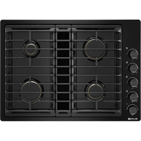

May 12, 20188 yr comment_149104 I replaced an island jean-air downdraft electric cooktop with a jean-air gas cooktop a few years ago. I used the same downdraft ducting. The gas model had 2 burners on each side of the vent opening, just like my electric version.This their current model. Report

May 13, 20188 yr Author comment_149146 Thanks for all the replies. I did find that Broan downdraft mentioned and I intend to ask the contractor of that's an option for us. But it sounds like using the gas itself without venting is not a problem, though the smoke and odor might be. Report

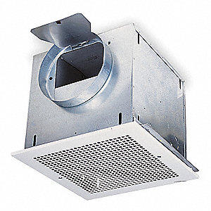

May 13, 20188 yr comment_149172 You might consider a bathroom ceiling vent, which is probably what the Broan is often used for. I have a Panasonic unit in my bathroom, similar to the broan but it includes lighting. Report

May 14, 20188 yr comment_149182 Fred, the Broan I was referring to was the one that John had pictured. Probably not a choice unless the home is only one story. It vents thru the roof. Report
