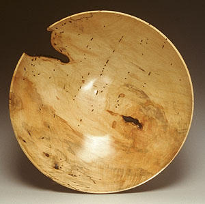

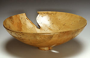

Lissa, insect holes in wood are natures way of providing you with design opportunities.

Sawdust and glue.... Keep the holes....
