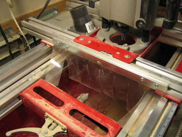

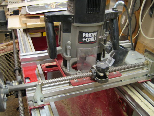

On this legacy ornamental mill I have is thick strips of clear flexible plastic that are laid overlapping each other to stop the chips from flying all over the place. Something that came with the machine. And being clear I can still see a little through it. This is where I might be positioned to watch the router while it is running. Wouldn't be hard to make something like that.. This soft plastic is about 1/16" thick. I thought they overlapped a little but after looking that is one piece with slits cut about 1 1/4" apart.
  You should be able to make one that circles the router with out much problems.
