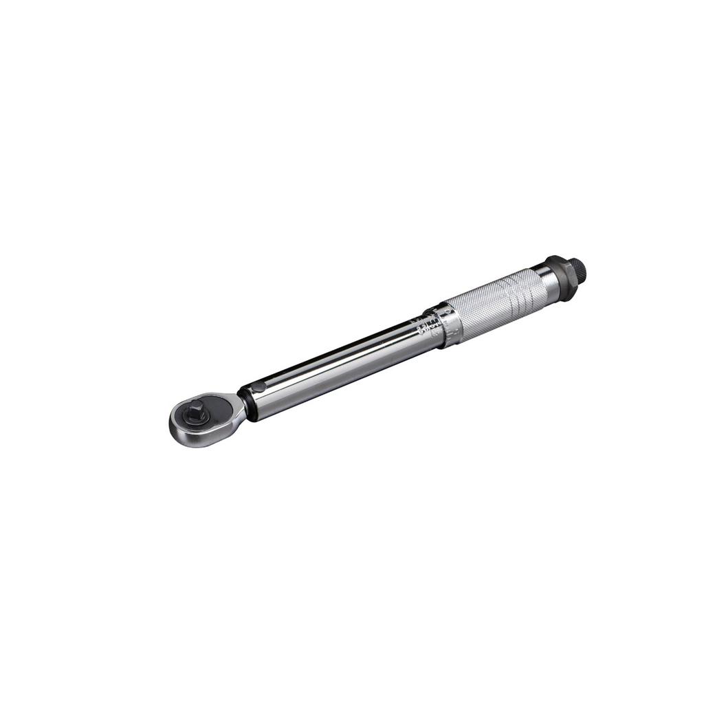

Gene Howe Posted March 24, 2018 Report Posted March 24, 2018 Herb, in case that torque wrench fails.... Inch pound one from HF. $19.99. Grandpadave52 and HARO50 2 Quote
Grandpadave52 Posted March 24, 2018 Report Posted March 24, 2018 26 minutes ago, Dadio said: They sell for $45./10 pack. It would take 3 packs (30ea.) to do a complete change over and have 6 ea. left over. they rotate 90 deg. to make the second blade. This means that for $136. you get 2 sets of blades with 6 left over to use on the next set. So the next 2 changes you only have to order 2 packs @$90. total to complete the next 2, which means you can get 4 changes for around $56. ea. change and that is comparable to the change over of most planers with HSS cutters, and these are Carbide. Math story problems are not a strong suit anymore. Thanks Herb...Wonder if any of Grizzly's might interchange. Makes sense they are not a proprietary part, but more off the shelf items to reduce production costs. Not that it's an urgent issue anyways, but you might want to Bookmark this site for future reference. Cutech is not specifically listed Yet anyways but General, General International, and some Craftsman for this particular search.They do give dimensions & general specs so maybe??? They have both a CA & US help number. My Woodcutters Dadio and Artie 2 Quote
Grandpadave52 Posted March 24, 2018 Report Posted March 24, 2018 2 minutes ago, Gene Howe said: Inch pound one from HF. $19.99. Sometimes $9.99 with a coupon and don't forget choices of free flashlights, multi-meters, screwdrivers, 25' tape and most recently (yesterday) I got the four pack of micro-fiber clothes. Dadio, p_toad, HARO50 and 1 other 1 3 Quote
Popular Post Dadio Posted March 24, 2018 Author Popular Post Report Posted March 24, 2018 (edited) GO Harbor Freight!!. 11 minutes ago, Grandpadave52 said: My Woodcutters Those are the HSS inserts, M-1 tools steel. I bid lower: http://www.cutechtool.com/product-p/40930.htm I forgot to mention that the HSS cutters will work on this machine too. @$30./10 pack. Torque wrench.....................................GO HARBOR FREIGHT. Herb Edited March 24, 2018 by Dadio Gene Howe, p_toad, HARO50 and 2 others 2 3 Quote
Grandpadave52 Posted March 24, 2018 Report Posted March 24, 2018 (edited) 4 minutes ago, Dadio said: Those are the HSS inserts, M-1 tools steel. Duh...you are absolutely correct. Completely missed that...My mind is not too clear today...well worse than normal Sorry for the mis-information & fake news Edited March 24, 2018 by Grandpadave52 p_toad, Artie and HARO50 3 Quote
Dadio Posted March 24, 2018 Author Report Posted March 24, 2018 1 minute ago, Grandpadave52 said: Duh...you are absolutely correct. Completely missed that...My mind is not too clear today...well worse than normal Sorry for the mis-information & fake news Do't feel bad that is good to know, I will keep that for reference. Herb p_toad and Grandpadave52 1 1 Quote
