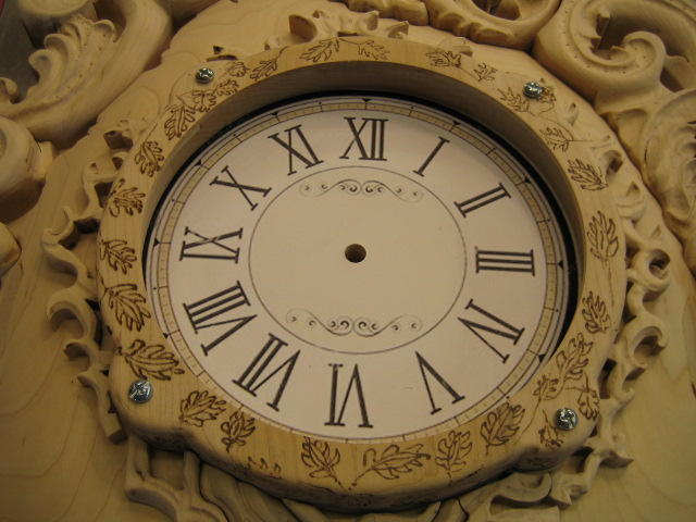

I have two layers of wood here surrounding the dial and hands..this part can't be glued down for the hands need access..         Using double sided tape I will attempt to hold the two pieces of wood ridgid on to the body so I can drill holes all the way into the body of the clock. I will thread the hole in the body of the clock with an 8-32 tap so I will drill the hole through the three pieces of wood with a # 29 drill bit, .136 and this is the size hole for an 8-32 tap. The two top pieces of wood, the housing for the glass and the 1/4" board I have for the dial will both get a larger bit so the 8-32 bolt will slide through both top pieces and the threads in the body will accept the bolt.. The larger hole for the bolts to slide through I use a # 19 which is .166IMG_0108.JPG.22895df0d7ab648c17ec5e2d0f436e8c.JPG
 I made sure the bolt will go in and out of the tapped threads, 8-32..

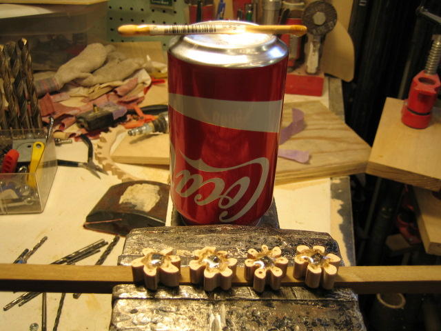

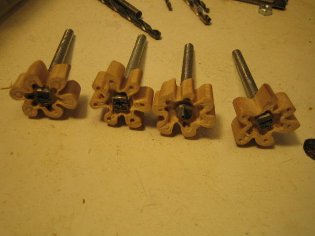

 I take the little flowers and drill a # 29 , .136 hole in each flower then run the tap, 8-32 back and forth so the threads are good and clean. I then take the four bolts and grind the heads kinda square and flat then using a very small bit on the dremel, grind out an area for the head of the bolt to fit into . the larger hole will be a # 19 or .166IMG_0109.JPG.79a8765fcb8f83fad20c773a341bc5ad.JPG
I grind the area around the bolt large enough to hold epoxy around the bolt then screw the bolt all the way into the wood flower,  then make a holder to go in the vise for the epoxy to set up for the 4 bolts, mix epoxy and place enough over each bolt and let dry.IMG_0112.JPG.8d4875a2c0ec72260f272c3328f81fa2.JPG
These coke cans are great for mixing up small amounts of epoxy.. The curved  bottom of the cans keeps me from trying to scrape up and use the part next to the can.. Important!

Its a good idea when mixing and pouring epoxy not to scrape the sides and use that also in your pour.. That part next to the mixing bowl has not been mixed as good as the part going around and around so it can effect the drying quality so always mix just a little extra so you don't have to use it all..

Clever idea using the flowers as knobs to retain the clock...

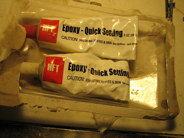

I have every brand of epoxy in my shop, expensive and cheaper.. On the five minute epoxy.IMG_0113.JPG.189f1a027291fa6dcf56a4a6ecc960bc.JPG
I end up using this. Its 50-50 mix and is the 5 minute mix to set up....3 oz each tube and is about 9 bucks. on sale cheaper.. This is about 3 years old and if I put the caps back on after use, its still good... Do make sure the caps are returned on the right tube each time or else you screwed up....Harbor Freight brand but all these years I still can't tell the difference unless I'm using bar top epoxy. And after it has set up , no one else can tell the difference either.
GO HARBOR FREIGHT!!!!

How were those leaves burned? Painstaking work. They look good.

Gene I did the leaves with the tip of my finger. Maw hooks the electricity to my rear.  From then on, there ain't no telling what I end up drawing. I once did the Gettysburg address five days before it ever happened...
