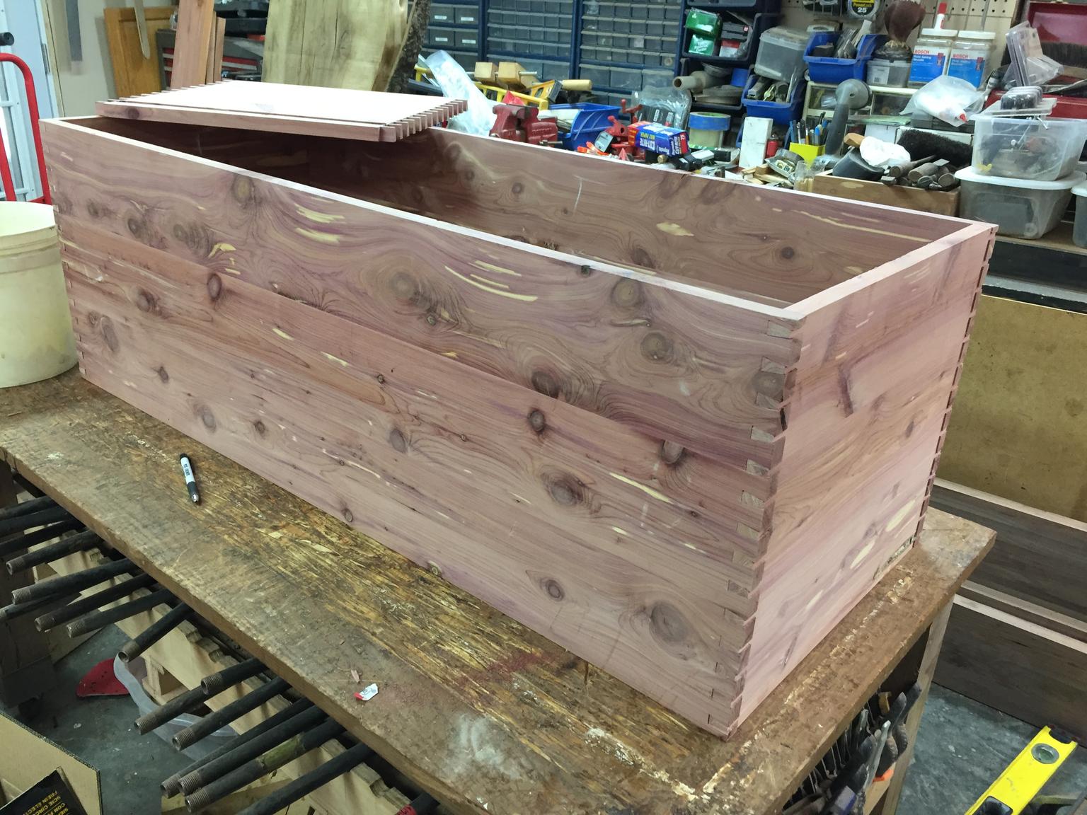

February 25, 20188 yr comment_141590 BENN WANTING ONE TO/FOR THE CORNERS OF HOPE/BLANKET/CEDAR CHEST. ANYBODY GOT ANY 1st HAND EXPERIENCE WITH THIS PROCESS? THINK I ASK THIS WHILE BACK, LOTS OF WATER UNDER THAT OLD BRIDGE SINCE. NO, AINT GONNA SELL MY PICK UP TO GET ONE, MAYBE PROMISE COOK SOMETHING. Cya Report
February 25, 20188 yr comment_141602 The biggest one I've used is the 16" Porter Cable OmniJig. Truthfully, I never got very good at using it. It took me forever to get it setup and dialed in everytime I wanted to make dovetails. I guess I just never used it enough to get good/fast at it. That said, once dialed in it made great joints. Report
February 25, 20188 yr comment_141613 They make 24" but imagne how must better his chest would be with hand cut dovetails. Report
February 25, 20188 yr comment_141615 Buck here is a link to the one I have. https://www.ptreeusa.com/rtr_jigs_dovetail_wiz.htm i have two of the 15” together and can do up to 30” dovetails. Report
February 25, 20188 yr Author comment_141618 46 minutes ago, John Moody said: Buck here is a link to the one I have. https://www.ptreeusa.com/rtr_jigs_dovetail_wiz.htm i have two of the 15” together and can do up to 30” dovetails. THANKS JOHN, LOOKS TOO COMPLICATED FER ME. Report
February 25, 20188 yr comment_141619 I don't use a normal dovetail jig but, I do use a box joint jig. I wonder if you could use the same principal. Cut the first set of dovetails then move the jig over to make the next bunch, using a dove tail key to position it. Report
February 26, 20188 yr comment_141633 3 hours ago, Gene Howe said: I don't use a normal dovetail jig but, I do use a box joint jig. I wonder if you could use the same principal. Cut the first set of dovetails then move the jig over to make the next bunch, using a dove tail key to position it. You can on the one I use. It will work for dovetails or box joints. Report
