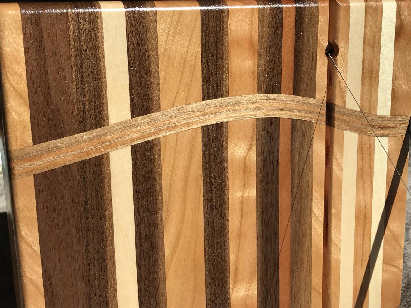

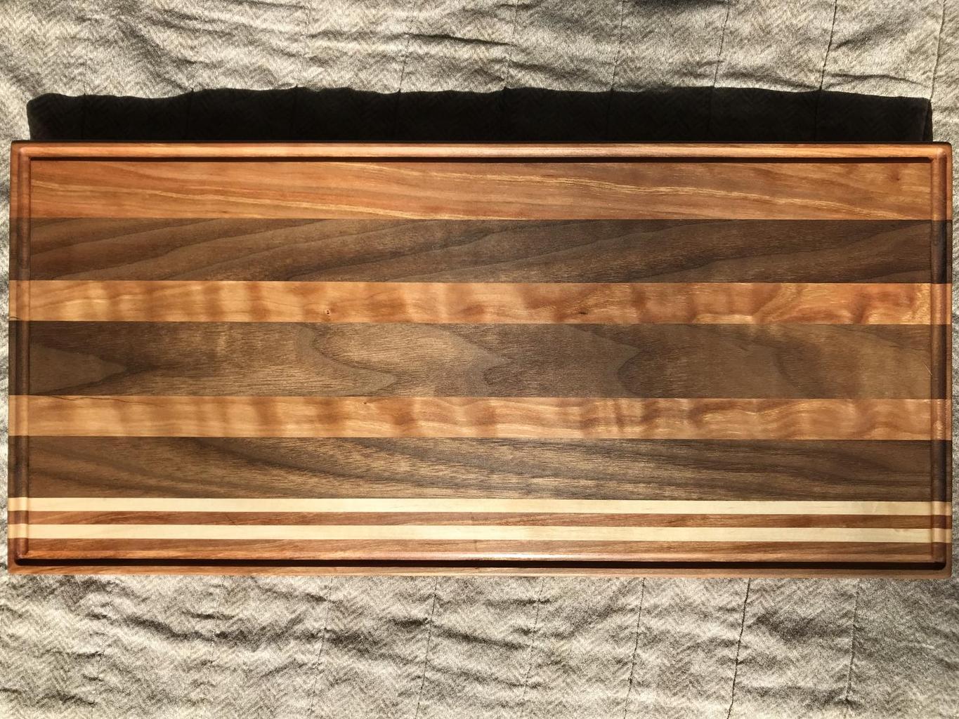

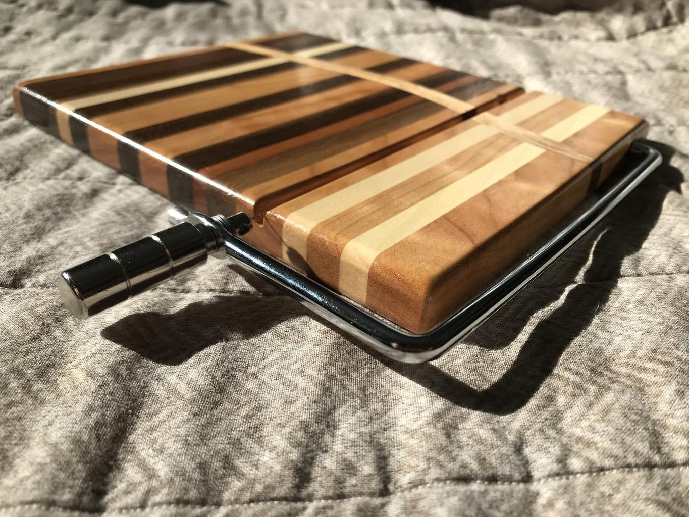

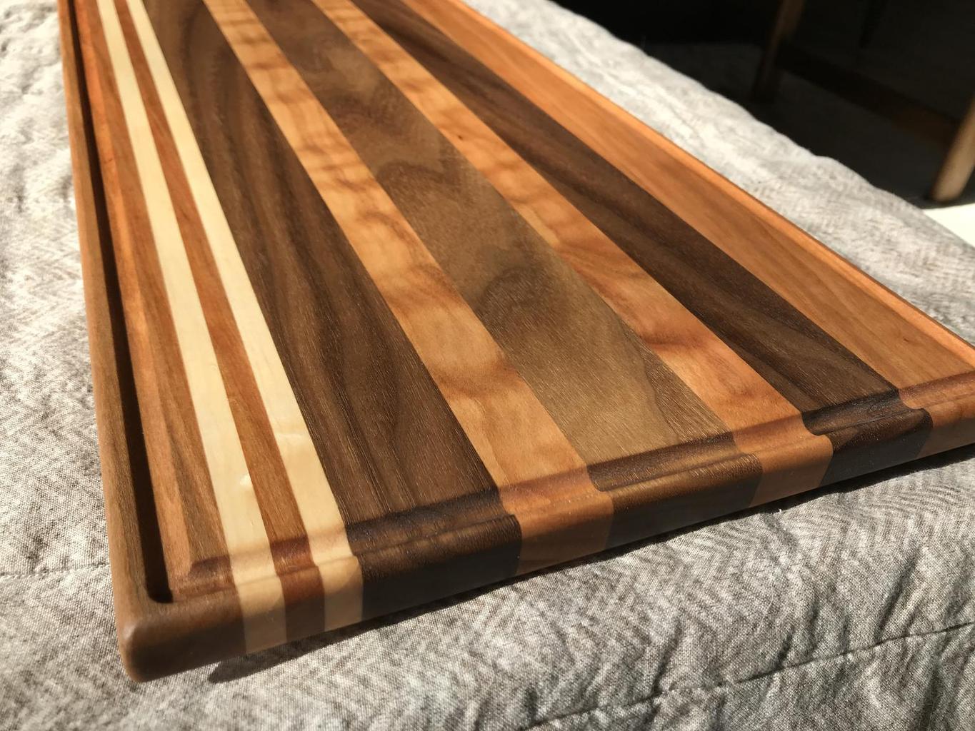

I dont turn wood at all, but was impressed with Lew's rolling pins and wanted to use the last of my curly cherry in a cool way, so I made a cutting board, and cheese slicer. I haven't done any inlays in a few years, and this reminded me why. The glue up sucks! Plus in all the mayhem of the clamps and cauls, I messed up the order of the walnut and cherry strips....buuuuuuuut, it ended up al right.
beautiful..
WOW! Those are absolutely gorgeous!  I really like the non-symmetrical wood layout. I think it really adds to the beauty of the pieces.

Lew's glue up was more or less edge to edge where yours is an edge to end glue up an you might end up  with a small problem???

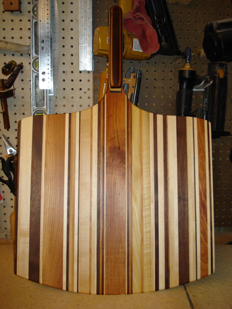

Boy, I'll say Dane! I'd say you were quite inspired!
I have made edge to side glue ups and so far they have held. This one wasn't too thick. Her name is "Emma"

Man, that's a really nice cheese slicer, Dane.
And, Lew. That's the fanciest peel I ever did see.
Nothing is wrong with yours, Lew. Its the end grain to long grain that might show later because of the expansion of the wood.
Yeah time will tell for sure. I haven’t had any separation from other pieces with inlays that are about 8 years old, but of course  all wood is different, just hope for the best as always.
I think with the thinner boards- less that an inch thick- the movement will be quite small. Plus, there is lots of surface area for bonding.
I never said the glue up sucks. I said he could have problems because gluing end grain against long grain can give problems because of the swelling of woods in different seasons. Thats why when you see a farm type table with planks glued up side by side then they add a board crossways on each end there is always a channel between the two different directions of wood so when one wood shifts more than than the other, it won't be noticeable...I didn't invent something that don't happen. Wood is wood.
Aahh, I see where you were headed now. I thought you were referring having some pieces with the flat grain up and others with the edge grain up. I have seen lots of cutting/serving boards with the inlay like Dane made. Apparently they are pretty stable.

Sorry, I meant the process sucks. I’m cool with how it turned out-and totally agree with you. Most mistakes are only noticed by the maker. That’s woodworking yo :)

While not as ever strong as edge grain to edge grain glue joints, end grain to edge grain joint strength will be substantially enhanced by sizing the end grain prior to glue up. Just a dab of glue, rubbed in to the end grain and, allowed to dry...a minute is plenty of time...will do the trick.
