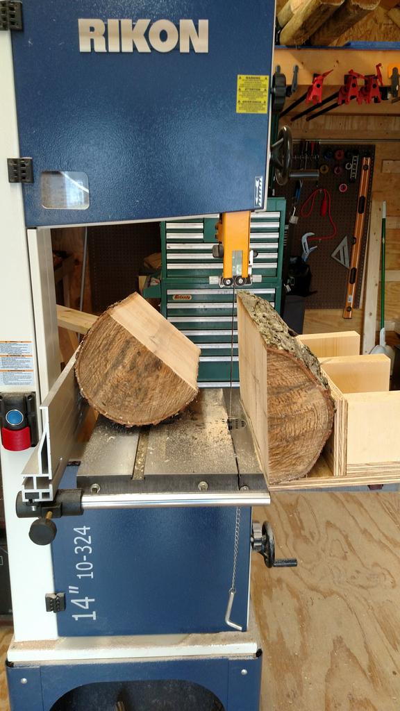

February 19, 20188 yr comment_140979 I watch a lot of turning videos on youtube. In one of Carl Jacobson videos he said he cuts the heart out of a log and paints the ends with basic paint and doesn't get any cracking. Since I got the new bandsaw I figured I would give it a try. I made a jig to hold the log and made some bowl blanks real fast and easy. They will turn a 9 inch to 10 inch bowl. Report
February 19, 20188 yr comment_140989 Looks good but know you're still on the clock. Even sealed they will still eventually split some. Steve Report
February 19, 20188 yr comment_140991 rule of thumb for air drying is 1 year for each inch of thickness. you can turn green wood to almost the size you want, and that will lessen your needed drying time, or just let them warp as they dry. that's a thing i understand. not my thing, but a thing. Report
February 20, 20188 yr comment_141003 Awesome band saw! I've been using Titebond glue instead of paint it seems to keep it from cracking a little longer. Report
February 20, 20188 yr comment_141006 That is a good looking saw right there Rusty. You should get a good deal of satisfaction from it. What kind of wood do you show up above? Report
February 20, 20188 yr comment_141021 Cutting the pith out is a standard for blank (or log) prep and there is a good possibility as Doug said that it will still crack if left for a year. Also if you continue to prep the blank by cutting it round (ready to mount) and then sealing ,might reduce the chance for cracks Report
February 20, 20188 yr Author comment_141044 11 hours ago, Cal said: That is a good looking saw right there Rusty. You should get a good deal of satisfaction from it. What kind of wood do you show up above? Not sure on the type of wood. A neighbor knows I like to woodwork and has dropped off a few small pieces a couple of times. Report
