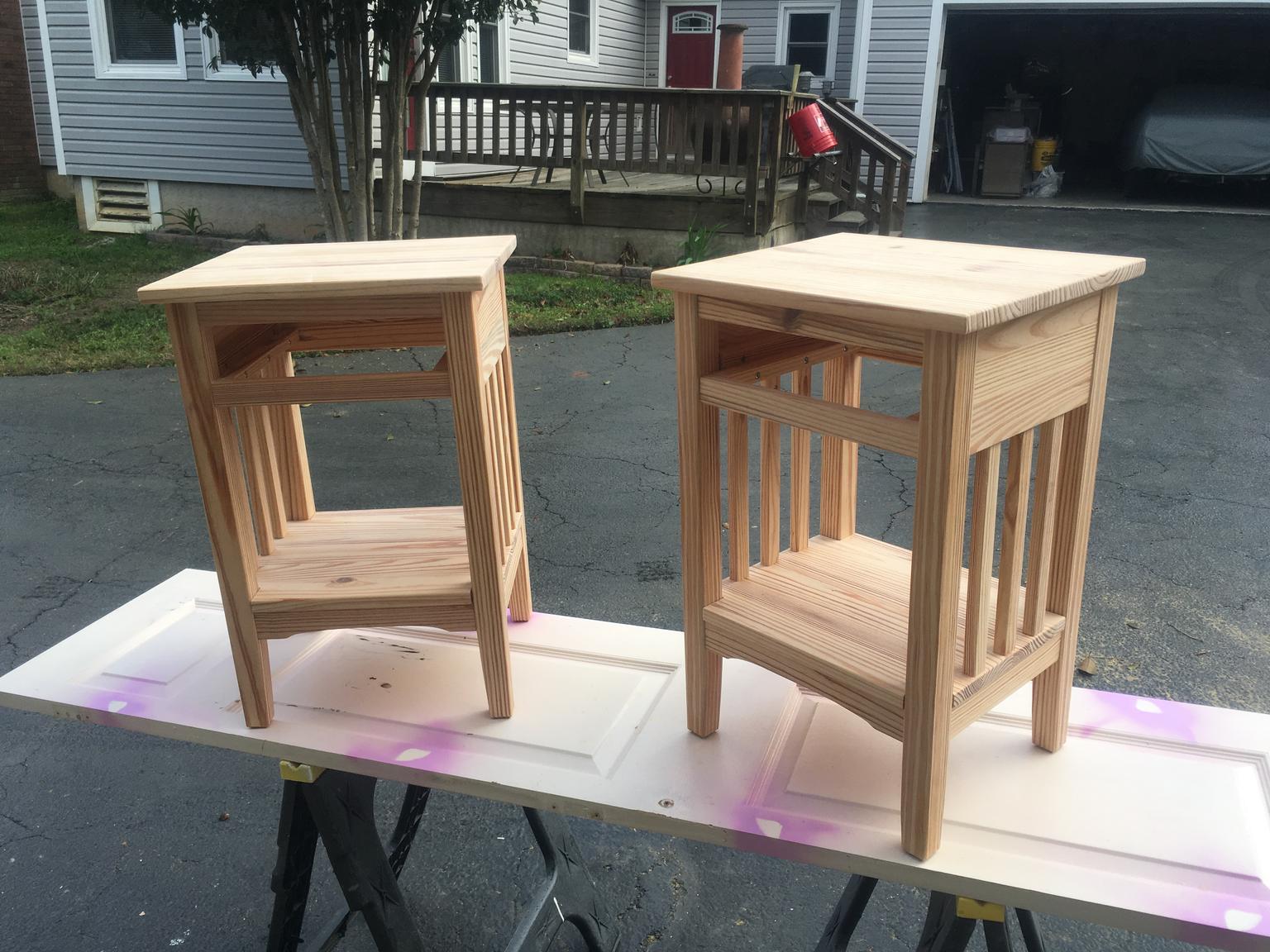

I am getting close to wrapping up a couple nightstands.  This set is made from SYP and varies in the amount of pitch content.
I am looking to get a dark expresso color on them.
What would be the best product/application technique to this?

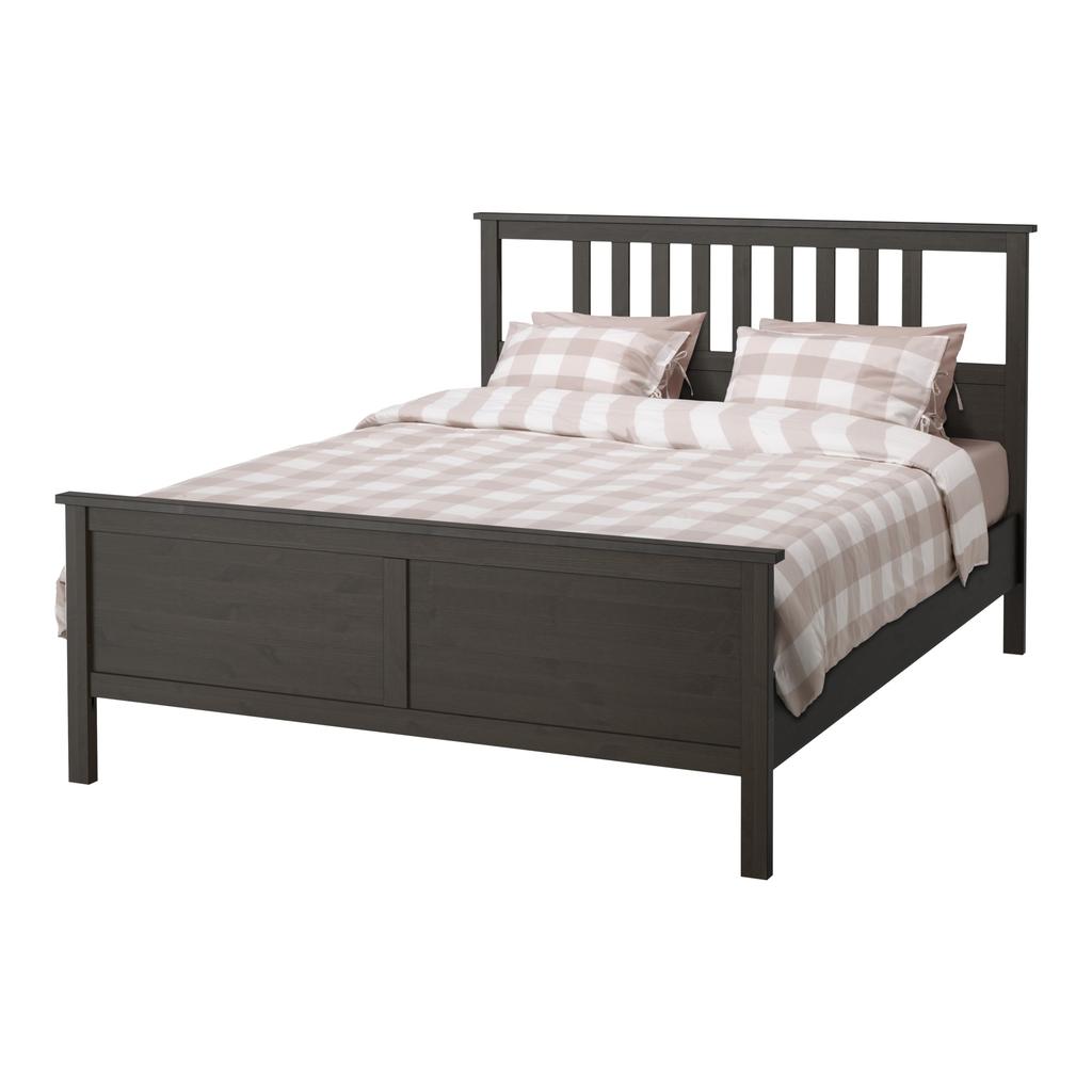

Thanks for the replies.  I had to go upstairs and take a look at the bed.  It is from Ikea, which they list as "black-brown".  It is very dark, but not black.  It is a solid, or opaque color, with no wood grain showing through.  Could this be a painted surface?
http://www.ikea.com/us/en/catalog/products/S29007850/

Most of the stuff I've seen from Ikea is a form of glued up saw dust so I would think there is no reason to stain when paint would be faster as a cover up.
I my thinking Cal just a clear finish on your night stands would be a good contrast and like you said yellow pine has the best looking grain of all the pines...
It is quite likely it is a "toner."   That is a finish that has some added dye or pigment.  Spray on one coat, wait 20 minute, possibly spray on second coat, wait 20 minutes, package it up.   It is somewhere between paint and clear finish depending on how heavy they go on the colorant.  It's used on  lot of commercial furniture, often on the cheap stuff sometimes the high end stuff.

Well, wifey made it home tonight and looked at the project.  Then she looked at a few pics I saved from Pinterest, stained pieces, painted pieces, combos and everything in between.  At this point, the lower part will be painted white.  By next weekend we will decide what to do with the tops.
At least I can motor forward now with this set.
Thanks again for all the tips and suggestions.
Those look really nice Cal, there is a lot of work in those. Good job.Never find anything that good at Ikea.
Herb
Very nice Cal. I really like the design/look of these.
Some really nice looking SYP too...just don't seem to see that quality of it up here anymore.
Boy, I can smell the dust...SYP has such a pleasing aroma.
Nice work Cal.  Those look great.
