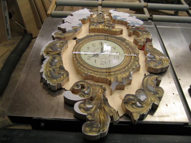

Cutting the slots with the biscuit machine and I had forgot to reset the depth for it was set for # 10 biscuits and I had run out and only had #20 in the shop...got to the lumber yard right at closing time and stuck my foot in the door as he was locking up and told him I ain't leaving cause you got most of my shoe on your side so sell me some biscuits and I will take both shoes and go home... I had already put glue in nine slots and tried my best to squeeze some # 20 ies in a # 10 hole and that just don't work too good. I did manage to find 9 biscuits for the two pieces I already had glue spread everywhere and for sure didn't want to ruin two 36" pieces of maple.......    I usually dry fit those things cause some brands ain't worth a flip but was in a hurry cause maw was telling me to come eat or else she was gonna throw it away....
   Anyway I got the 4 pieces glued up with 27 biscuits and this morning finished smoothing them and got the pattern on and by dark tonight I had all the pieces cut out...
   .Hardest, lop sided, partially not all there but I did manage to add lib I guess thats the word for it and all the white area was not part of the original pattern when I started laying it out....I don't have a clue as to how it will turn out but I cut it up in to about 12 pieces for it makes it easier  to hold on to while the dremel  is doing its thing...IMG_0010.JPG.2dee24b6ea9917832cf7786e1fb45b90.JPGimageproxy.php?img=&key=3c03e03cfca50bb9
It was way too big for the scroll saw so the jig saw got a working out. Hardest work I have done in a long time for maple is awfully heavy.
  I set that clock dial up there to convince myself I can correct what the original photo made it look like..

Turning it around from the original picture makes a better looking piece, IMHO.

Gene I think you tried to post an upside down shot of the clock picture . I didn't get any picture just  hen pecking things. So think for giving a shot anyway. No I will go out and turn the clock around and see. Hey maybe even turn one sideways to hang on the wall. but my wall are lacking space to hang anything.

   Gene, you are right. I just went out and turned the clock around and I think it does look better.. But after I pull the pattern off things might be different.
 There are still lots of light grey areas which means these were areas cut out and not used in the original pattern..these are what I will be doing away with next....before I pull the pattern.
The white areas are what I added to be turned into curly cues where there was too much areas that needed something to complete the looks of a completed clock...
  After I pull off the pattern I will add more wood to the top in different areas  for more wild swings of a leaf and add a few flowers here and there which I don't think there are any at all.... Way back when I don't think clocks had flowers, must have been something signifying feminine touches which the mighty man  wanted to keep separated....

Patch - the clock is moving along quite nicely.  It's great to see a master craftsman's work in progress.  Thanks
