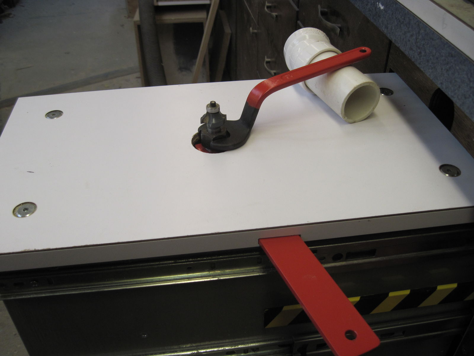

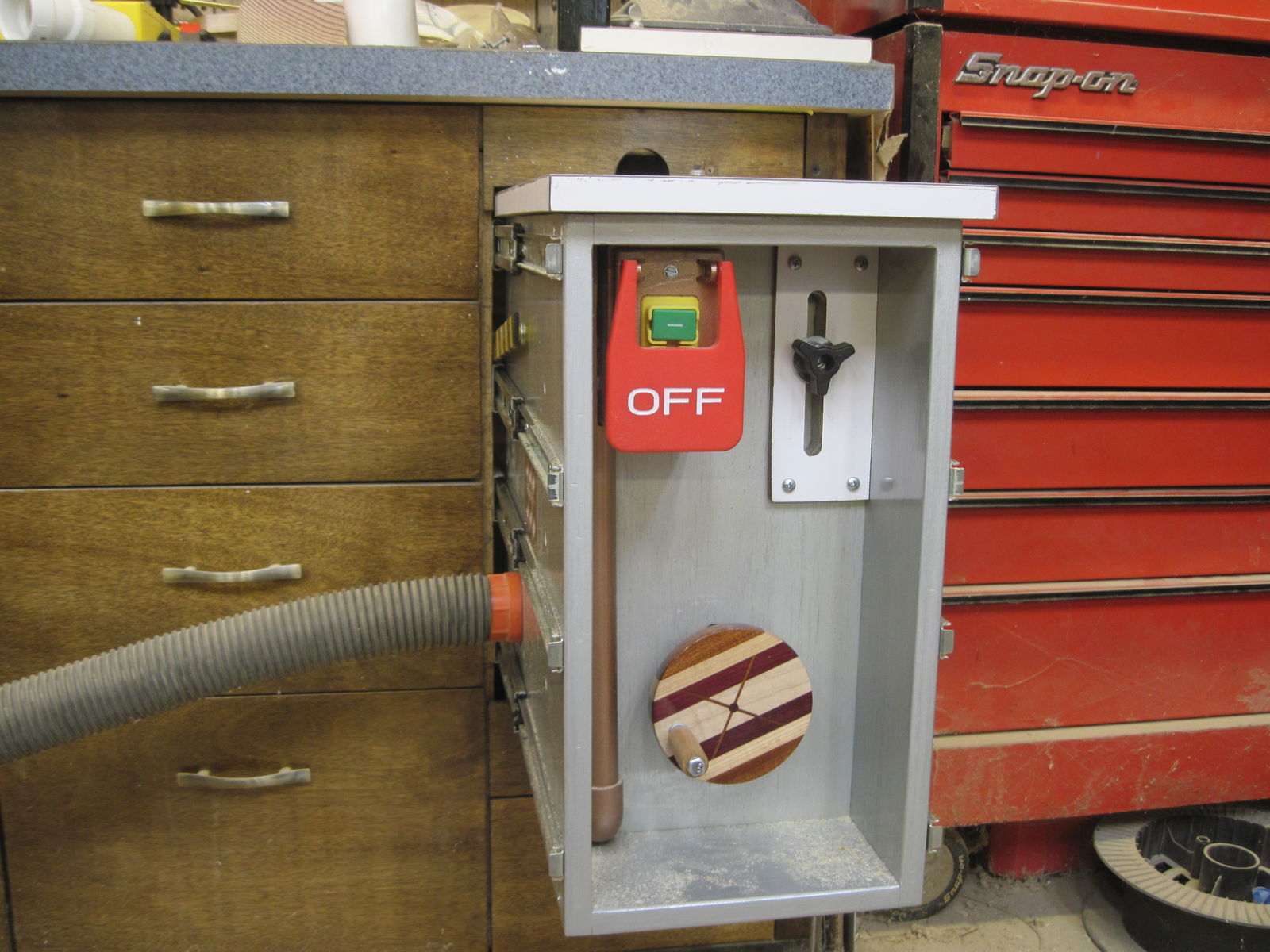

October 22, 20197 yr comment_206084 I have the router raizer brand. Has worked well for 20 years. But recently made my own life. Search for mini router table on the site. Should pull up the project in progress build. Report

October 23, 20197 yr comment_206135 6 hours ago, Dadio said: An added thought is now with the emphasis on dust collection by enclosing the router, it will be harder to do adjustments under the table. Home made lift, has above the table bit changes, and adjustment wheel in the front with a lock. No need to bend over and has DC. Thanks to all who gave advice along the way. Report
