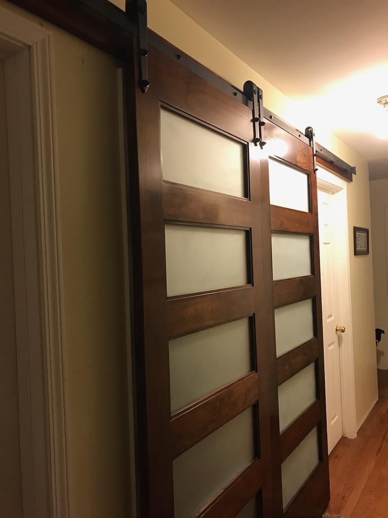

January 25, 20188 yr comment_138272 The doors are finished but the manufactured put plastic over the smooth side not the frosted side. There are some very minor blobs of stain, shellac and ploy. Also my spouse who was scraping them down has removed the frosting on a few panes. I would like to use a solvent or stripper that will not hurt the glass but will remove the finish. Can you please list the proper solvent or stripper to destroy shellac, stain and water based poly. Also I hear you can resand the glass to get the frosting back. Any idea what grit and how do you get a uniform roughened finish. I will try to upload pictures tonight. Report

January 29, 20188 yr Author comment_138729 We decided to spray more frosting on the glass. Taped everything else off and except where I paused a little long it did a great cover up job. Then the second coat erased the first coats mistakes. Thanks for all your help. Report
February 19, 20188 yr Author comment_140947 Pictures as requested. More direct light shows inconsistent frosting. Report
