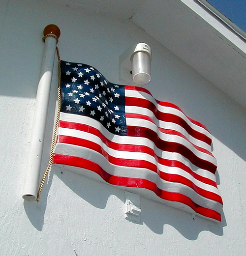

Beautiful piece, you should make a flag in the wind.
