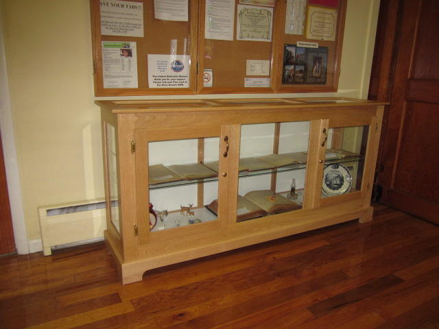

I built a display cabinet for the church to store some historical items from a 92 year old member. (photos in a week or two)  I had to install glass on-site because of transportation issues.   I got it there, set it up and drat, the floor was not level and the bulletin board it was to sit in front of and under has three doors and one of them would not open without hitting the top.  I removed the nail-on felt feet, but that was not enough.   Because it sits in front of a hot-water baseboard heater, I needed to allow for airflow around and under it.  So it has a cut-out on the base moldings.
To save the day, I decided it would work if I sawed some off the bottom of the base moldings and internal frame.   At first, I grabbed my pull saw and proceeded to use a spacer block like I've done many times to shorten barstools that were too tall.   Taking a long time.   Then I remembered that I'd put my infrequently-used Fein OMT in the van.   Got it out and it did a fine job on two of the corners and the finished the two I'd started.  Day saved.

Big unveiling in church this morning.    Not looking for attention, but got lots of kudos.
You can now see why the left side door on the bulletin board wouldn't open before I lowered the cabinet a bit.
And those Kudos were well deserved.  Nicely done!

Very nice cabinet. Providing for all that glass would be challenging for me.
This is the first time I've done anything with that much glass.   I've done a lot of picture frames, but that uses single-strength glass (2.5 mm ~ 0.1") that I cut myself.  Because it's in the open and kids will be around and some day someone's going to put a big box on the top, I went with 1/4" tempered glass.   The glass company came through pretty close on specs.   I built it first, then used the as-build dimensions for the cut list.    The secret is to make the cut size 1/8" less in both dimension to allow for wood movement, out of square, or any warpage.
Oh, and the other thing I did was anchor it to the wall for anti-tip-over.   Since it has to sit about 6" from the wall due to baseboard heater, it has a nylon strap screwed to wall and back frame.
