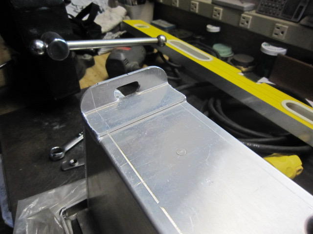

December 18, 20178 yr comment_134397 Recently I just put up a LED light in my garage / shop. When I bought the light it did not come with any mounting hardware and I wanted to hang it from the ceiling with a chain. The light has some mounting tabs on the side, but the challenge is that they have slots instead of just a round hole in them. And the bottom on the slot is flush with the top of the fixture. My solution to it was to use a 3/8” weld tab nut. Report

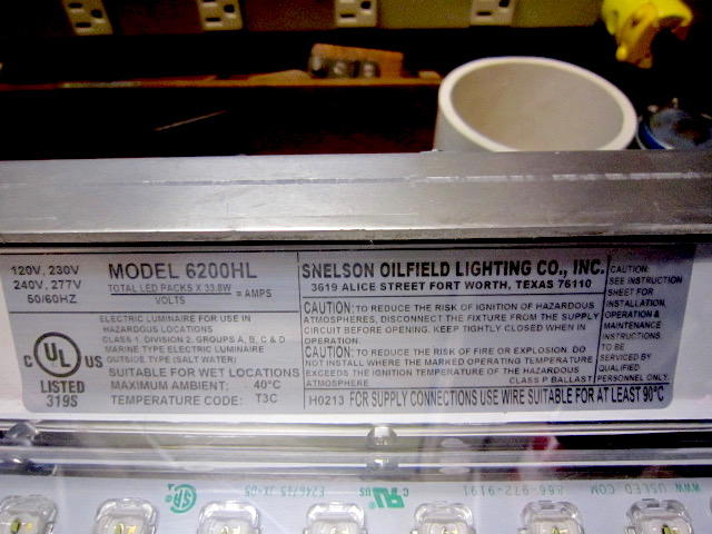

December 18, 20178 yr comment_134402 Good thinking, but Man! that is one robust looking light fixture....is that box welded?? Report
December 18, 20178 yr Author comment_134412 Thankyou Fred. Yes, the fixture housing is welded aluminum. It is made for hazardous and wet locations. Edited December 18, 20178 yr by CharlieL Report
December 18, 20178 yr comment_134424 Excellent choice...WOW...can a light fixture get any more massive...? Report
December 18, 20178 yr comment_134436 That is not a light fixture. And, those are not wimpy chains, neither. Report
December 18, 20178 yr Author comment_134437 2 hours ago, Nickp said: Excellent choice...WOW...can a light fixture get any more massive...? It's really not all that massive. It's only a little less then 2 ft wide. But yes, it is built well. http://thepatriotwoodworker.com/topic/21388-led-light/?tab=comments#comment-134289 Report
December 20, 20178 yr Author comment_134582 Well anyway, I guess that I brought the subject up about the weld tab nut for those that may not know of such a nut. They have come in very handy for me in several situations where a simple nut isn't the best answer. Edited December 20, 20178 yr by CharlieL Report
