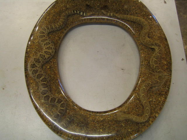

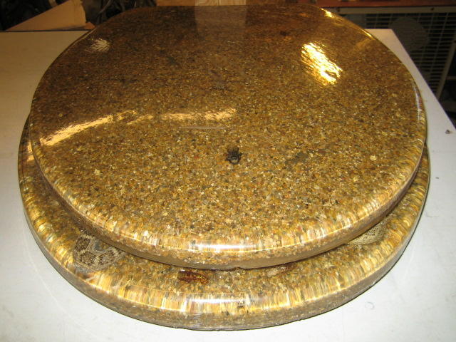

December 10, 20178 yr Popular Post comment_133842 Lew you might do what I did years ago. I was selling Mac Tools at the time and I knew this certain mechanic had a mold for a toilet lid and seat that he would make epoxy sets and sell with flowers and money and lots of things inside the epoxy as a conversation piece....As I was calling on the Buick house where he worked I ask him one day could he make a seat for me, sure, what do you want in it... A couple of rattle snakes, grass burrs, spiders and all kinds of things. He said you are in luck for my wife can go out and catch some rattle snakes and I'll let you know when we have finished. Even back then I was expecting 200 bucks especially after seeing what they had made me...or at least close to that amount. ...What I said and the way I said it as if the price was too much, he stepped back and he him hawed around and said now Jess I don't ever argue price with you when I am buying tools from you. I have never tried to get you to come down on your prices and I thought 60 bucks was a good price to start with. And besides my wife spent some time out there trying to get the exact length snakes and kept looking till she found two perfect specimens. I gave him 120 and said split it with your wife right down the middle, 20 for you and 100 for your wife since she did most of the hard work!! They were in the sixties at the time and super nice folks and was around 1970 Then after my grand kids got old enough to set on the pot by themselves they would scream when they had to sit on the snake seat so I had to put the original one back on and stored it up on a shelf in my shop. Slamming the door made the toilet seat inch toward the edge and finally fell off and cracked when it hit the floor....This happened over 50 years ago and ever since then I been gonna fix the crack and put it back on but just been too busy. Just think, you will be to only house in Arizona with a snake seat! Edited December 10, 20178 yr by Smallpatch Report

December 12, 20178 yr comment_133950 That is what the snake seat was made with. 2 part epoxy and you should only pour about 1/8" thickness or less at a time till that sets up then pour again. Epoxy should only be mixed and poured when its around 75 degrees. This handle dipped in epoxy about 3 years ago and wife puts it in the dishwasher and looks like the day I did it. This came from Hobby Lobby but probably cheaper at Walmart. Handles don't come out flat but is smooth. It needs to be poured on flat a surface. You need to google it if you intend on trying it. Report
