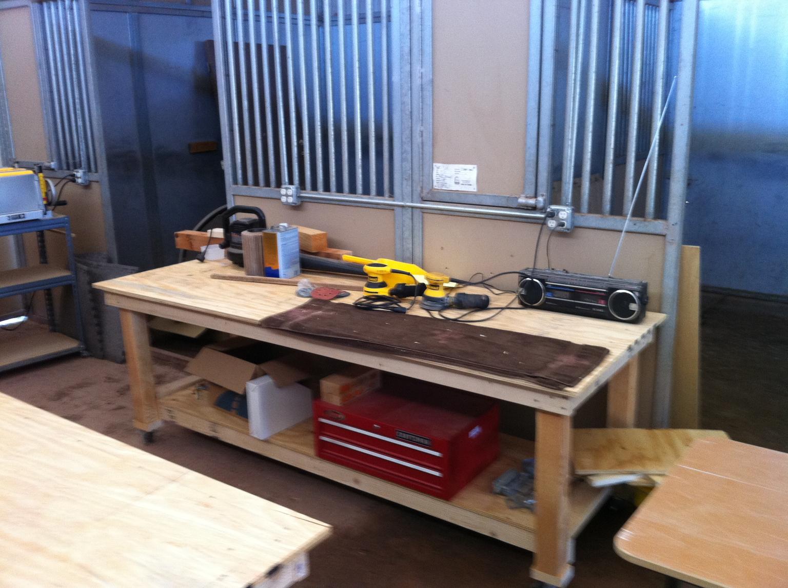

pic of my bench, on wheels for moving.
this is in my old shop (old horse barn).  about 3/4" lower than the table saw height.  built several of these, can also use for in feed and out feed of the TS.
36x96
36x96
Photo is a little fuzzy, what did you use for legs & top?
top is 3/4" ply, CDX i believe (it's been several years since i made these), legs are 4x4s, with swivel casters on the bottom (2 locking, 2 non-locking).
very sturdy, but light enough to be tipped over after assembly or put into the back of a truck for transport.
top is supported by 2x4s on edge, as is the bottom shelf.
