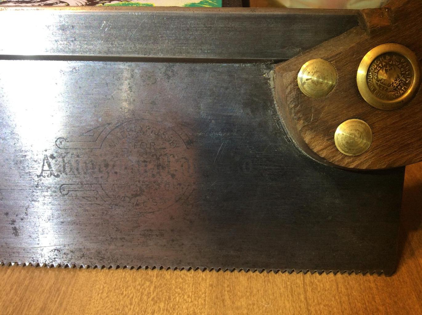

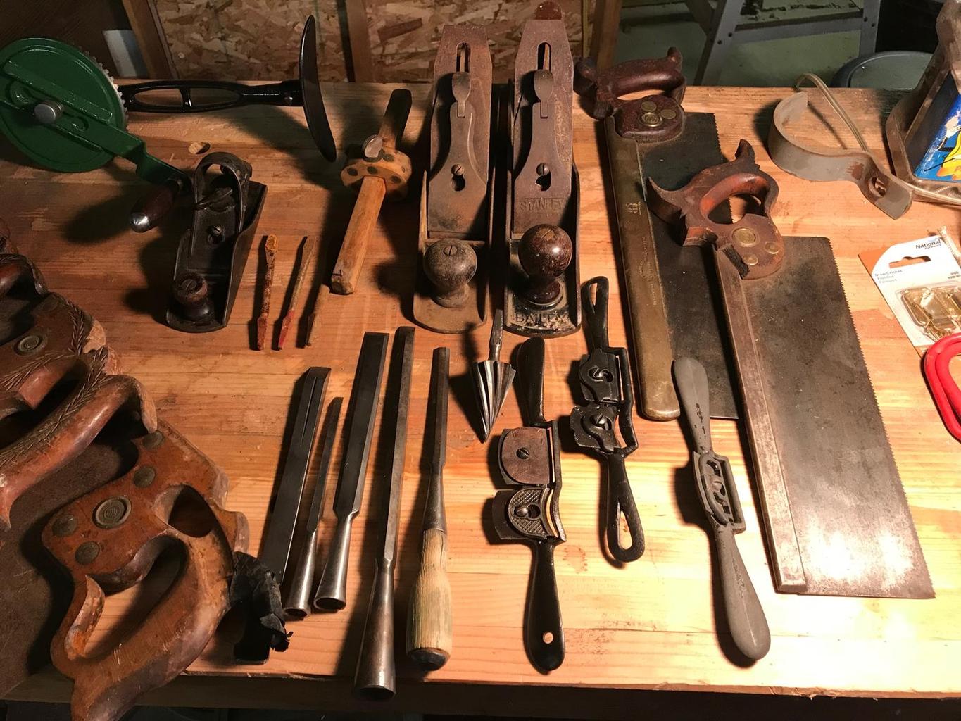

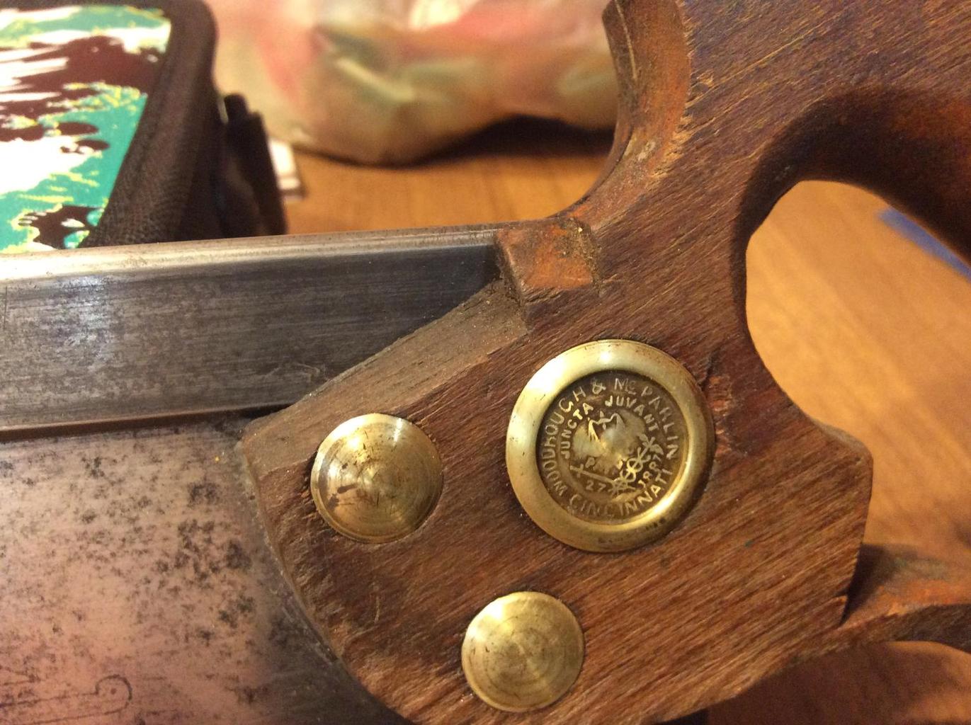

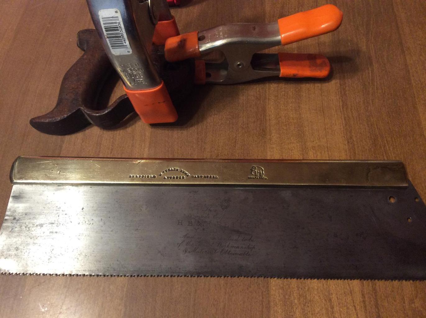

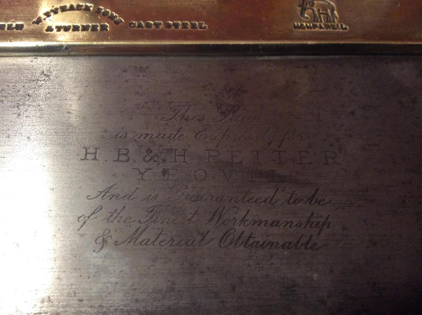

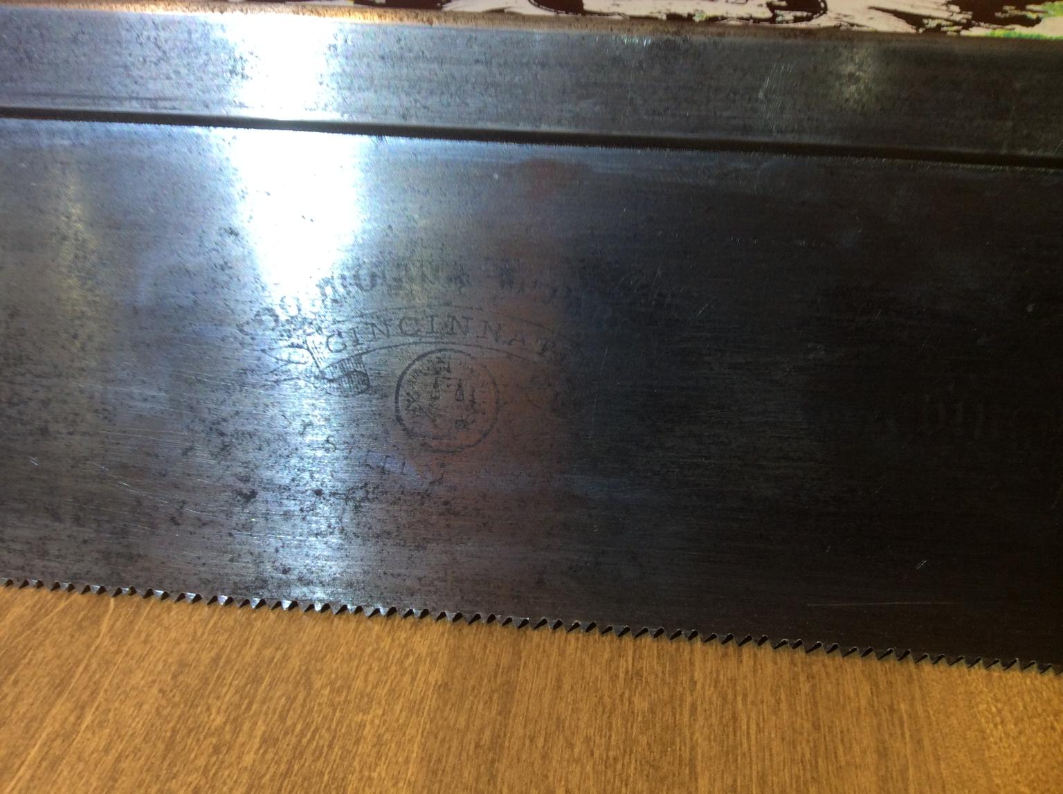

November 14, 20179 yr Popular Post comment_131286 Out this fall for the Spoon River Drive and happened upon a garage sale where I found these! One is an early W. Tyzack and sons and Turner brass back Nonpareil with split nuts. One split nut was changed out for a later medallion and round head saw bolt but I have some spare split nuts so should be able to put it right. It is the heaviest backsaw I have ever seen and It has an etch for the English company “H B & H Petter” for which I have only found limited historical information online. The other one is a Woodrough and McParlin with 2 etches, one being the Woodrough etch and the other an Abingdon ??? Etch that is not completely legible. The handles on both of these saws are Beech and are still in need of a little work as can be seen in the pictures but are very salvageable. The plates are in excellent condition overall and I intend to bring them back into service. This is my first brass backed saw and I have been looking for one for awhile. I just think that they are pretty. What can I say? The pair set me back a whole 10 spot. I have inclded a before with some other fall tool finds and some afters as well. The plates only needed a light rub with 400 wet dry and some simple green foolowed by a quick waxing. The brass was taken to the buffer. Handles will get a scrub and BLO. The W&M saw should really have a missing piece repaired first. Report
November 14, 20179 yr comment_131309 Awesome finds...the brass ribbed back saw is beautiful. Nice score on a variety of chisels too. I hope you have some of that hickory left. Appears the marking gauge have brass inserts also? Report
November 14, 20179 yr comment_131316 9 hours ago, Bundoman said: the English company “H B & H Petter” Had to look. Thought it matched the initials in this months what's it. Report
