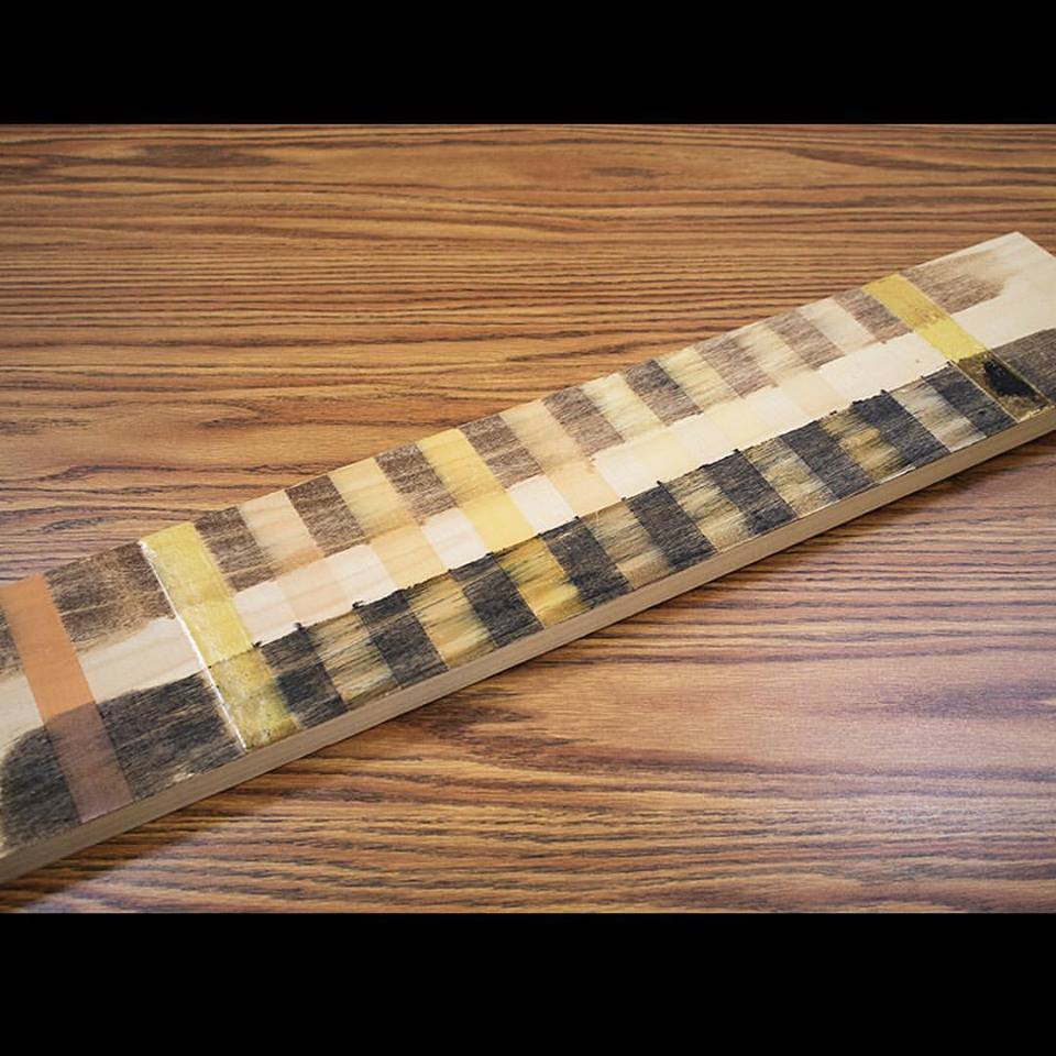

November 8, 20179 yr comment_130610 in a word, no. Titebond lab tested 11 glues, including 6 of theirs (stripes) and tried to stain them. F.a.i.l. So when you're gluing up, don't be sloppy (and don't be like Norm and have streams of glue running down a edge-to-edge joint. If you wet the surface with water or mineral spirits, glue boo-boos (or should I say glue-boos) can show up before you stain. Report

November 9, 20179 yr comment_130669 14 hours ago, lew said: No matter how careful I am. Check and double check. I always miss a glue spot. Gggrrrrrr. Lew, if you wipe the wood with a cloth dampened with MS, it will show the glue spots...as well as preview the finish. From what I've read, Norm actually is a carpenter that became a woodworker when Morash saw his scrap pile was smaller than the other carpenters working on his house. No doubt he did a lot of things many (most) of us didn't like... but I still think he was far better than Scott Phillips.....another guy who uses the word "perfect" more than needed. Report
November 9, 20179 yr comment_130682 15 hours ago, kmealy said: in a word, no. have you tried adding the stain pigment or dye to the glue?? Report
