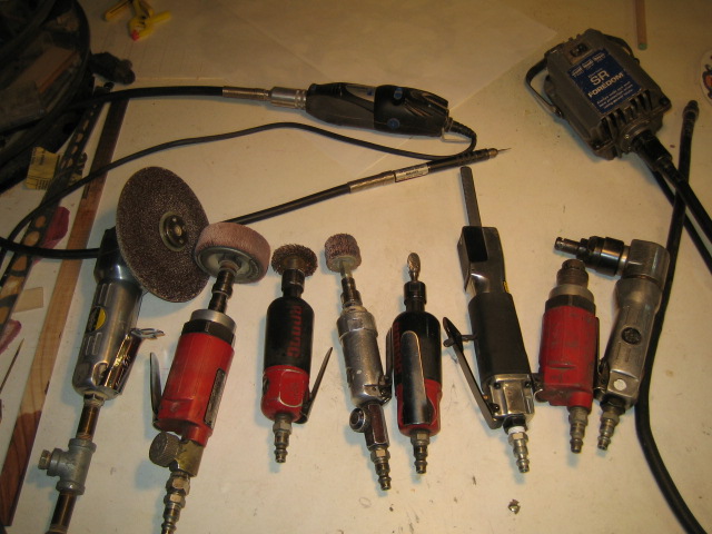

November 6, 20179 yr comment_130400 Some of the things I used on one jobber. My knuckles says thanks.. The smallest collet I have for the Foredom is a 1/4" so I don't use it too much. Report
November 6, 20179 yr comment_130410 Some serious die-grinders ya' have there Patch. I'd need a MUCH bigger compressor and probably a surge tank too. You do wear hearing protection don't you?...those air motors are screamers. Report
November 7, 20179 yr comment_130458 9 hours ago, Grandpadave52 said: those air motors are screamers. But they run cool. There are electric tools like that but they are heavier and run much hotter requiring stopping to let them cool. Report

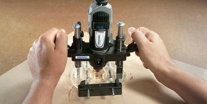

October 26, 20197 yr Author comment_206491 So Dewalt is written on the other side of the Dremel tool. Good idea for it should fool some of the folks some of the times but not all the folks all the time. Report
October 27, 20197 yr comment_206560 That is a cute little Dremel. Nothing like a miniature router. Thanks, Gene and Patch for your responses. Since the tank is pitting, I was concerned that it may fail if the corrosion inside and outside happen to be in the same place of the tank. I'll catch another on sale and put this one by the street. Someone will pick it up. It works great, especially for tires (car, bikes, wheelbarrow, dolly) and blowing sanding dust from my Shopsmith. It has been very handy and it is about 20 years old. Now, I get to upgrade. Report
