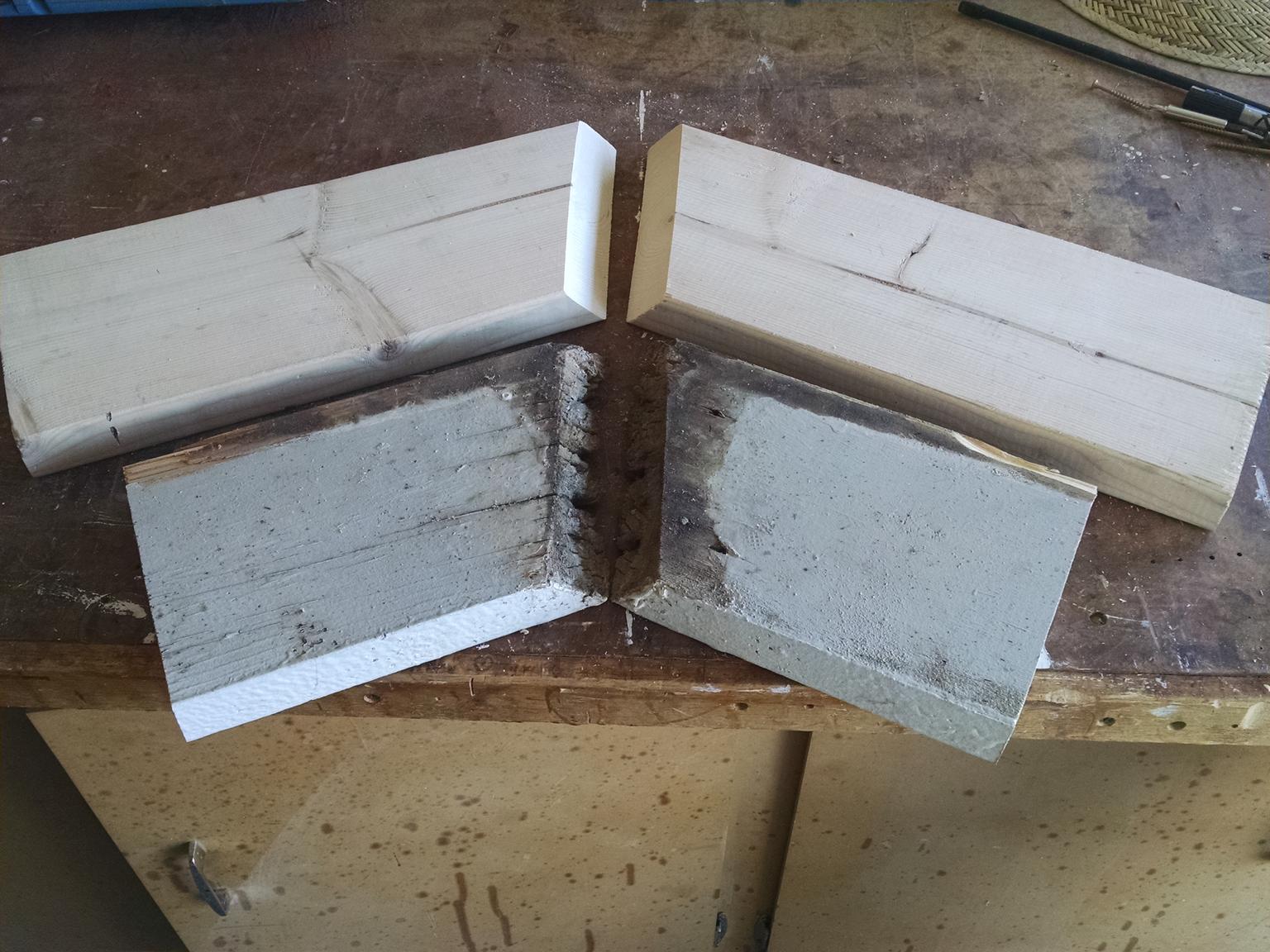

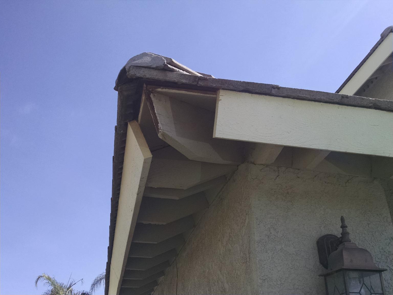

October 7, 20179 yr comment_127326 For the life of me I cannot duplicate this angle. Compound angle, at facia corner. I have the two dry rotted pieces to go off of, but I just can't get it right. Can someone please teach me how to arrive at the proper compound angle for this? Thanks Report
October 7, 20179 yr comment_127328 Can you use the rotted boards to set your miter saw? Just rub the blade against the cut, adjust until it's the same angle. Otherwise it's 2 measurements with a protractor (a digital one would make this easy). Report
October 7, 20179 yr Author comment_127329 7 minutes ago, Fred W. Hargis Jr said: Can you use the rotted boards to set your miter saw? Just rub the blade against the cut, adjust until it's the same angle. Otherwise it's 2 measurements with a protractor (a digital one would make this easy). I did that Fred, that was my first go too, don't have a protractor at all. Report
October 7, 20179 yr Author comment_127331 Got it! https://www.blocklayer.com/roof/squaretailfascia.aspx I just plugged in 5:12 and it gave me all the dope. Report
October 7, 20179 yr Author comment_127336 Ya, it got me closer, but not right on. But close enough I made it work. Nothing a little painters caulk can't cover up. Report

October 8, 20179 yr comment_127427 16 hours ago, John Morris said: Ya, it got me closer, but not right on. But close enough I made it work. Nothing a little painters caulk can't cover up. Is your blade square or is the angle scale off? Report
October 8, 20179 yr Author comment_127439 45 minutes ago, schnewj said: Is your blade square or is the angle scale off? Heck it could be Bill, I have abused the heck out of that saw the last couple months, I had not thought of that. I'll have to check it, thanks! Report
