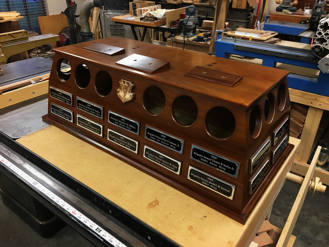

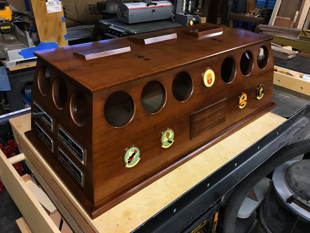

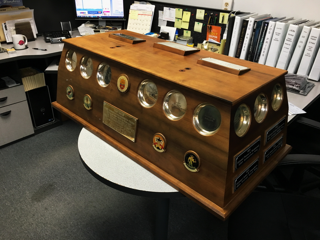

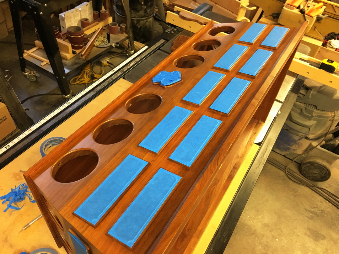

September 1, 20179 yr Popular Post comment_123068 I don't do much of this but I was asked to take this Walnut base, made in the 40's and an heirloom from BAFB, and freshen up the finish to make it closer to the original Walnut color. It had faded quite a bit from sun and room light. They asked me to strip it but I refused because of the mess involved and I truly don't want to be doing any stripping. Besides, there was no way I could guarantee the safety of the precious original medallions because they can't be removed. Those that were removable have been added through the years but the original ones were firmly glued in place. We discussed using heat but some of the medallions looked like heat would be detrimental to their already delicate condition. So I masked everything off, dry sanded it with 220, cleaned with Naphtha, and then dusted one light coat of Nitrocellulose sanding sealer. I gave that an hour and then lightly scuffed it with 220 again to make certain it bonded ok. Once I knew that worked then I shot one wet coat of sealer and sanded it again. Then one light coat of gloss lacquer followed by toning with Mohawk Perfect Brown Ultra Penetrating Stain. When the color looked right I followed that with one coat of gloss followed by sanding a few hours later. After that I shot a final wet coat of gloss and let it set overnight. I think it came out nice and they really liked it when they picked it up today. I'll try to get a photo with all the medallions in place before it goes back to Barksdale. Before - Masking off - After - Enjoy! David Report

September 1, 20179 yr Author comment_123080 Thanks, Guys! I just realized that I said I used Perfect Brown but what I actually used is Van Dyke Brown (slightly more red than Perfect Brown). David Report

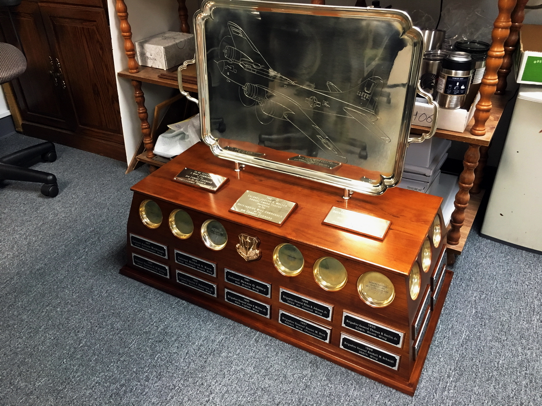

September 11, 20179 yr Author Popular Post comment_124287 Today I saw the assembled piece with all awards mounted so here's a photo of that (the lighting is a little different than my shop but it still looks nice). David Report
September 13, 20179 yr comment_124491 Not quite sure what you did here. Did you add the stain to lacquer to make a toner or did you use it as a glaze between coats of finish, or use the sanding sealer as a wash-coat? Good results in any case. Report
September 14, 20179 yr Author comment_124520 Yes sir, added translucent toner to the lacquer and misted it on. When I reached the desired color I shot clear a couple of coats of clear lacquer. No glaze involved at all. David Report
