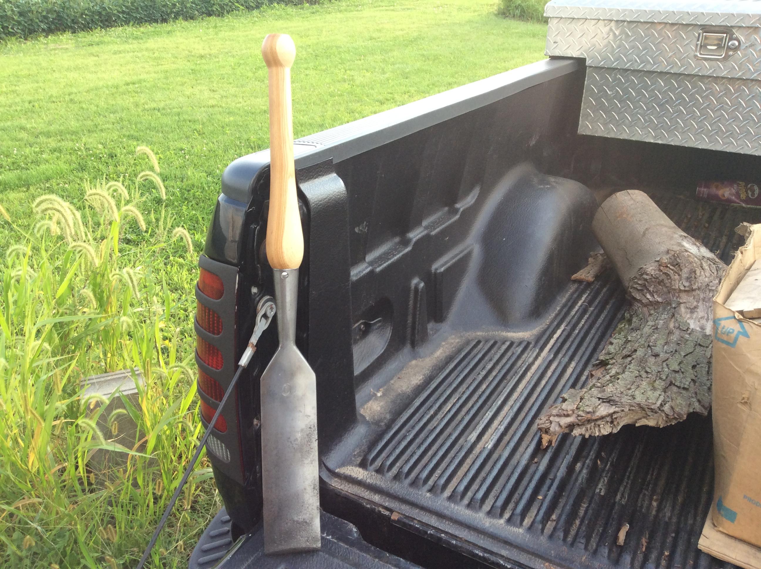

I have not found a good excuse why I had to have a timber framing slick but this has been on my want list for awhile.  I always liked the look and styling of them.  I just kept thinking that I would find one for less than collector price and last weekend one finally appeared.  It was a little rough and rusty and had no handle but DR Barton for a ten spot so I took it home! Unfortunately, I forgot a before picture of this one so you will have to live with after only shots.

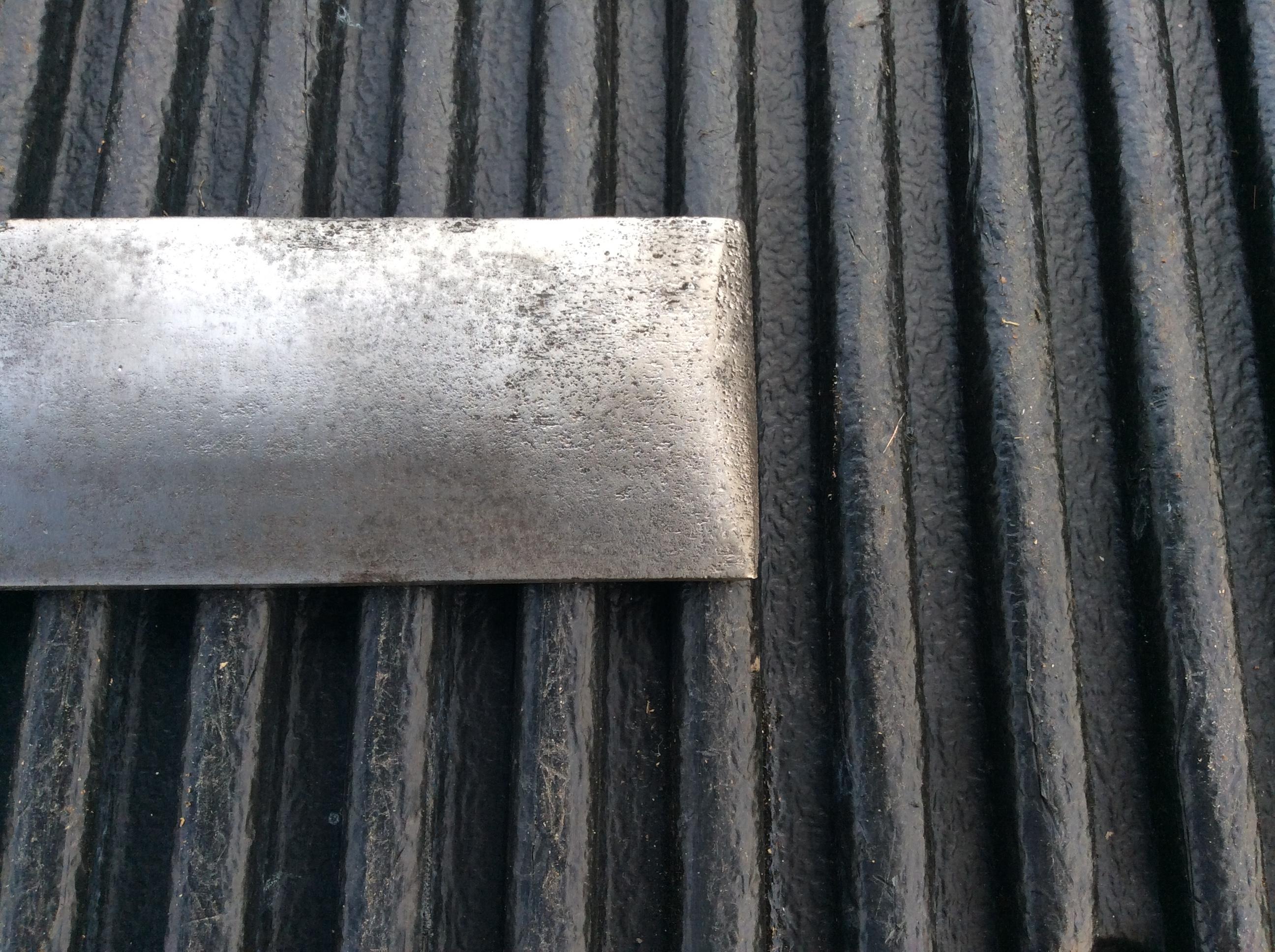

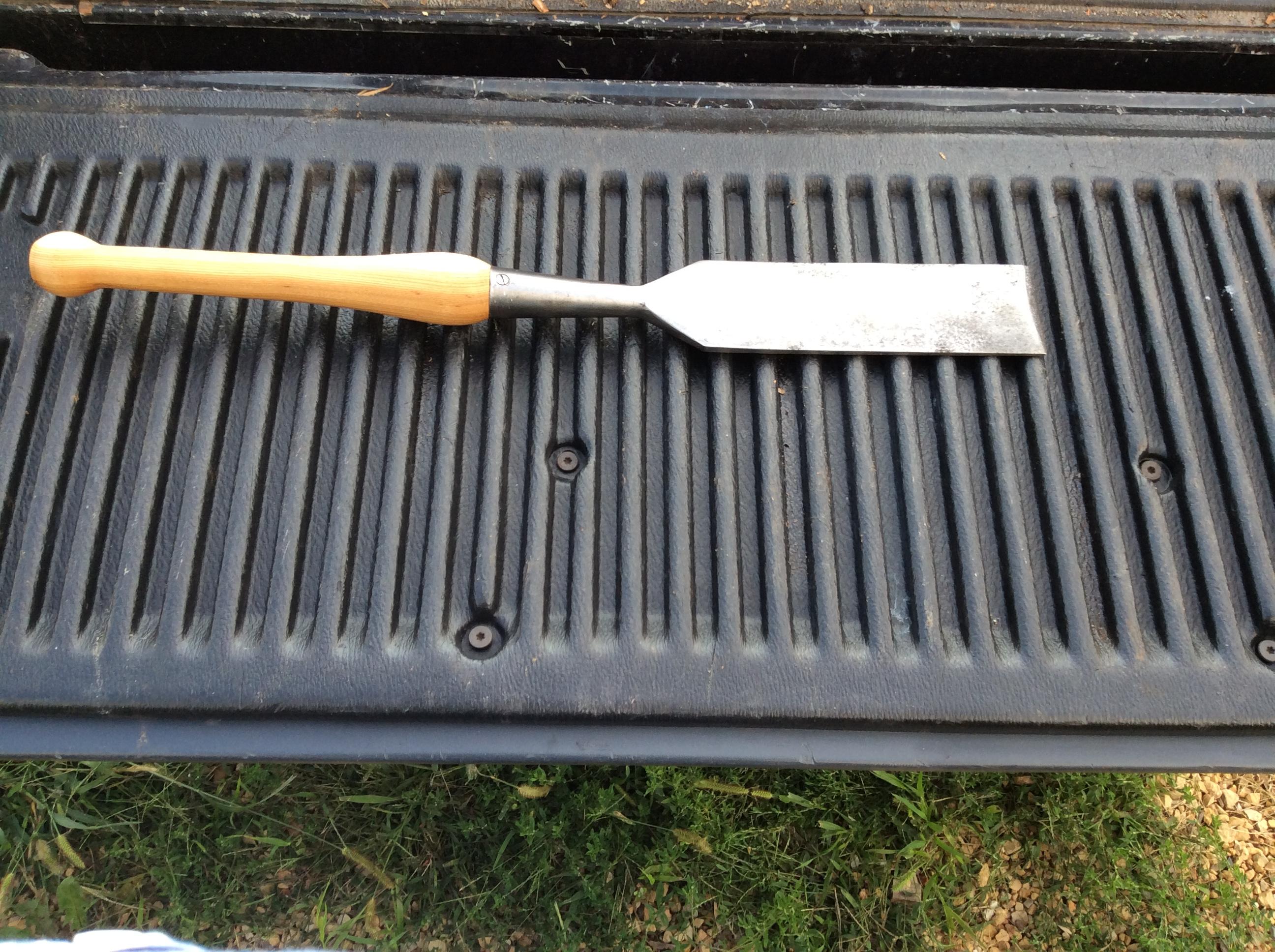

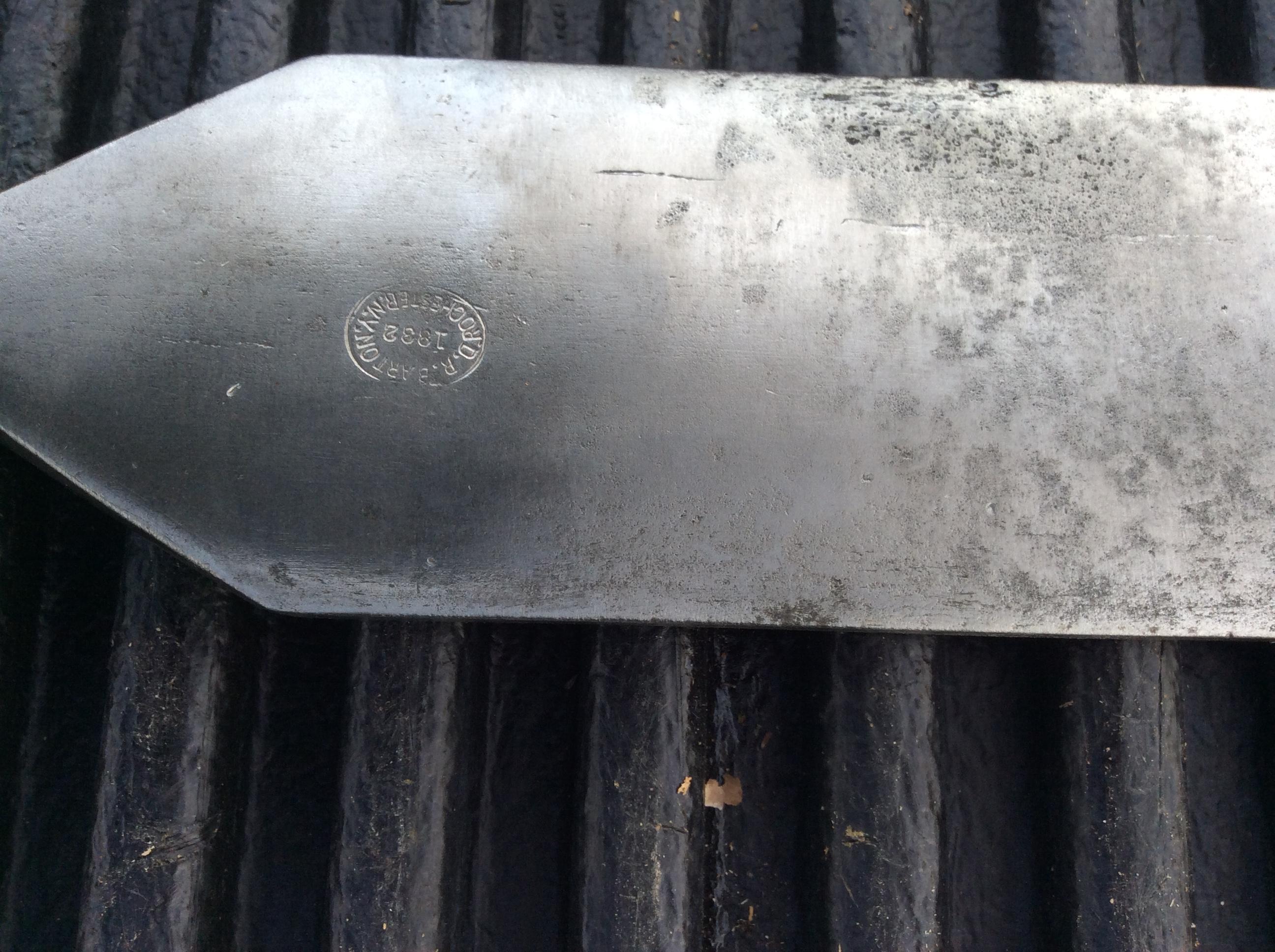

 I put it in the e-tank for several hours which took care of most of the rust.  I de-burred the socket a bit with my brace and a reamer, to undo a few old hammer blows, and turned the new Hickory handle freehand from some photos of other slicks I have looked at.  I perhaps should have gone a bit longer with the handle but this was the longest chunk of Hickory I had . I am OK with how it turned out overall.  This was my first attempt at matching a tapered socket so I am calling this a win.  The pitting is fairly deep on the top side but I think I can clean up the back if I am patient and make it useable.  Sharpening and lapping still to follow.  The blade is about 3 inches wide and 13 inches long.
Best excuse I can give you is: you didn't already have one:P
Cool find.
Really nice job on the handle too. Nice piece of hickory befitting this tool.
Thank you Grandpadave!!  A co-worker cut down a Hickory a year or two ago and I sawed and sealed some blanks at that time just for chisels and such.  This is the first one I have used.  It is beautiful wood!  And, yeah...I didnt have one is a valid excuse from my perspective, too.
