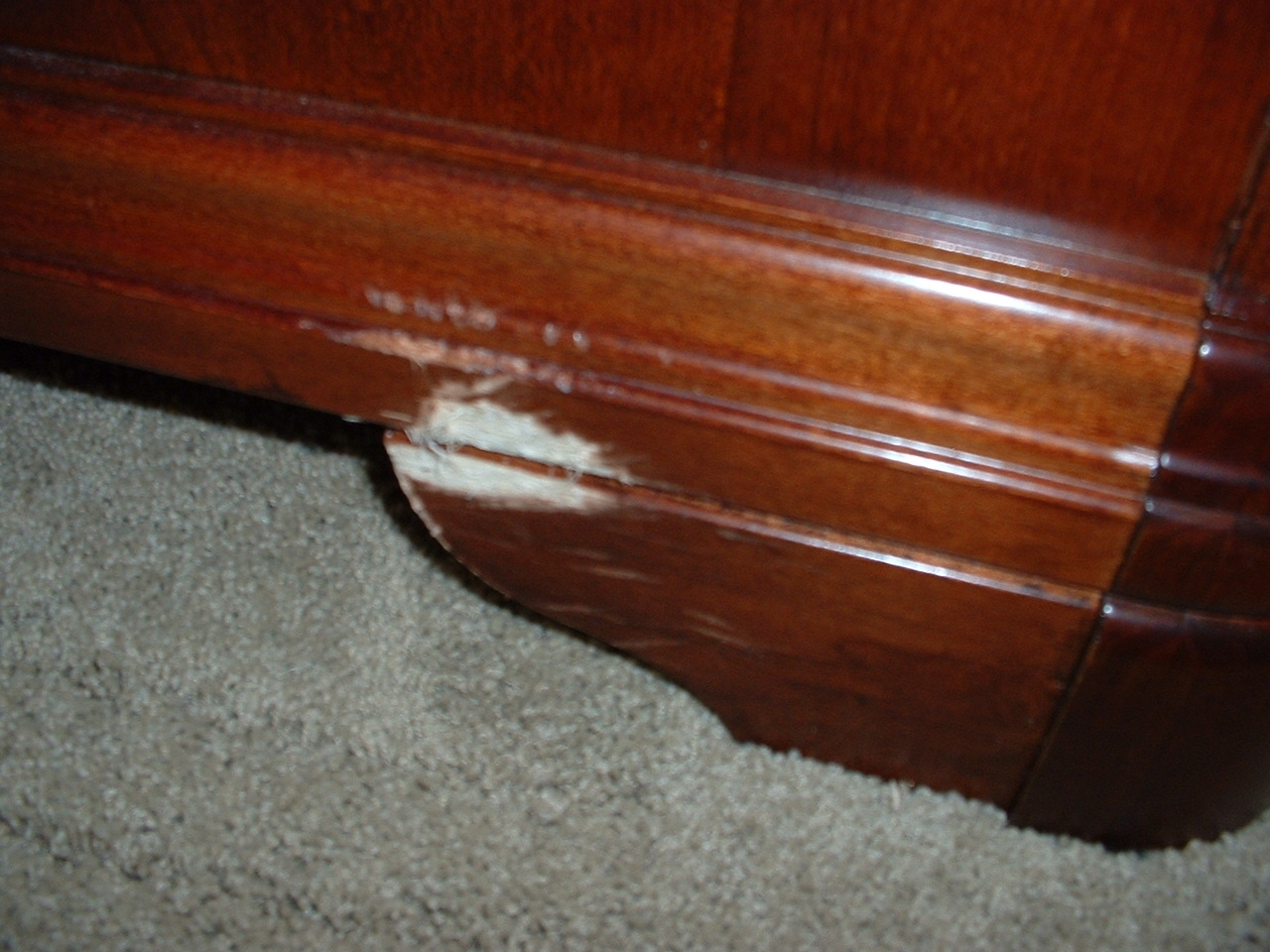

August 26, 20179 yr comment_122219 This procedure is very similar to what I do in doing extensive repairs. http://www.ronhazelton.com/projects/how_to_repair_broken_corners_on_furniture It may not be obvious, but Minwax is his sponsor. I use Bondo all-purpose filler. I also use lacquer touch up markers, pigment powders, and/or spray toners for color and clear lacquer top coats to match sheen. I was reminded once of a job where a dog had done some serious damage to a hall buffet cabinet's base. It took over an hour to fill, carve, sand, and repeat to get the complex profiles to match. When done, he told me I'd done a good job matching the color -- that took 10 minutes and the rest of the time was getting the profile right. Here's another job that I did. They had a a dog with some severe anxiety disorders when left alone. Report

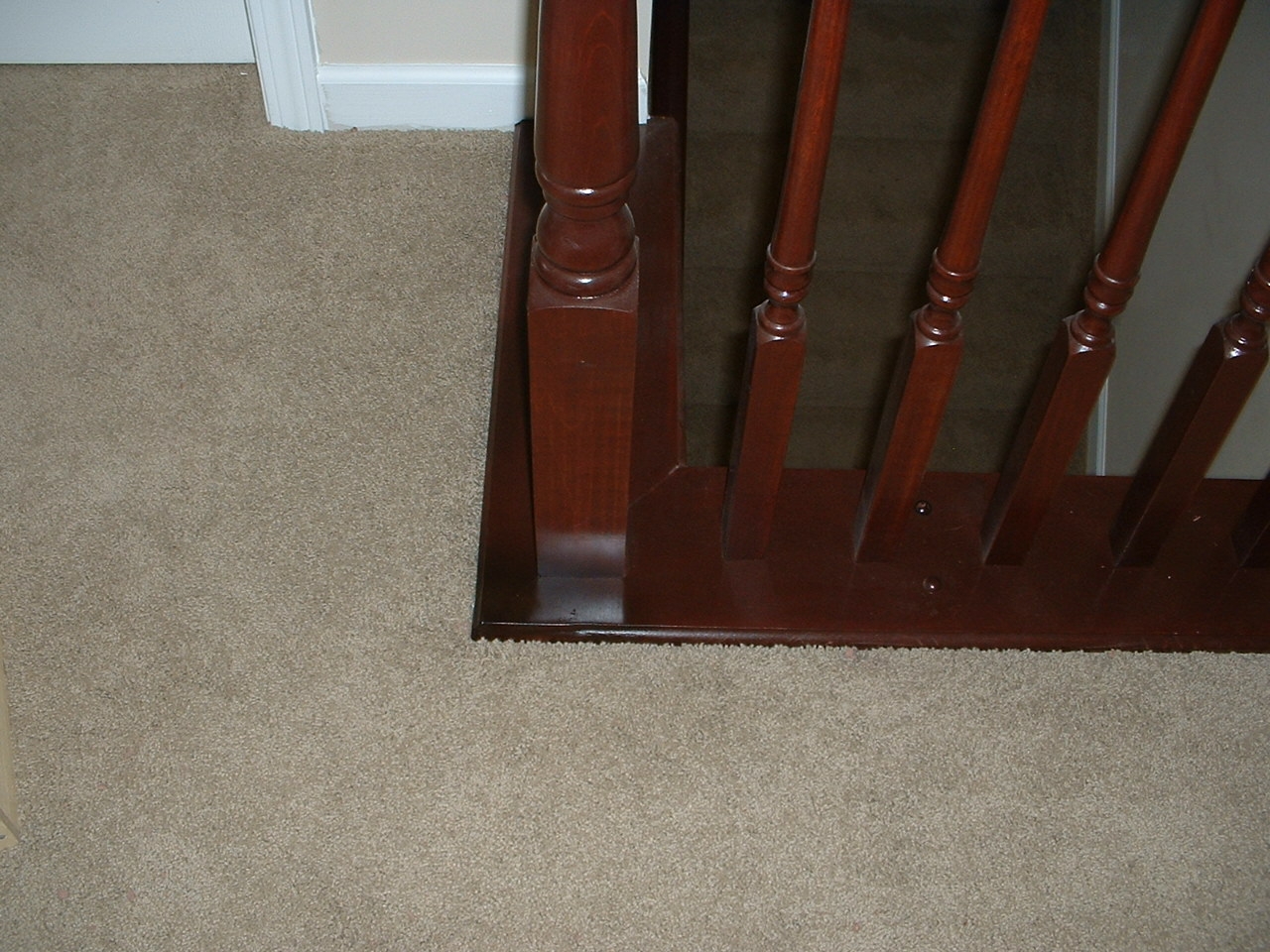

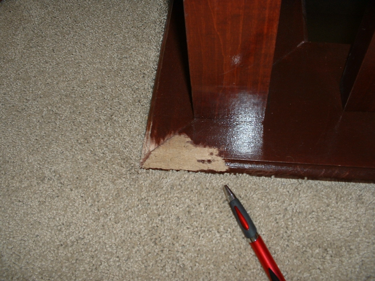

August 26, 20179 yr comment_122291 Thanks for the link. Years ago, our puppy nawed on some painted stair bannisters. I used drywall compound as filler- sanded, shaped and repainted. Still holding up today. Report
August 26, 20179 yr comment_122298 Thanks for that link, Keith. I've used Bondo for filling voids like knot holes in flat material. Never tried forming it to conform to a profile. I'd imagine that for me, the hardest part would be matching the color. My repairs either didn't show or, it was painted. Report
