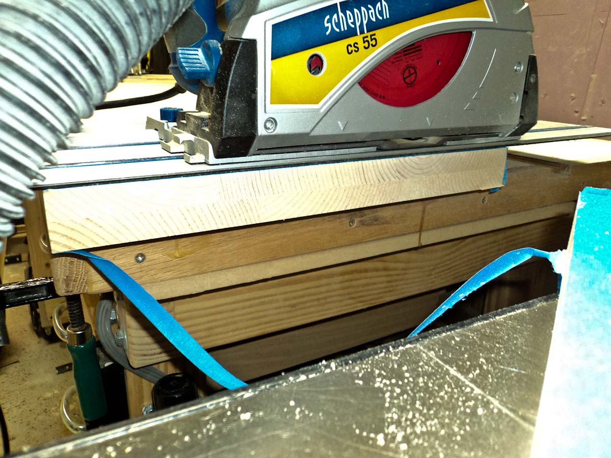

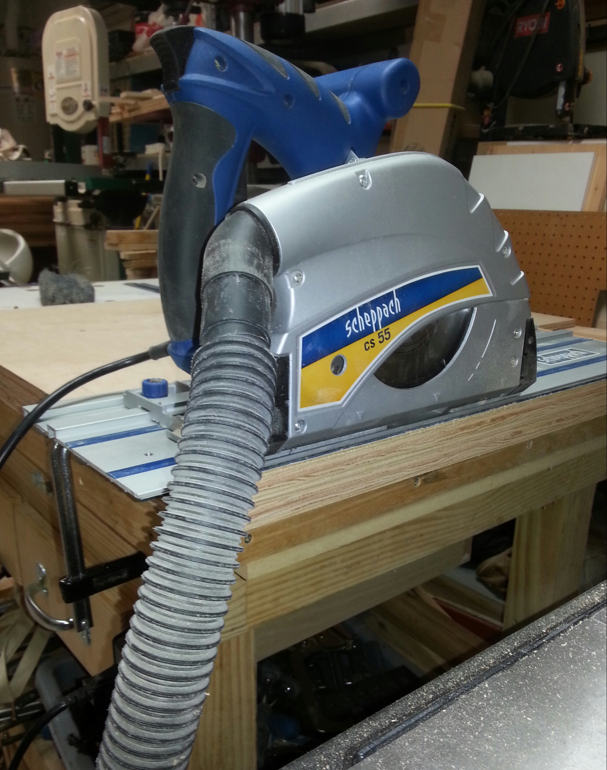

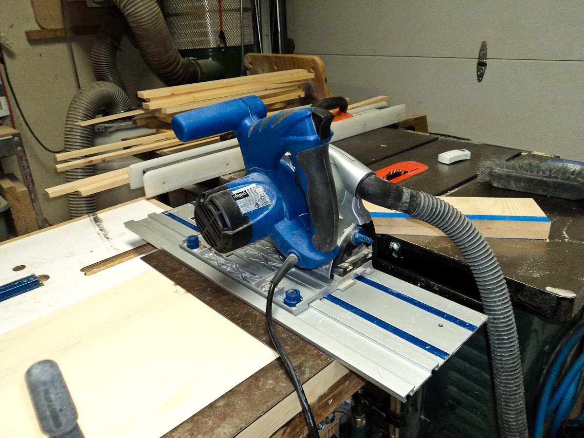

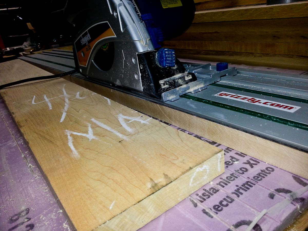

August 21, 20179 yr comment_121675 I have a Scheppach track saw. It is the same as the one sold by Grizzly. Actually, I use two 55 inch tracks I bought from the Grizz. The saw leaves a little sawdust on the table, and some folks complain about wobble while on the track. So far, I have managed to get along with it breaking down sheet goods. One of the great uses is to be able to cut a straight edge on a bowed board. Two thumbs up for that! I stumbled upon an add from WOOT! one day. $125 w/$5 shipping. I couldn't pass it up. That was about 3-4 years ago. Report
