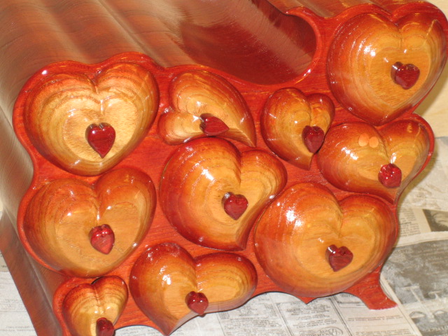

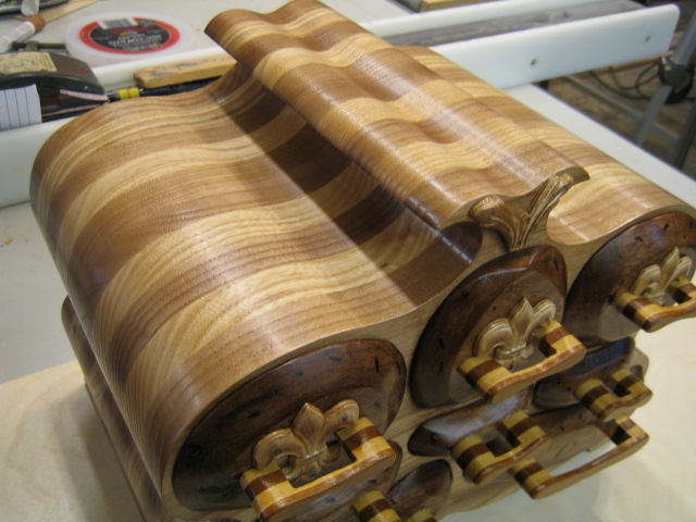

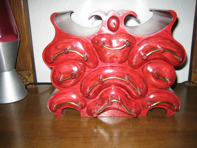

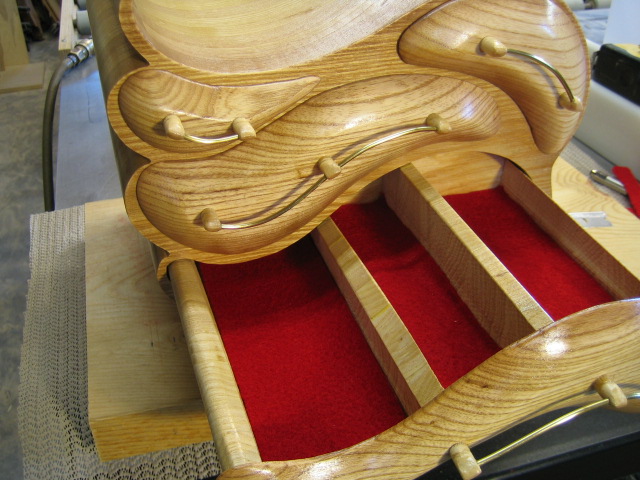

I don't have any patterns but I made some for some boxes I made. You might get an idea from these5998d69e840c3_clocksIdesigned011.JPG.1237cc85ac869967e9d97446df8c138b.JPG5998d6a650c1a_clocksIdesigned013.JPG.e78d5b1eb92af0c2bfe2cf3ff9026e8c.JPG5998d719d5961_gettingclosetotheend.jpg.3f2f724c54f524d0a54ac18ea17b3b86.jpg5998d72e61627_10pieceswide.jpg.64ef47969a14b670ca780b6b8ac466eb.jpg
 The first two are made from welding rods and short dowels the third is wood shaped as hearts and the forth a lady in New Orleans ordered this one plus the pulls are from some bamboo wood flooring.  I would suggest you might be happier with some if you thought up the designs yourself. I am a person who hates to be told anything.

How about this. Short pieces of dowels and a brass welding rod. You can't get more simple than these. My first boxes were just formed pieces of wood with small dowels to hold them out for fingers to get under. Nothing any more simple than that.
Yes Lew, that's what I'm looking for.

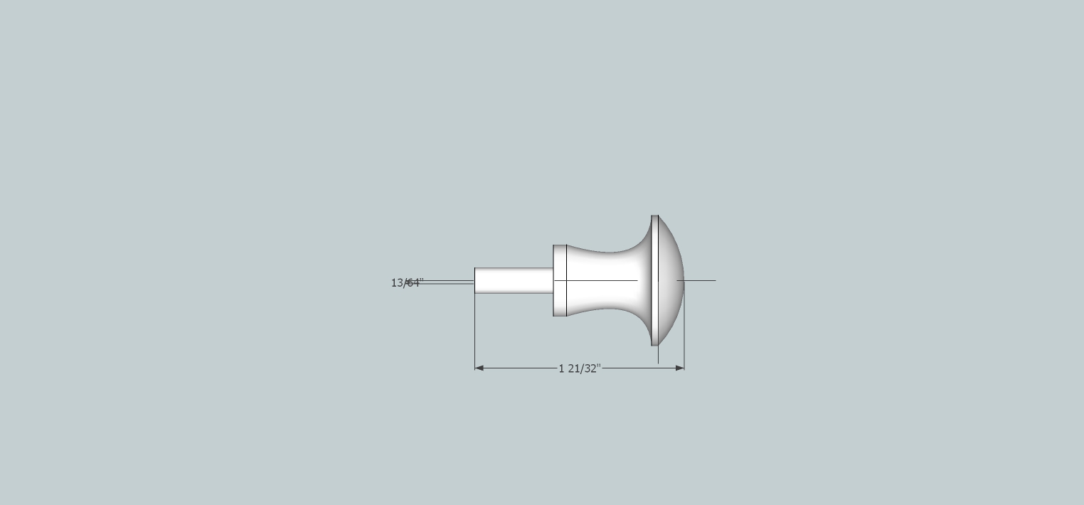

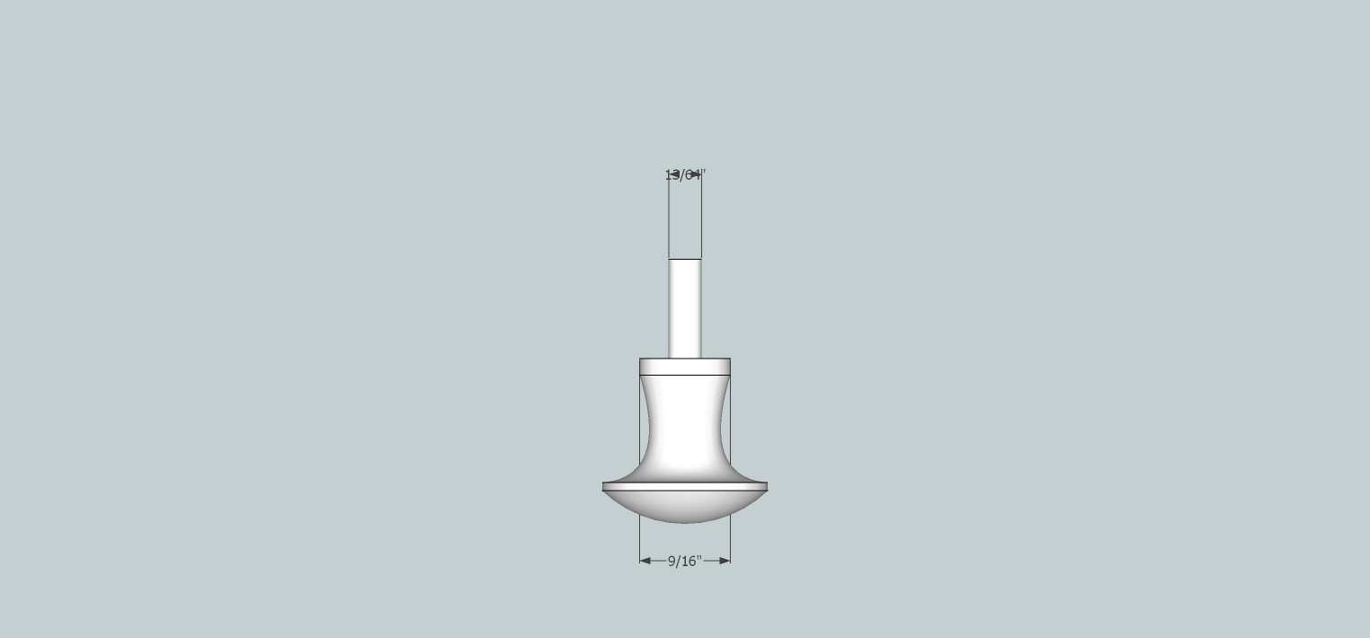

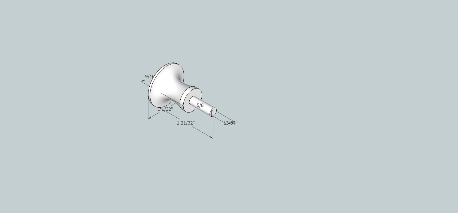

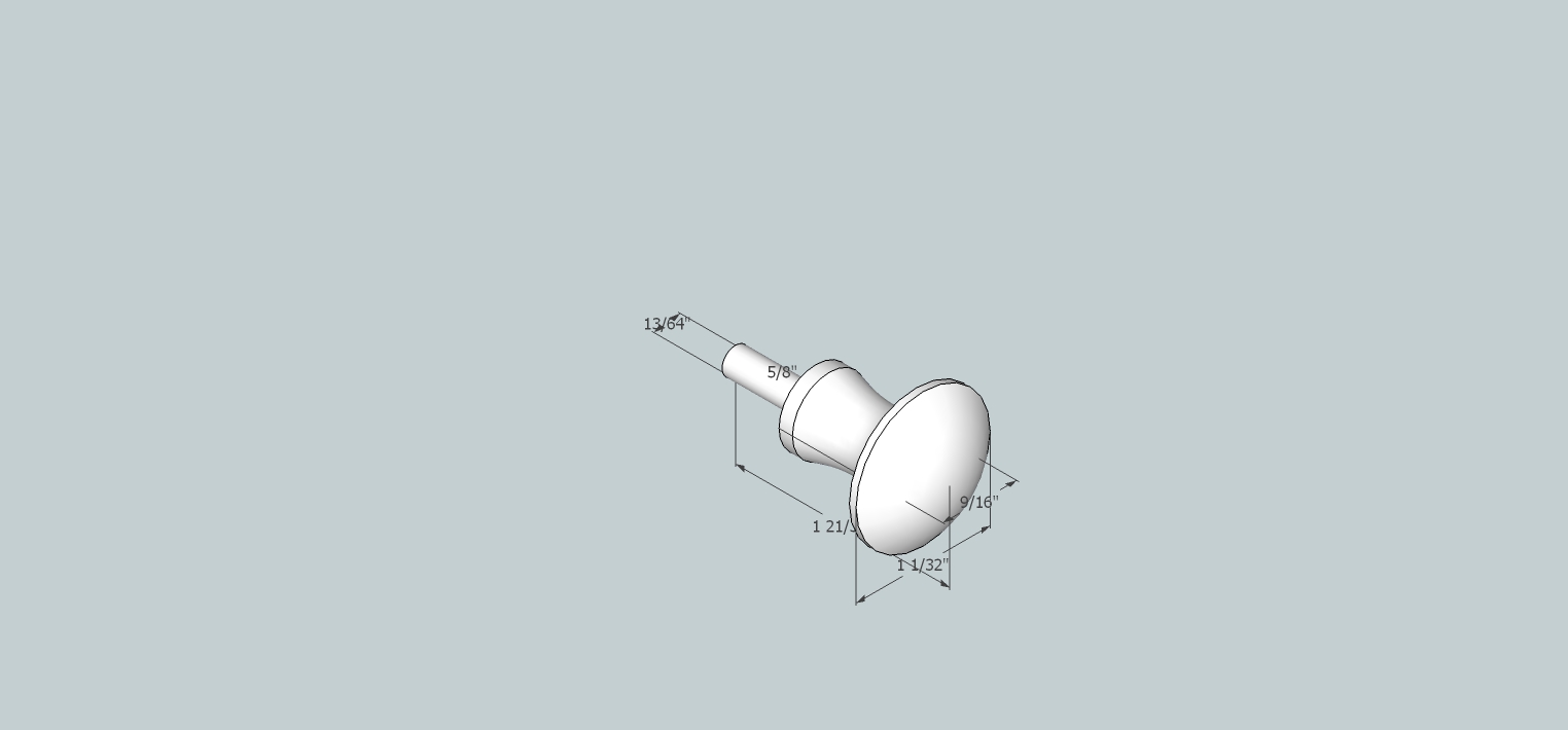

Hang on a minute, I'm working up a Sketchup picture for you.

Lew, you da' man!

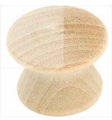

Home Depot has Shaker style knobs in Birch, in two different sizes, if I recall. I think one was 1" and the other was 1-1/4". It's been awhile since I bought them as I salvaged about a dozen from a "dumpster dive" chest and haven't needed any lately.
Here is a link to a 1"
http://www.homedepot.com/p/Liberty-1-in-Birch-Round-Wood-Cabinet-Knob-P10511V-BIR-C7/204417743
