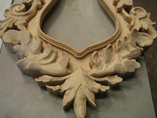

August 21, 20179 yr Author Popular Post comment_121657 Dave I flipped it over and did the right side this time. Now I have lots of smoothing to do. I get more wild in my initial grinding than when I first started this type of work but can't come up with a way to keep from having to use sand paper. I use a round diamond coated bit about 1/4" in diameter but still lots of work. But the whole process of carving I am sitting in a chair resting my back. Report

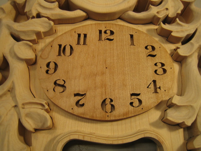

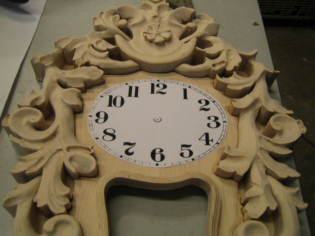

August 23, 20179 yr Author comment_121883 Okay for the dial I thought I would make an oval for it would come close to filling up the space I have for one. I got a round dial off the internet and scanned it . First round and didn't like that so I changed the measurements and got what I needed. The first oval was too big so I dropped the numbers a little and got this one. Then cut it out with the scroll saw. This was done with Rapid Resizer which wife down loaded to work her stained glass with. Scan a picture from the printer to the computer so I can tell resizer what pictures I want printed. I can also do the oval up and down. Sure saves having to hunt for the right size dial then they might not be any available the exact size I need. I would bet a dollar the dial is birch but was the first 1/4" thick I found. Thats okay for it will have a different color that the rest of the pieces. Report
August 23, 20179 yr comment_121922 That looks "just right" in there Jess. Don't know that I have ever seen an oval clock face, nor would I have thought of that - until now that is! Cal Report
August 23, 20179 yr comment_121938 By using an oval clock face will that stretch the day out? Looks really cool though Patch. Thanks for the idea/ Report
