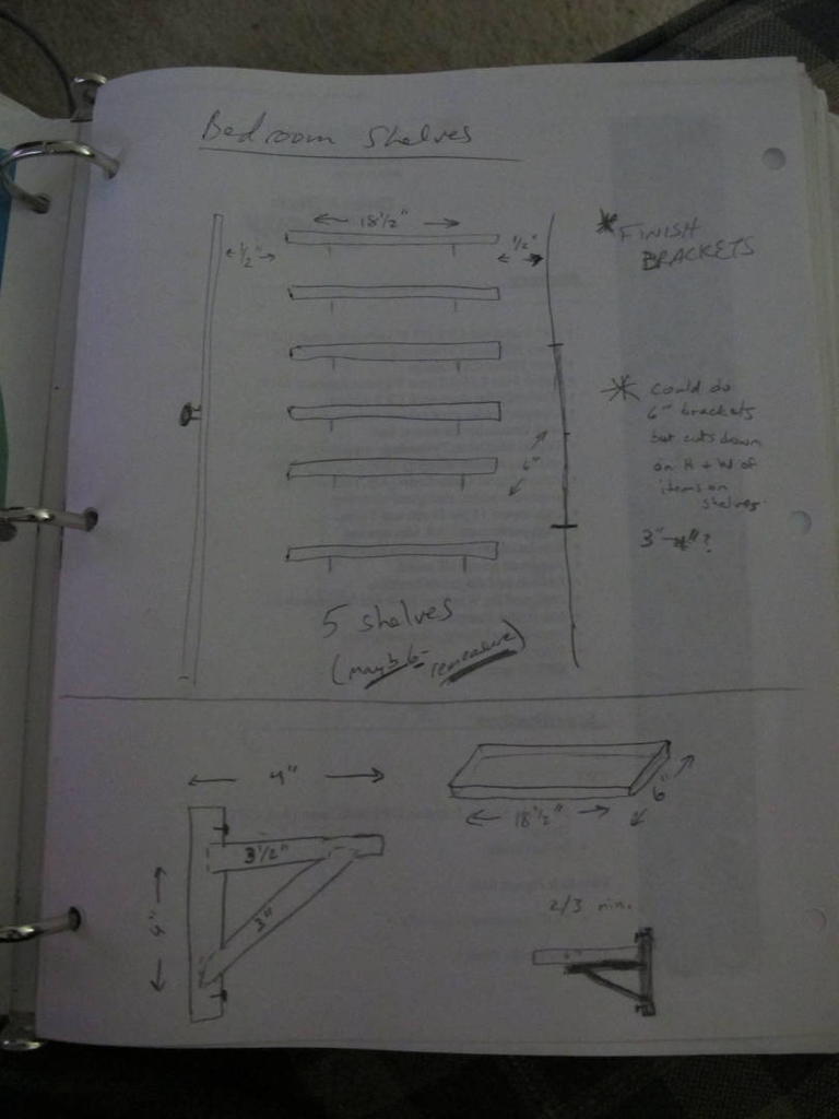

August 17, 20179 yr comment_121073 I cut 6 boards to 6" x 18 1/2" and I want to use 1/2" x 1/2" to make some shelf brackets. It's hard to find the "rules" of making brackets! I did find somewhere the rule of thumb is at least 50% of the shelf width and want to double check that. So, the big question here: I really only want to make 3" brackets. Here's the thing, I have the design I want to use to make these brackets, and I am unsure which way to go. I drew out some possibilities-there's only 12 or 14 different ways to make the exact same bracket! LOL So, do I really need to make dado's or can I just screw each piece on-like butting them up, or do I need to at least make the bottom cross-bar notched into the wall bracket? It's the horizontal weight issue that I am concerned about. The shelves are not going to be holding heavy weight-they are just to hold a few small trophies, trinket boxes and 1/2 dozen crossword books, maybe a flashlight, things like that, basically. Report

August 17, 20179 yr Author comment_121079 Oh! I should have written this when I was more awake. Sorry for not being more precise in my description there. Okay, the shelves are 6" x 18.5" x 1/2" The brackets will be made out of 1/2" x 1/2". I have around 10 feet of it, which should be plenty for all the brackets. So, there's a small space in the corner between a door and window. And in order to open the door and not hit the shelves-clearance is 6". Let me put up a pic to show you the brackets I want to make...I know, to make it easier, I will just photograph my doodles. LOL By the way, with the doodles (1 pg is missing lol), I definitely want the lip on the top, I don't like the top of the bracket being flush, hence they are crossed out. Edited August 17, 20179 yr by DerBengel Report

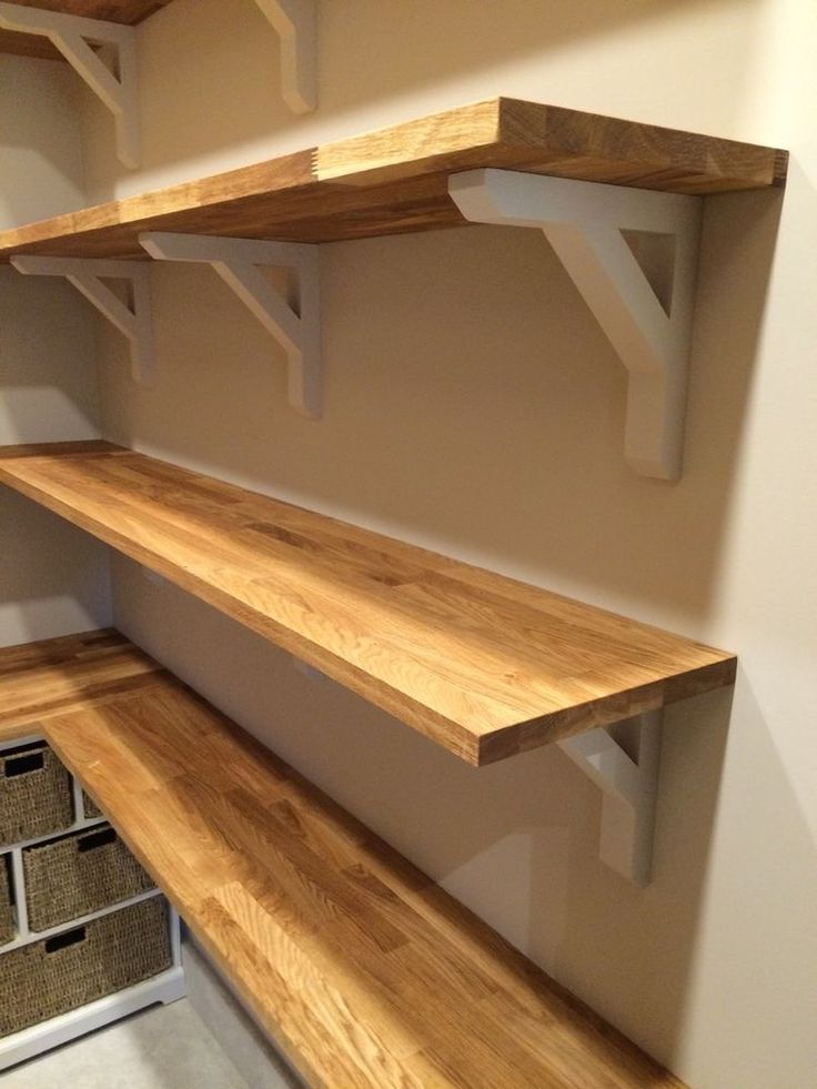

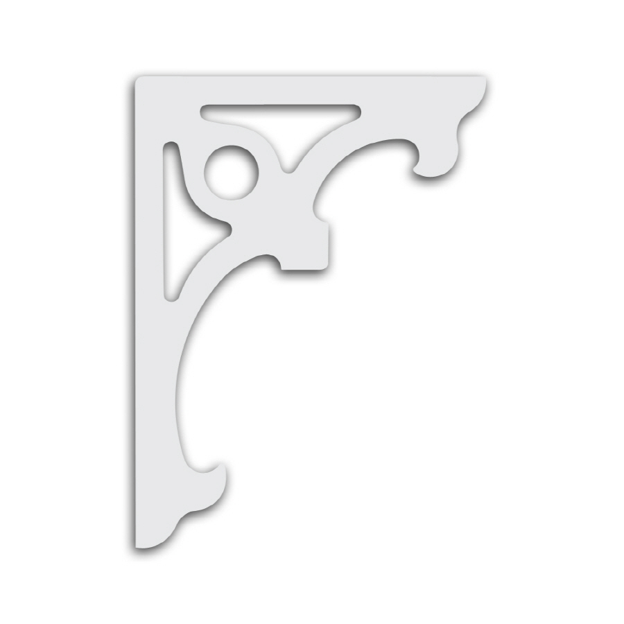

August 18, 20179 yr comment_121188 1 hour ago, DerBengel said: Grandpa, are you talking about a pattern, similar to the ones I crossed off, up above? Not really...I was thinking something similar to these as an idea. The ornate bracket portion would need to be made from your larger stock. However, I understand better now you desire a specific look and have some space limitations... anyways in your mock-up if the shelf and brackets depict actual size then I think you'll want to screw the shelf to the brackets. If you don't, it'll be pretty easy to tip the shelf from the brackets. You are thinking more along these lines I believe? Both of these appear to have a 45o miter connecting the top horizontal with the vertical wall support. Report
August 18, 20179 yr Author comment_121192 Ohh, ohh, okay, I understand now! I LOVE the frog (and acorn) bracket! Only thing, is with these tiny shelves, I am really trying to keep room for the items and a bit of space between shelves. Otherwise, it would be better to make a frame with shelves in it, but I don't want to do that... Yeah, the 2nd set is more like my line of thinking, only have the top of the wall piece, sticking out a little bit above the shelf. By the way, I double checked the thickness of these shelves and they are 6" deep, 18.5" long and 1/2" thick and lightweight-good enough for the light things I will be storing on them, just to give them a home. Report

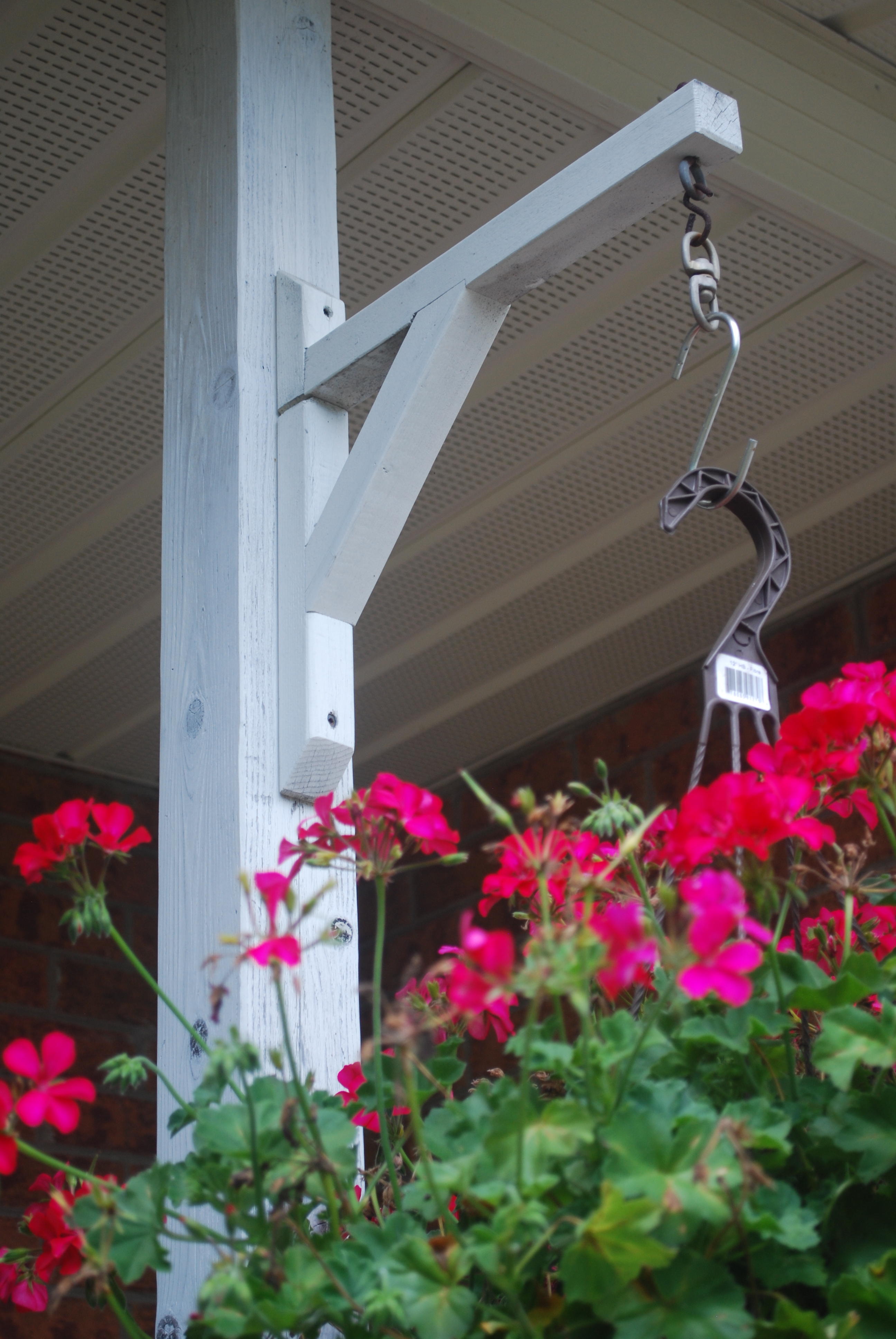

August 18, 20179 yr comment_121266 I have made a number of similar brackets out of leftover 2x2 railing balusters for supporting flower boxes and hanging baskets. All of them had the rear piece extending above the upper member, so that they could be attached to a wall or post top and bottom. The design is very strong, and should support your light-weight shelves with no problems. Drill a pilot hole through the back and top pieces, and run screws down into the brace, and they will not show. John Edited August 18, 20179 yr by HARO50 Report
