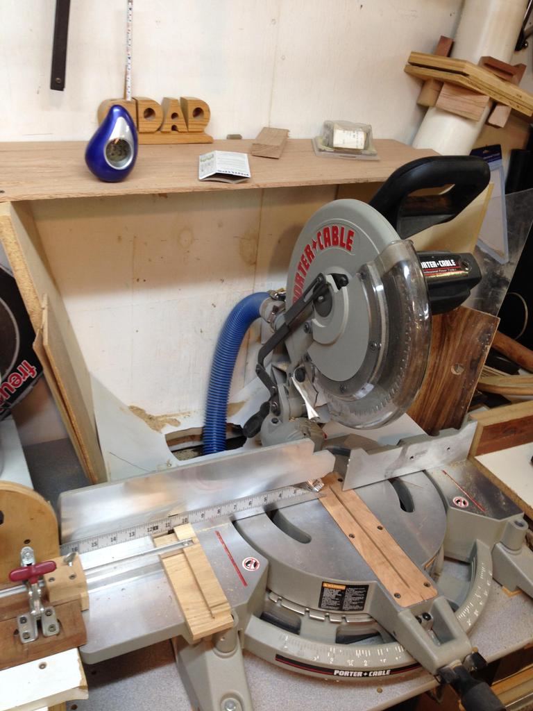

August 15, 20179 yr comment_120759 I modeled mine after a guy on Wood Saws nDust. Connect DC from below saw with a hollow box collector. Made a hood above the saw which I have enlarged twice. The new configuration gets about 85% of what comes off the saw. Will try to remember to make a pic this afternoon Report

August 15, 20179 yr comment_120839 4 hours ago, Fred W. Hargis Jr said: Gerald, was that Jim Becker? Yes. Here is pic no where as nice As his Report

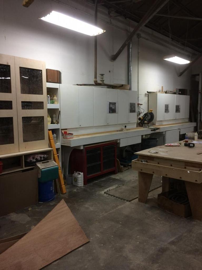

September 24, 20179 yr comment_125792 You really can't tell it but a pipe comes down and as dust is created it falls into the "pit" and about 1/2 goes into the 4" dust pipe and after awhile I'll take an air nozzle and lightly blow the rest into the pipe.. Not perfect but works from fair to good... Report
