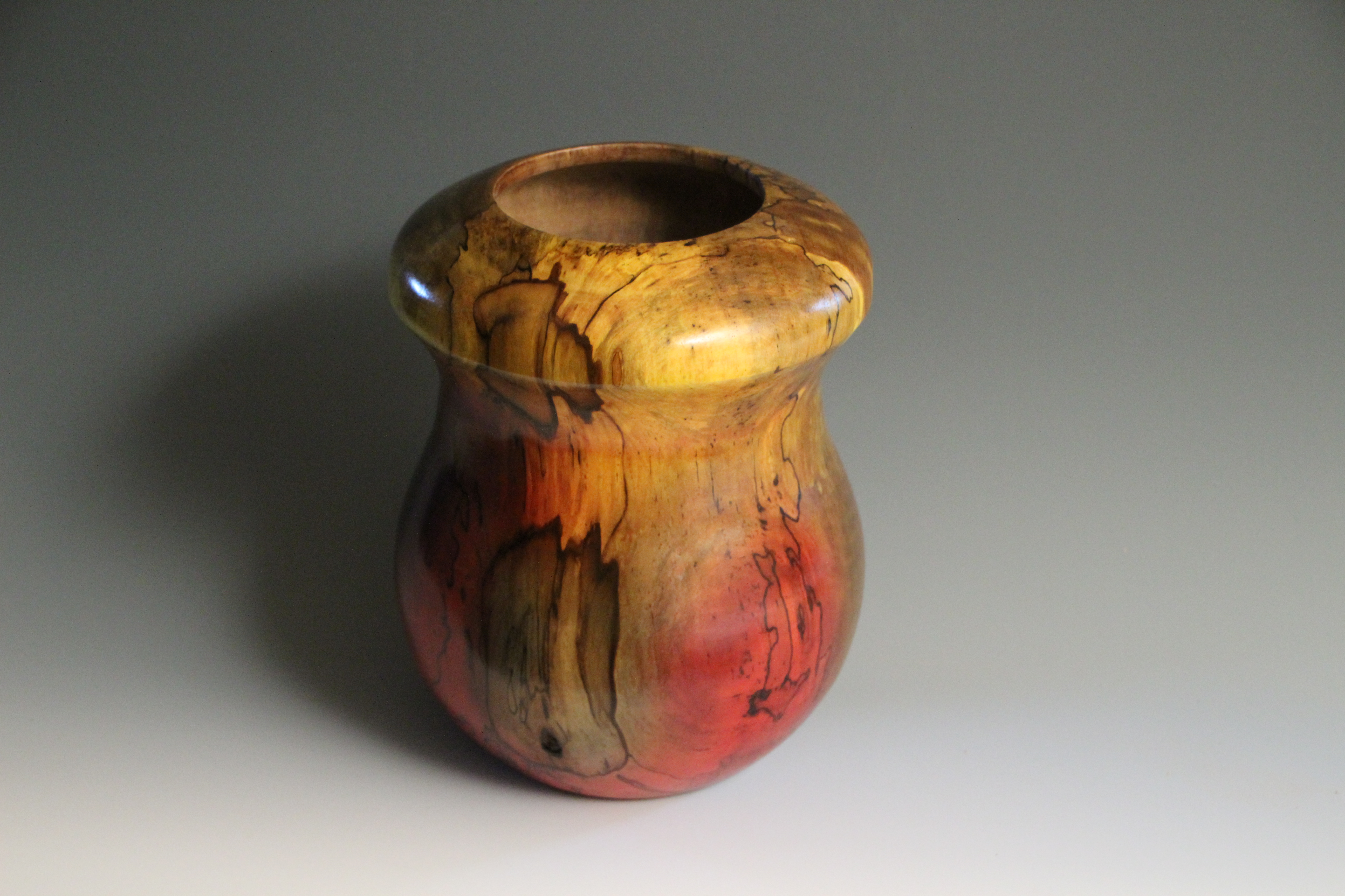

If you are using bright colors Chestnut Stains works well. It is alcohol based and has small amount of shellac in it. As Jesse said you can add more color with layers. If you want lighter color with Chestnut it is best to dilute and then apply with airbrush in amounts to desired color concentration. 5989fbef2d044_VASETUNGSET.thumb.JPG.332273df3d6497081c35b7efc46e7a8e.JPGFor this one the color was sprayed on with airbrush.
Note where different colors overlap a new color is created by the blending of the two.

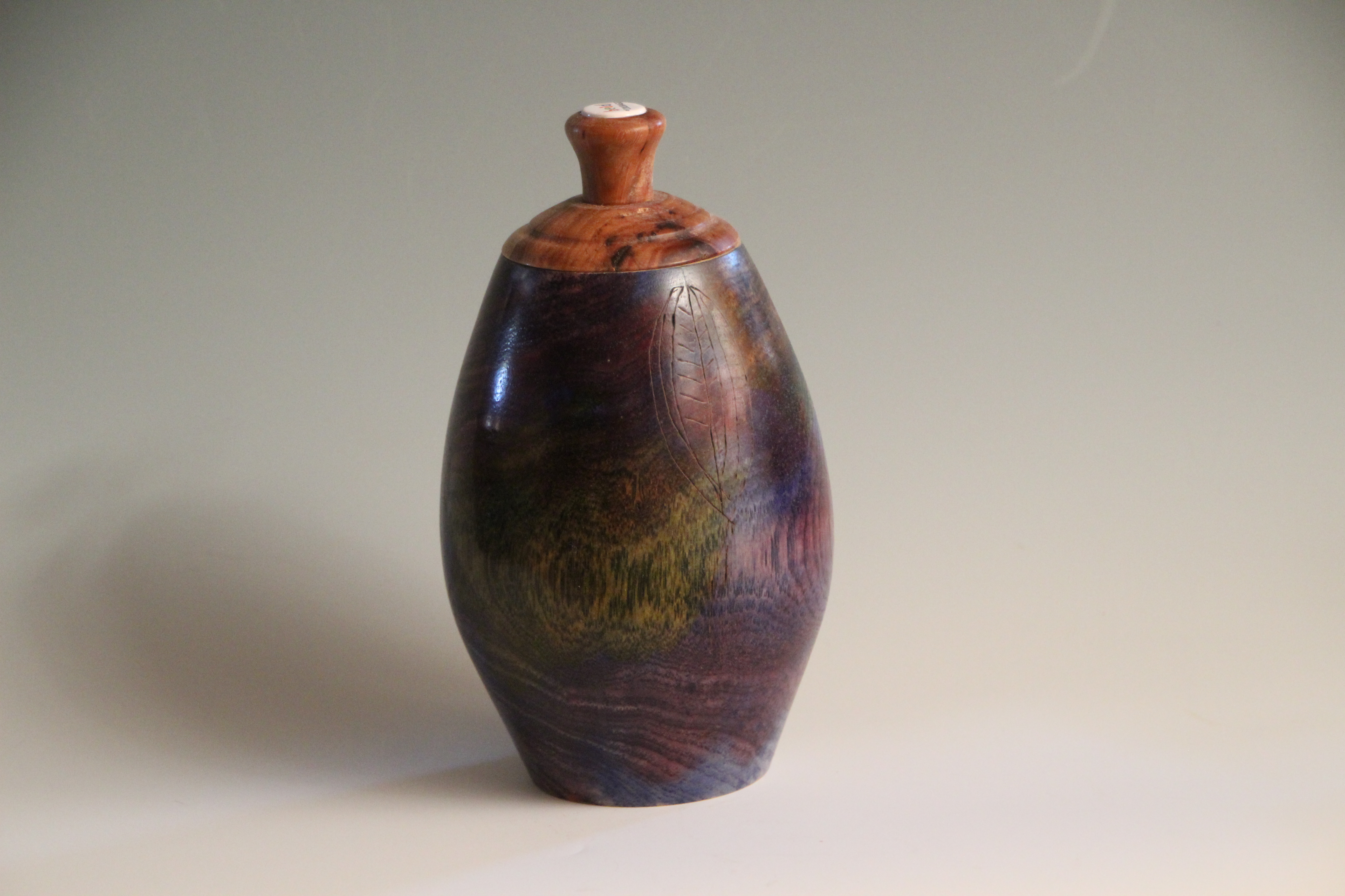

In this one the color was blotted on with a paper towel.
