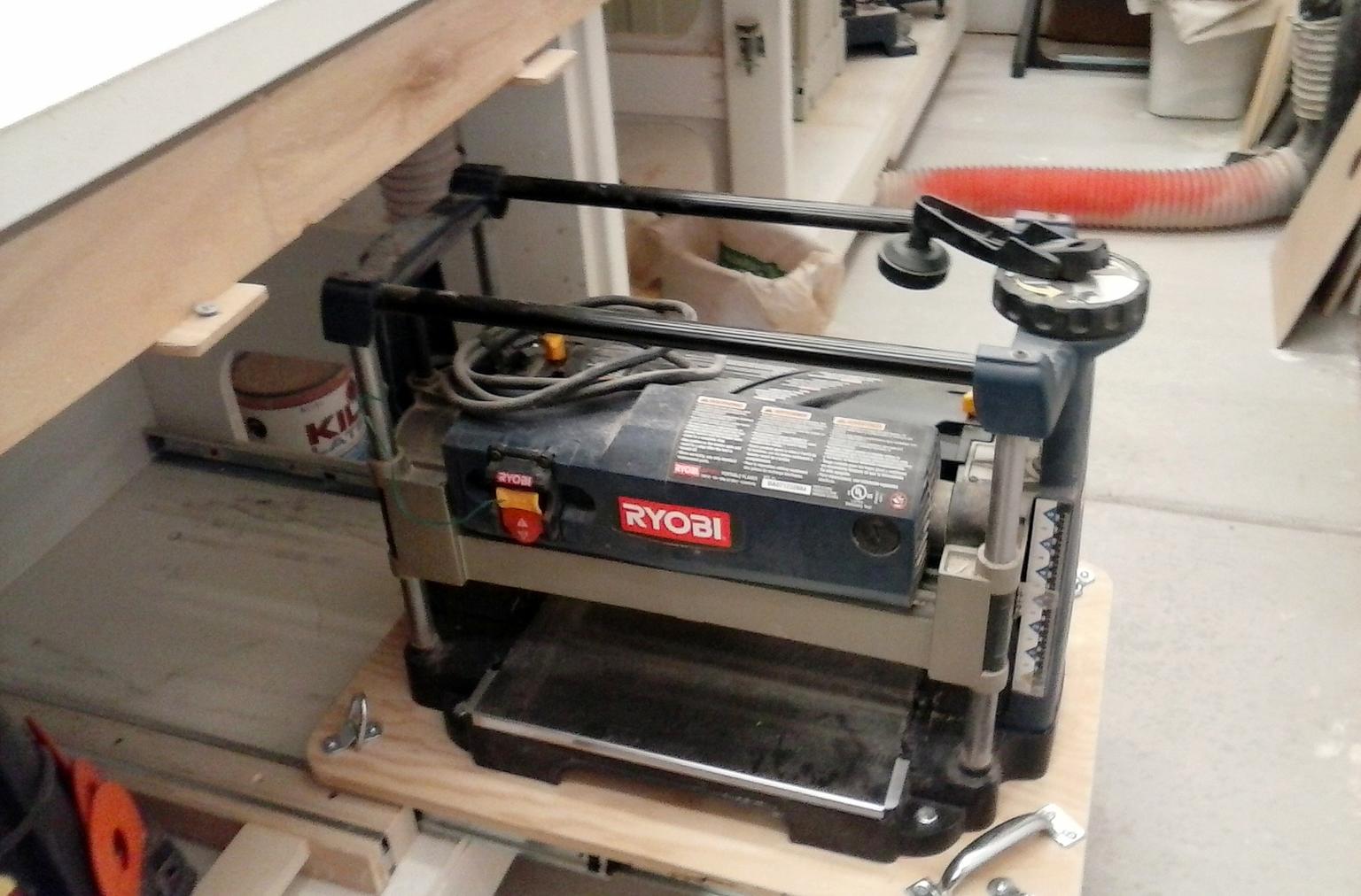

August 19, 20179 yr comment_121438 I thought about flip-base tools, but finally decided on a bench with a tool shelf underneath (space is 5' x 13"). Eventually I found that lifting the heavier tools out from under the bench was getting to my back, so I put in an electric hoist. But the hoist doesn't like dragging things horizontally, so I put in some pull-out shelf runners which allows the tool to come up in a vertical lift. After all that, I found that the most important part of the process isn't the hoist itself, but getting the tool out from under the bench in the first place. Something like getting into a car: dropping in on a slant is stressful. I use the hoist anyway, but the sliding shelf works well. Report

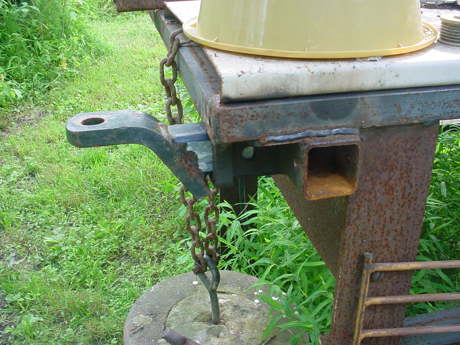

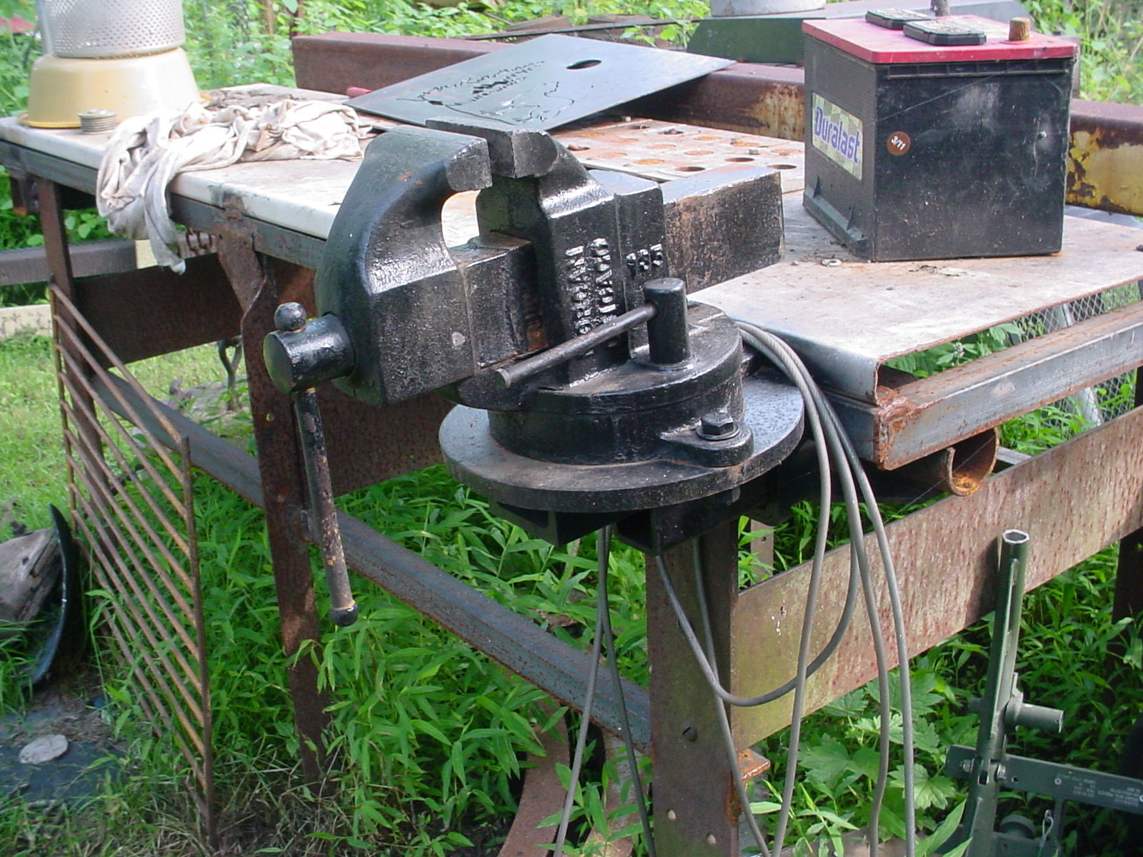

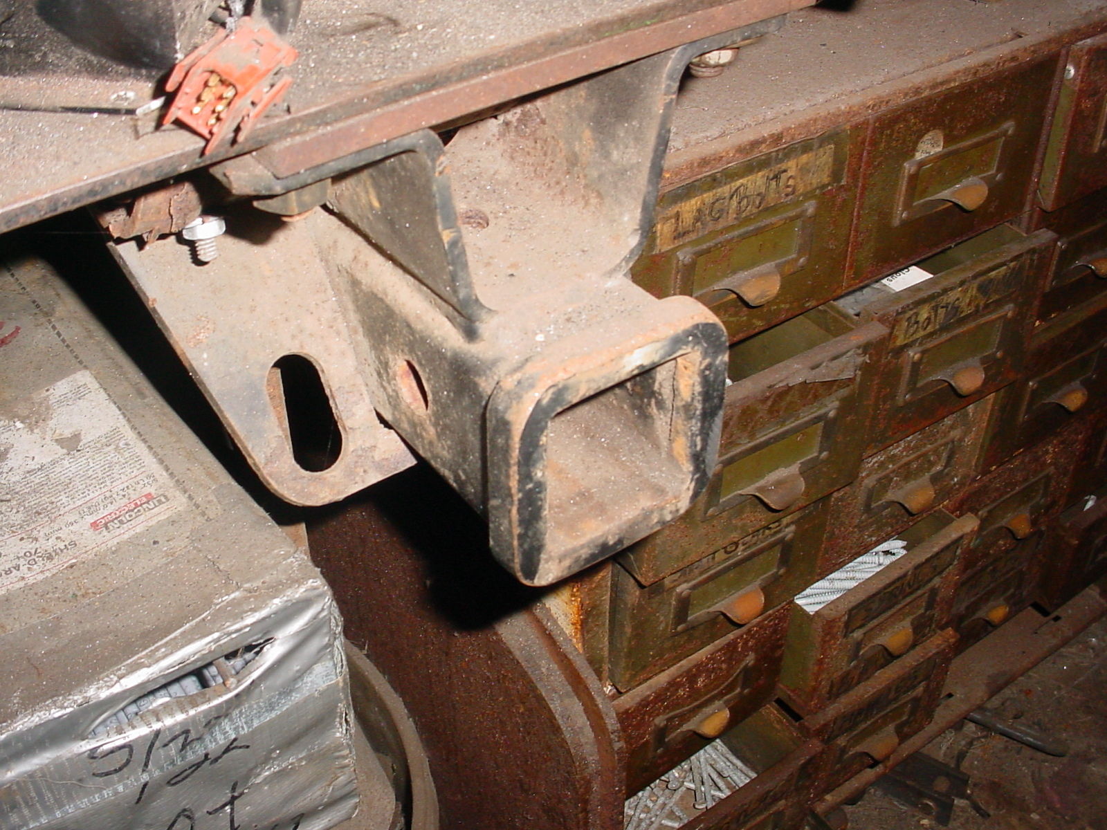

October 4, 20197 yr comment_203899 I went a different way. I put class 3 hitches on all my work benches. I keep my bigger tools under the bench on a receiver and when i need one I just pull the tool out and slide it in the hitch... You can buy the receiver part from Harbor freight for $10.00. Report
