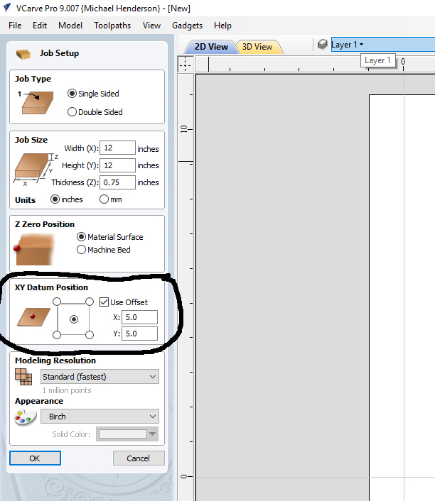

What the heck? Each time I start a new project in VCarve Pro ver 9, it is set to an offset. This has become a nuisance to say the least. I don't know how to get the box unchecked. It appears to be a default setting. Or did someone else use my software before I upgraded? :)  I did not have this problem with Cut2D or the trial version of VCarve Pro 8.5.
Help!!!

When I start a new file it has my previous setting that I used on the last file I saved with it.  Just did a test, and after deselecting the offsets and setting the center as my board to be the 0,0 origin, I drew a quick square then used Save-As to give it a name.  I then closed that file.   Started a new one and now my offsets were not checked, and zero was in the same place as that file I just saved.  I completely closed Aspire, ran it again, and when I started a new file the settings were the same, but not what I had started with initially the last time I started up Aspire.
So default behaviour is to remember the settings used with the last file you saved.  I actually appreciate that because I usually want to start with the same settings. If there is nothing you can do to change how they are set when starting a new file then something else is amiss. Are you perhaps running Aspire from a networked install?   I know our network manager where I work installs all programs so that no matter what a user does with them then always start up the same.

But...but...but I have never used an offset. That is the way it was after upgrading to ver 9 from 8.5. Bummer. I will try your suggestion later this evening and report back.

You might also check to see if there is an update.   I found a 9.008 update available today which was to fix a few errors that users have found.
Thanks 4D. Your suggestion worked. However, I can't figure out why it hasn't worked on previous files I have created in ver 9. About 5-6 of them now, and each time I would create a new file, that danged box was checked with 5,5 offset. Whatever, it is gone now.

Mike my VCarve pro did the same thing but I don't use VCarve too much so I guess it did not dawn on me until reading your post.  I have updadted to V9.008 and it opens without the offset now.
