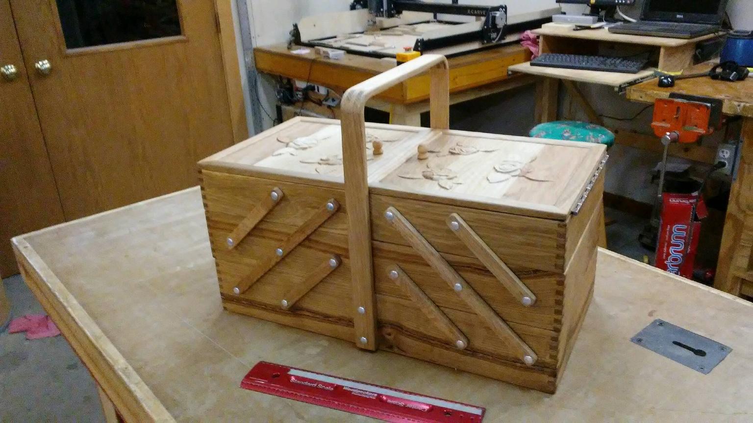

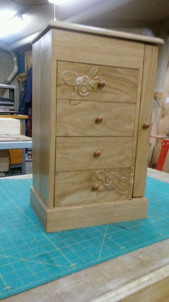

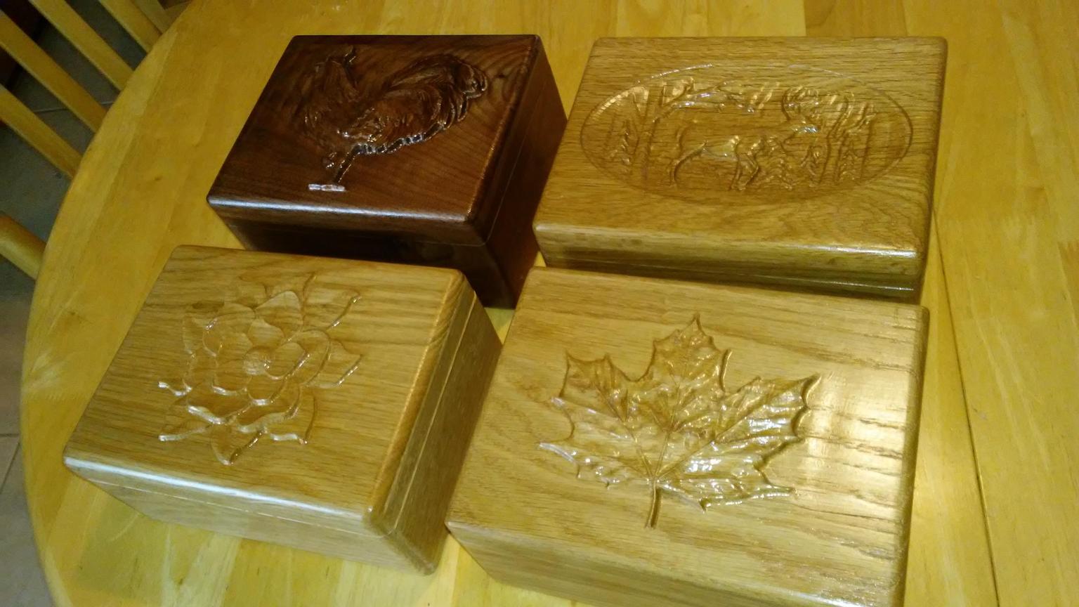

September 2, 20179 yr comment_123183 The xcarve is a good machine to learn on, both in how a machine goes together and what the work flow is IE; design, generate g code, set up the material i n the machine and create your masterpiece. It is not a some simple assembly required and plug in and go machine, however. You would be assembling the whole thing, pulling the wires, bolting up the rails, mounting the motors and fiddling around getting it fine tuned. But in the end you willl be well aquainted with the finer points of it. when something goes awry, you should be able to figure it out and correct it. It's also open source. you are not only allowed to make modifications to the unit, it's encouraged. There is a very vibrant and welcoming and helpful online community to interact with specifically regarding the xcarve and many modifications that have been made to individuals machines. How far you want to take it is up to you. Myself, I have made a few changes anf it will do most any thing I need aside from cutting steel but others have done this. Many machines got folks started and now thier machines only vaguely resemble the original. One member had even developed a screwdrive system that replaces the belts altogether and is offering kits for it on the forum. Is it designed for all day every day cabinet shop use for cutting parts? Not really. Is it a gateway machine into the world of cnc? HECK YEAH! It does what I ask of it, 2d and 3d embellishment of the projects I like to create,. and It's capable of much , much more. Here are a few pics of what I have done with mine, Report
