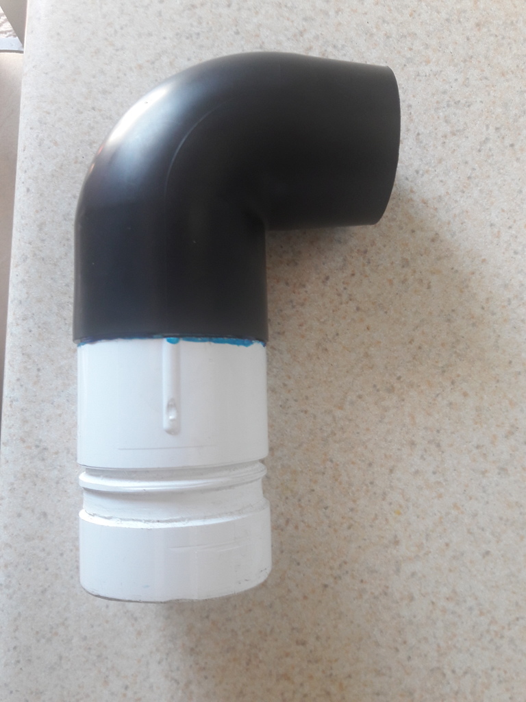

July 19, 20179 yr comment_117136 Hello, I know that I am not the first to have this issue. I just got a Dust Deputy Deluxe Cyclone Separator Kit as a gift and have been putting it together. I have a Fein Woodworking vacuum that I want to attach it to and it seems that I need an adapter to connect it to the dust deputy. I contacted Onieda air and they gave me a link to a company that makes plumbing accessories. An email to them resulted in no reply. Has anybody else out there faced this problem? If so, how did you do it? Best to all Ron Edited November 22, 20178 yr by Ron Dudelston tags added Report

July 22, 20179 yr Author comment_117748 Just thought that I would show you what I did. I took the advice from Handy Dan's post and bought some PVC 1 1/2" pipe and a joining adapter for 1 1/2" pipe. I found the the link piece was about the size that the vacuum accepts from the hose. So I put it on my lathe and made an exact match. I used half of the joining adapter to make what goes into the vacuum and used the other half to fit inside the 90 degree angle provided in the kit. This made a snug fit. I have a photo showing what I made on the lathe and the setup of my system. Now I just need to find hose clamps to hook the black hose to the vacuum. Thanks for the suggestion Handy Dan, it was fun using the lathe on pvc. Ron Report
July 22, 20179 yr comment_117754 Looks professional! Nice job! I buy most of my hose clamps from Tractor Supply. Report
July 22, 20179 yr comment_117761 1 hour ago, rlpeterson said: Thanks for the suggestion Handy Dan, it was fun using the lathe on pvc. You're welcome Ron. Glad you came back and let us know how you made out. It is fun turning the PVC on the lathe but it sure makes a mess to clean up. Report
