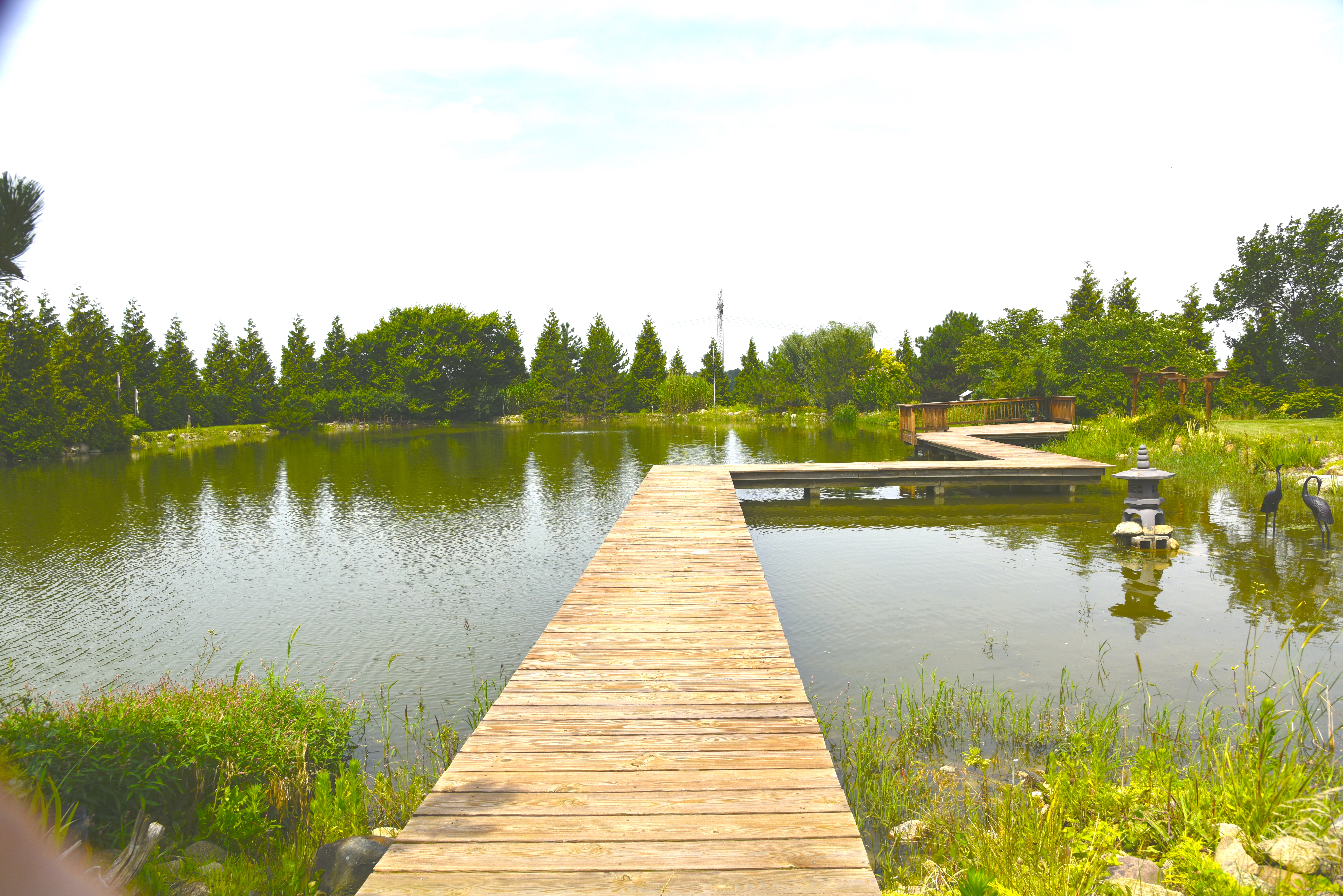

July 12, 20179 yr Author comment_116265 Yeah, here's one. You might notice the Pagoda and 2 birds on the center right....the birds are what I anchored to the blocks and put there The pond is still about 10" below full pool. Edited July 12, 20179 yr by Fred W. Hargis Jr Report
