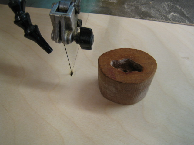

June 19, 20179 yr Popular Post comment_113544 Recently a fellow woodworker sent me a note about an upgrade someone did to his DeWalt 788. Seems as a Marcus Bailey has come up with a over sizsd knurled knob cap for the Dewalt Scroll saw. He is making these and for more information you can contact: Marcus Bailey 404-274-2532 Or: scrollsawcomfortknob@gmail.com They come in 2 sizes,1.125" and 1.00" , I bought 2 small ones, here are the pictures,thats about 2 min. to install. Herb Report
June 19, 20179 yr comment_113548 I took care of that problem in 99. I would rather make something myself. I made a one piece set that fits top and bottom.... Report

July 20, 20179 yr Author comment_117361 5 hours ago, Fred Wilson said: Herb - does the extra weight on that side upset the balance? Do you notice any difference in the sound of the saw? My inquizitive mind wants to know. No problems,Fred, They are made out of aircraft Aluminum and are very light weight. There is no additional noises,I can determine,they do not hitting the bottom of the table. I have some arthritis in my hands and thumb and loosening the original knob is very difficult, this solves that problem. Herb Report

August 29, 20179 yr comment_122661 These are for the Excaliber saw. My understanding is they will also fit the DW. Report
