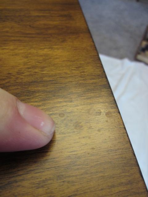

A job yesterday was a dozen less than 1/4" spots on top of a dining table.   I think the owner was a bit OCD because you had to be at exactly the right angle to the light to see them.  At least it was easier to repair than a spill from a bottle of nail polish remover.
