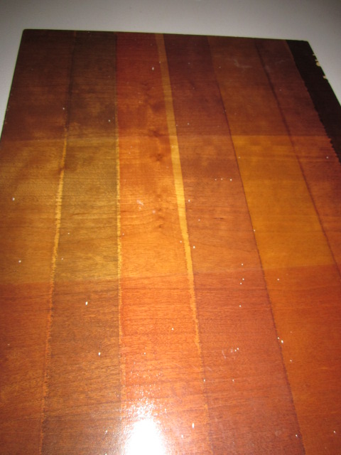

One of my common stains is to dye a red undercoat, then apply General Finishes’ Espresso stain (which to my eye has just a lot of black in it).   The red under-tone more closely matches what you see on commercial “expresso” finishes (remember, that’s what they call it).
To help me visualize what the results will be, I made a sample board with some standard dyes in one axis and some of my standard stains in the other axis.   This shows what they layer of dye + wiping stain will be.
