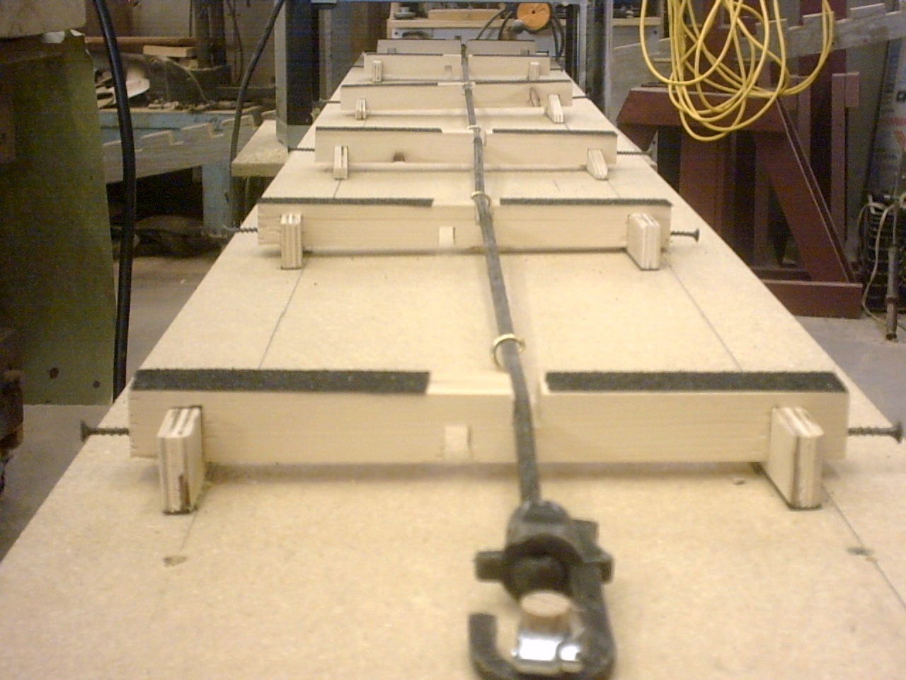

May 21, 20179 yr comment_110206 A planer sled and wedges do a fine job with non conforming lumber. My 6" and 4" jointers are strictly edge jointers. This is the sled I use. Edited May 21, 20179 yr by Gene Howe Report
