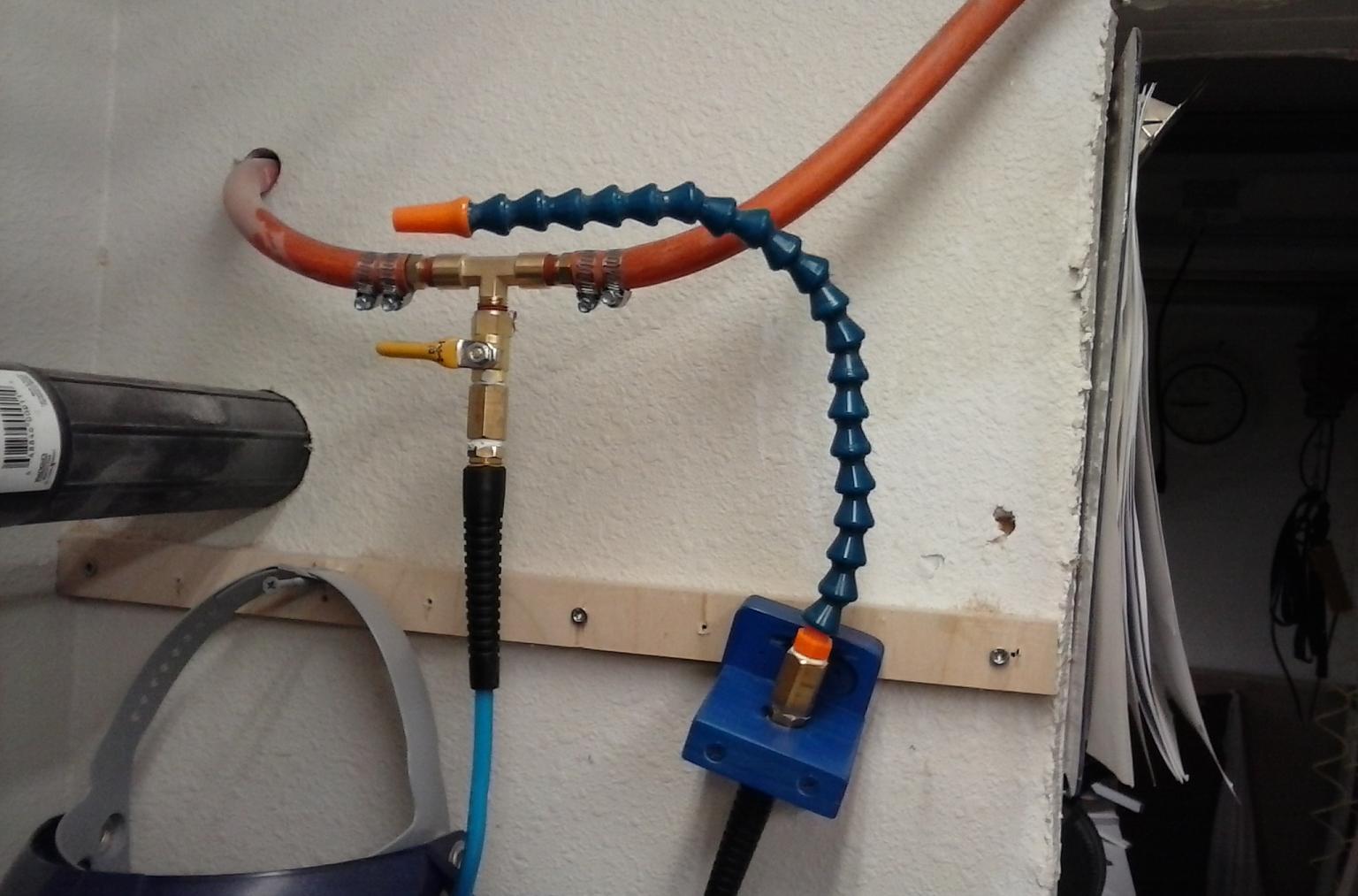

May 6, 20179 yr comment_108628 A long time ago, in a galaxy far fa....oh, wrong track. Maybe a couple years back, in a forum that shall be nameless, Ralph raised the question about how to see the cut line on a bandsaw, when the dust/chips kept collecting on the line marks. I thought at the time that LED lights would help. They did, a little, but not enough. I then looked into a chip blower setup, but found that BS either had them or not, depending on how the motor housing is configured (to bleed off vent air). Mine don't, so I tried Plan C: install something. Turned out too expensive, I couldn't find the right parts, etc, and I gave up. New galaxy: W-smith tips show a product called Loc-Line, a hard plastic channel, bendable, nozzles, do-able. So I went with it: I got the tee (insert x insert x NPT) at HD for $5; Loc-line (the blue and orange), $8 (amazon), hose $13 (a), shutoff valve $3 (a). Had to get a F/F coupling for a few bucks. Voila, per W-S idea, blue block has magnets on the back, stick to both BS and drillpress. Also is handy for just blowing off the tools. Neat-nick (OCS lives on!). I didn't need a pressure regulator (valve does that). The Loc-line kit comes with three different nozzles, which i'll have to try (I suspect air consumption will be important). Not shown, but turns out needed: Loc-line pliers ($11 from Am). Of course, already had the air hose passin' thru. It be slick. Edited November 23, 20179 yr by Ron Dudelston tags added Report

May 8, 20179 yr comment_108819 Line Locs are a great invention. They have been around for years and are pretty versatile. I got portable shields for my machinists that used a magnetic base, and Line Loc stem and a piece of Lexan. They could be placed/mounted almost anywhere. Use your imaginations; magnifiers, lights, shields, on and on. Oh, by the way, you don't need the Line lock pliers. Just soak the section in hot water and soften them a little before snapping them together. They will get brittle after a few years and loose some holding power or the socket will crack. Just replace what you need to and your back in business. Report

May 8, 20179 yr comment_108884 10 hours ago, schnewj said: Just soak the section in hot water and soften them a little before snapping them together. Just like the old pop-beads back in the 50s. Handy little things for coolant or lube, too. Report
