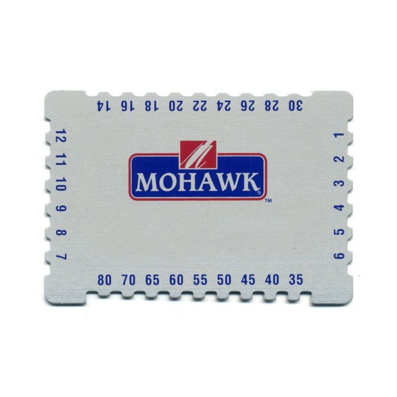

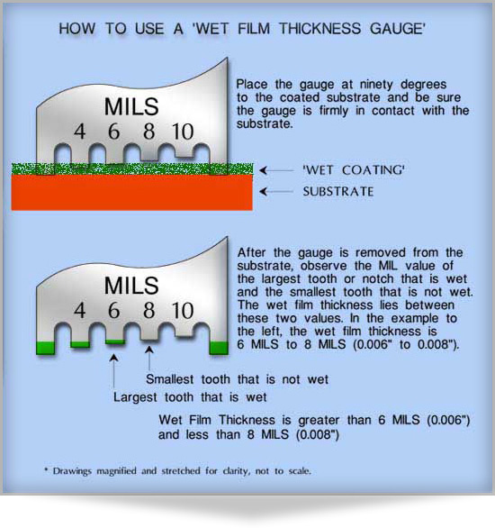

For those not familiar with that terminology, a mil is 0.001"   I find many people put finish on way too thick.  My credo is "As little as possible, but as much as necessary to provide complete coverage."   Thick coats tend to run, puddle, catch nibs, dry slower, and show brush marks.  I'd rather put on 5 light coats than 3 heavy ones that have a lot of problems.   (That's why I have a lot of negative interference when i try to paint something with brush or roller)
Wet films are measured with, as you might guess, a "mil gauge."   Once you get a little experience with a product, you don't need to measure, you can judge by the look and application.195979d.jpgwet-film-gauge-img3.jpg
