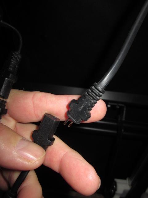

Today's job was a gimme.   Power recliner was not working.   Just stopped dead.   Usually, I start swapping parts until I find which of the parts is defective.   Today was a little easier -- power cord came undone under the seat.    Makes up for all the nasty jobs I've had this month.

Nice way to finish up the week.  Doesn't look like it has a snap lock to keep it together.  Tape it?
Nope, and yes.   This is the first one I've ever seen with battery as the primary power source (and not just a backup so you can get out in the event of a power failure.)  The battery is in-line between the brick (inverter) and motor.  Made so you can put the unit in the center of a room without having a long cord running to the wall.  This one would charge when you plugged it in or you could remove it and put it on a charger.
