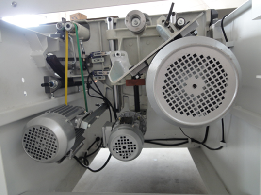

The main part of the sliding table panel saw, including bed, worktable, longitudinal section transverse guide plate, main saw, scoring saw, transmission and other components. The structure and working principle of common circular sawing machine is similar, and can be used as ordinary circular sawing machine.
The sliding table panel saw constituent part
1) frame; 2) main saw part; 3) slot saw part; 4) transverse guide baffle plate; (5) fixed working table; 6) sliding push table; 7) oblique saw guide plate; 8) bracket; 9) oblique saw angle display device; lateral guide baffle.

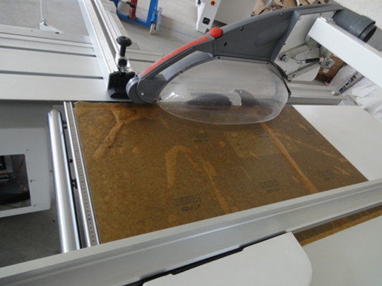

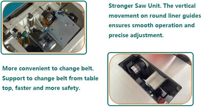

The main structure characteristics of precision sliding table panel saw is the use of two blades, namely main blade and scriber. When cutting, scoring saw ahead of sawing, the Machined plates of the bottom surface of the first saw draw depth is 1 ~ 2mm, width of the main blade groove thickness of 0.1 ~ 0.2mm, to ensure the main blade cutting kerf edge can not be torn, so as to obtain good cutting quality. Scriber with smaller diameter, usually around 120mm, driven by a single motor. The rotary speed of the blade is above 9000r/min, the cutting speed is 56 ~ 60m/s. scriber is aligned with the main blade in the same vertical plane. The main blade diameter of &8943; a 300 ~ 400mm from the main motor through the belt transmission. According to the different diameter of main saw blade and plate processing, the main blade can use variable cone, cone gear has the advantages of simple structure, is a constant power output, comparison In line with the actual needs of wood processing. The power of the motor is generally 4 ~ 9kw. to make a simple speed by a special triangle belt, ensure power transmission with a single belt. The main blade can rotate speed is 3000 ~ 6000r/min, and the distance between the main blade scriber is generally around 1OOmm.
Another panel saw the main structure characteristics of the saw blade and the main blade is crossed immovable, pushed by hand by carrying movable table plate made of aluminum processing before and after the move, realize the sawing processing. Due to the structure of the mobile station by rail J special, so the manual feeding is light and labor-saving when driving and, the processing precision is very high.
Precision sliding table panel saw rice bed mostly Yong 5 ~ 6mm thickness of the welded steel, stable and beautiful, can ensure the early sawing processing without generating tilt and twist fixed working table is fixed on the bed, Saikawa casting, require smooth, no deformation, and is provided with a longitudinal cutting plate and its regulation institutions.
The structural characteristics of mobile worktable:
Push the moving table is the key part of the panel saw. The main part of the mobile worktable are different from ordinary circular sawing machine comprises a bracket, guide, roller, push table and other components, its remarkable characteristic is:
(1)The operation is light and labor-saving, and the stroke is large, and the amplitude of the cutting plate is large.(2) trailers, with stable light stable operation; (3) setting and the main blade moving table for 45 degrees of adjustment, expand the scope of the use of some of the sawing machine sawing machine is attached with milling device, groove and groove width between 30-50MM processing can be carried out.
