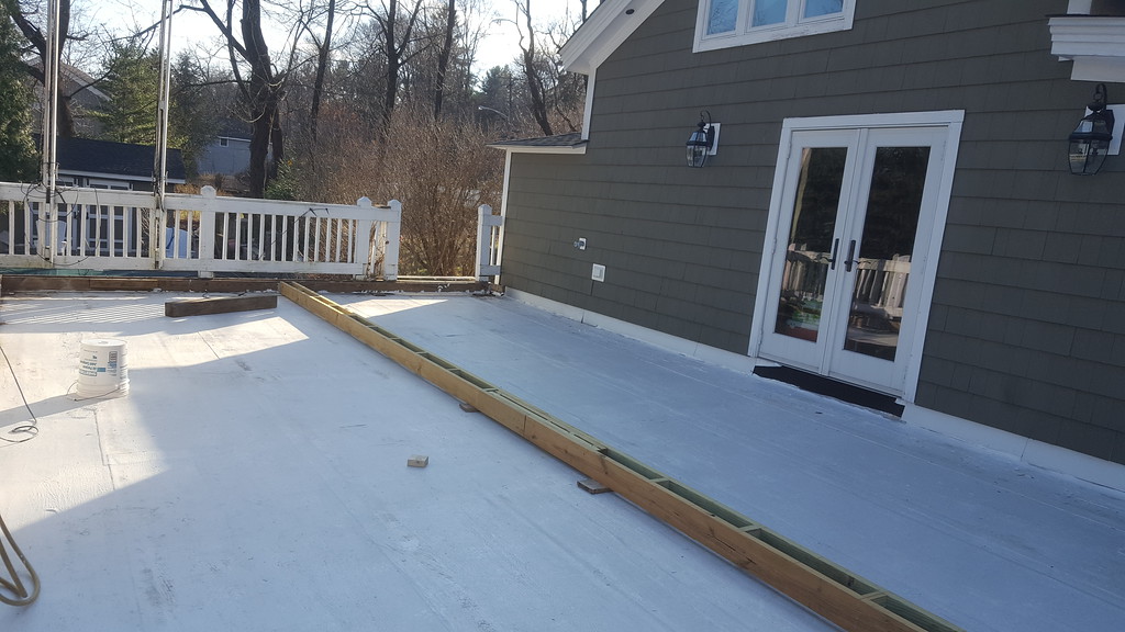

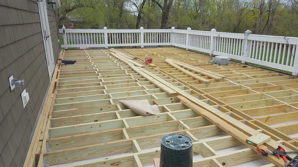

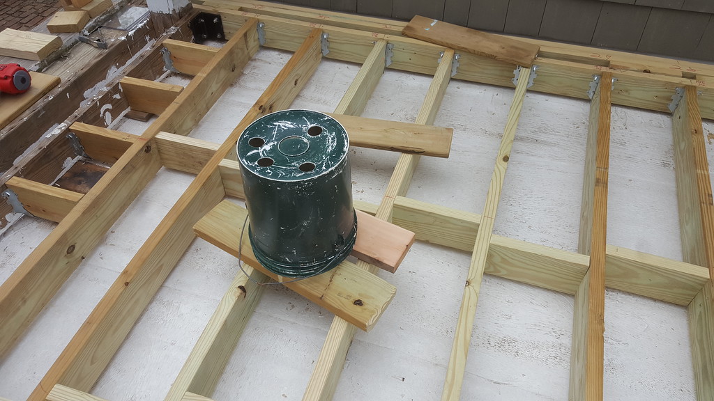

April 20, 20179 yr Popular Post comment_106923 That mountain of lumber I was wondering about getting from my driveway to the flat roof of my shop. Well AND THIS LADIES AND GERMS IS THE "BRIDGING INSTALLATION PRO" Yes it's a poly bucket with a couple hunks of lumber fastened to it but It saved my back the agony of being bent over the whole time I was installing that bridging. Edited November 20, 20179 yr by Ron Dudelston tags added Report
April 21, 20179 yr Author comment_107001 thanks guys. Those are all 12" on center for the PVC decking to be at a 45 degree angle at opposing directions from the center spine. LEMETELLYA Ohh my achin' back. I am still suffering from that ripped tendon That I did last may. The agony is over, but it nags at me in the evenings something fierce. I still put a heating pad on the leg and back. The muscles on the thigh area still light on fire. I'm glad that phase of the job is done. Now it's the solid PCV decking (don't want the composite). My lovely miussus has found the whitest color they make and I'm going to use the tiger claw type fasteners. Edited April 21, 20179 yr by Cliff Report
April 22, 20179 yr comment_107087 That's going to be really nice. How thick is that PVC? Bet you'll find lots of uses for the cut offs, too. Edited April 22, 20179 yr by Gene Howe Report
April 23, 20179 yr Author comment_107158 13 hours ago, Gene Howe said: How thick is that PVC? 4 quarter, just like regular decking boards. Report
