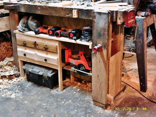

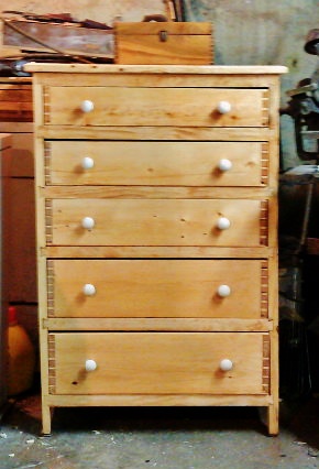

Have built two options for my little shop of horrors....
Doesn't HAVE to be made, any old dresser would do....( curb finds:o)
And, for stuff under the bench..
Sized to match a bench...has my Stanley 2246 mitre box sitting on that shelf, now
