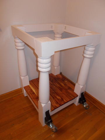

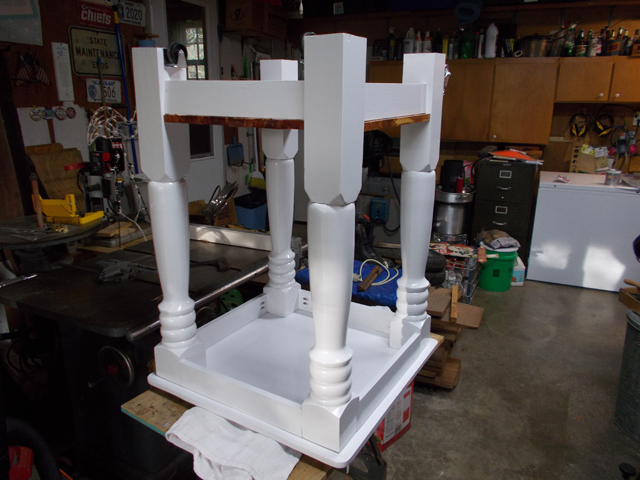

Work continues on the island.  Third coat of bright white enamel on, three coats of semi-gloss on the cedar shelf pieces, and hardware in place.  Base moved to the spare bedroom for safety (because I can break a crowbar in a sandbox)

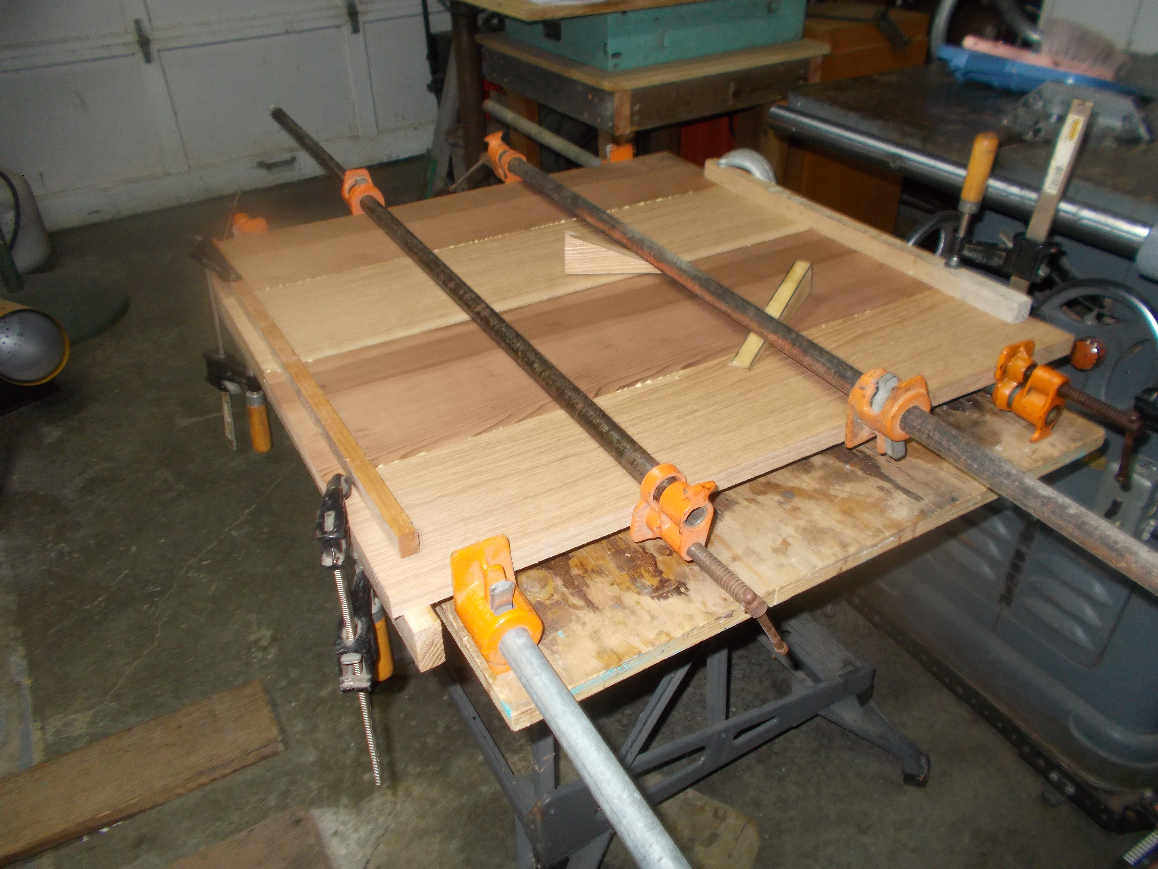

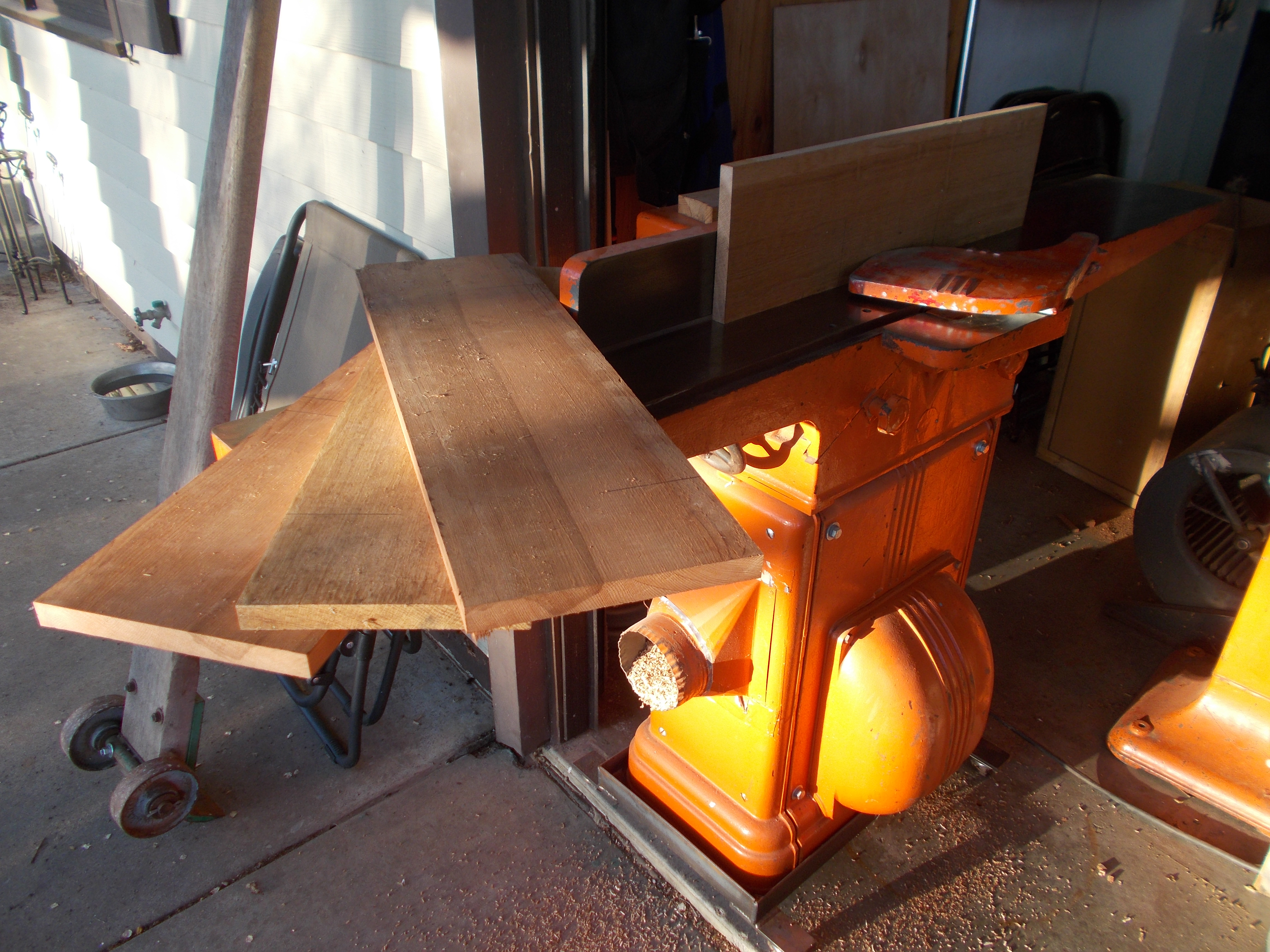

Now for the top.  Back to the rathole for more lumber.  But first true up the edges and flatten everything down to 3/4" in preparation for glue up..
DSCN0960.thumb.JPG.89114f04b0ab012dc0c95f4a9cd47a27.JPGDSCN0961.jpg.0871f3dcb1c237f6f303f7aaa951c88c.jpg
Keith you have a good eye.  My old Parks planer has served me well for a number of years.  DC Morrison still makes parts for these incredible machines, so I will keep her running for years more.

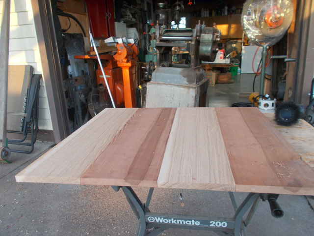

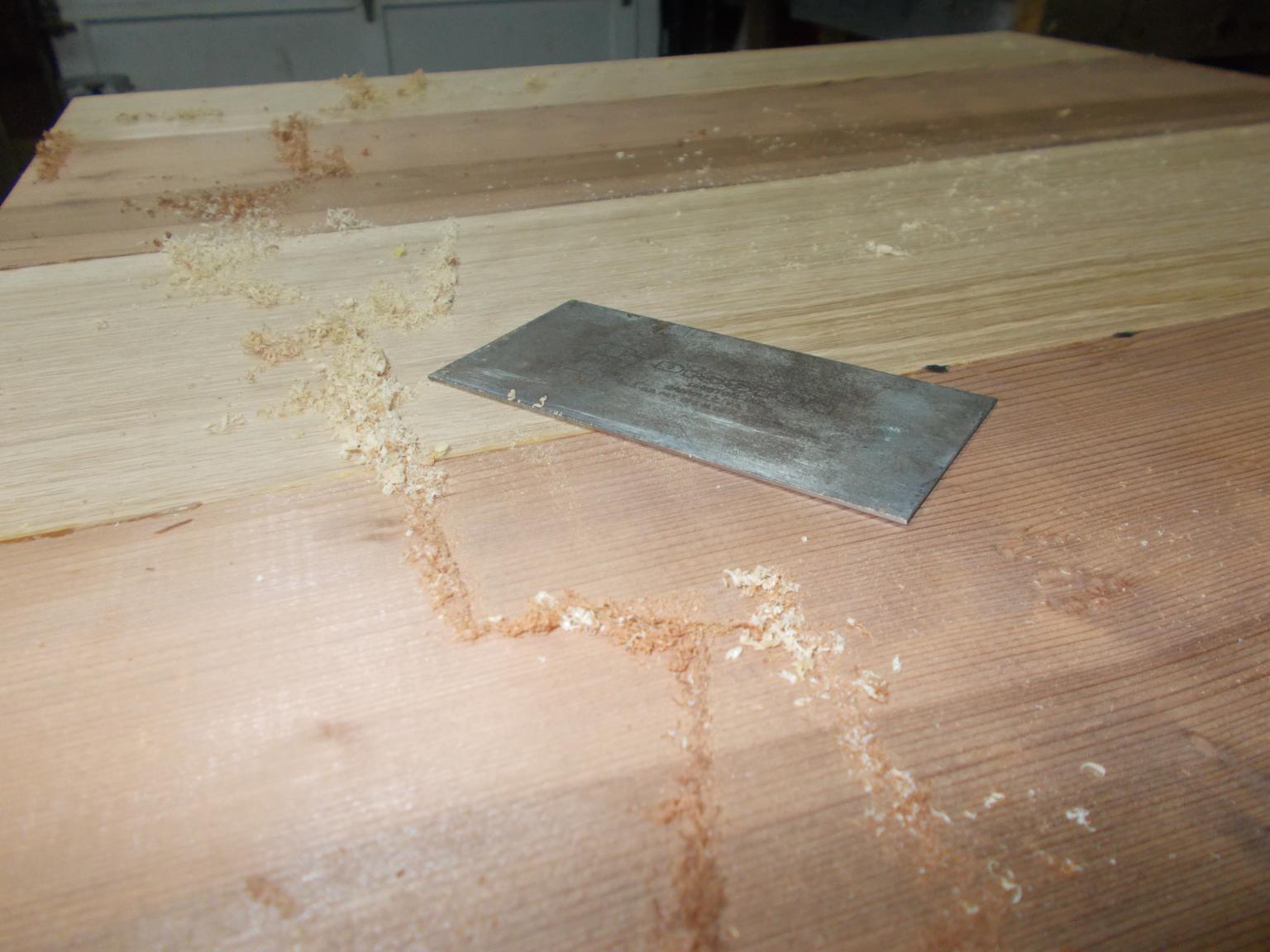

Glue up was anti-climatic, and after drying overnight its time to start scraping and prepping for cutting to size and easing all the edges.

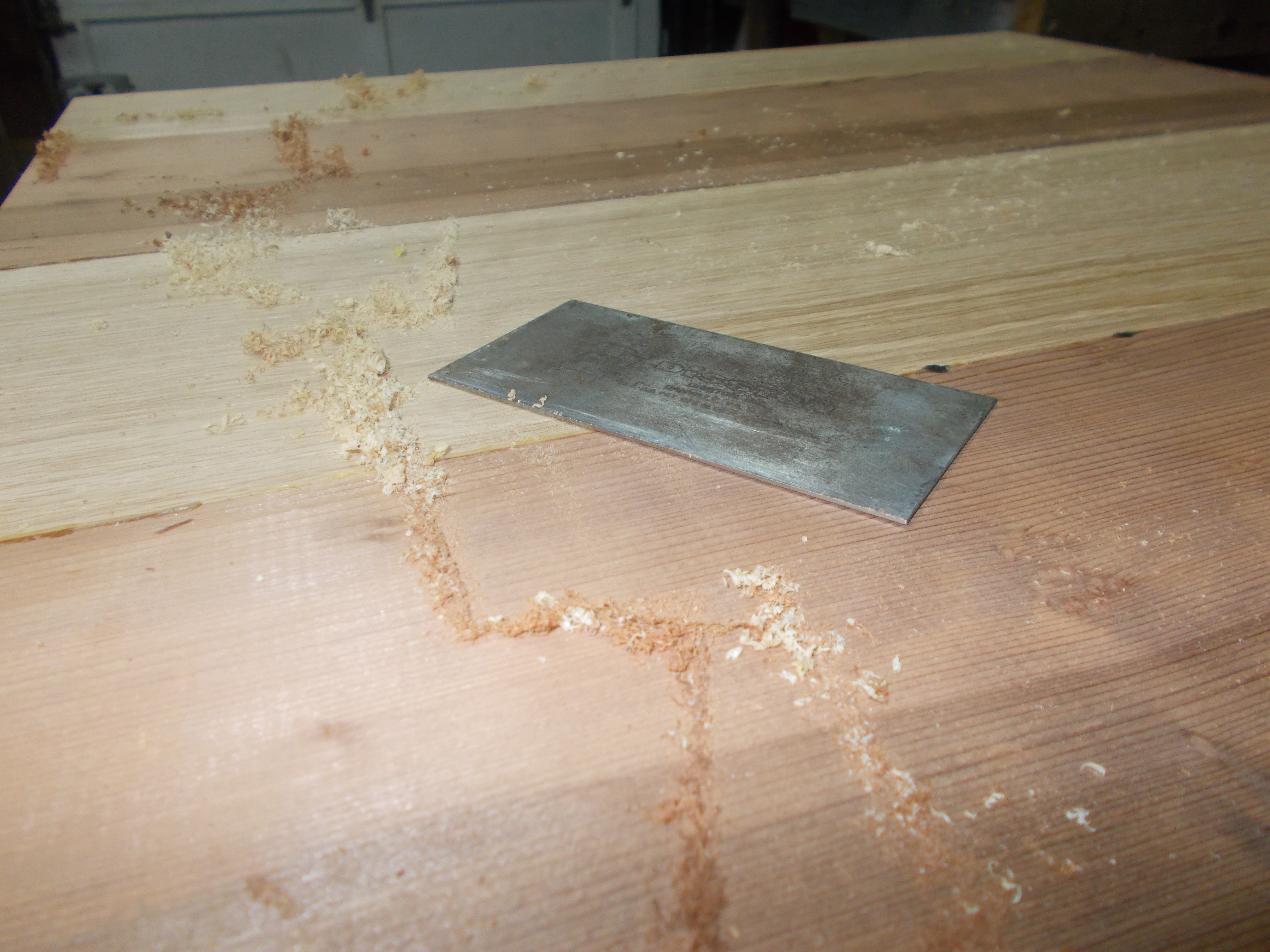

First time using card scrapers.  Found a set of four at a school auction and this seems like a perfect time to hone this skill.
I"m going to size this at 26x26" and trim out the base.  Thanks for the kind words and more to come

Really looking great. You will like the card scrapers. I use them a lot on joints for cabinets and tops.

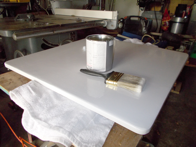

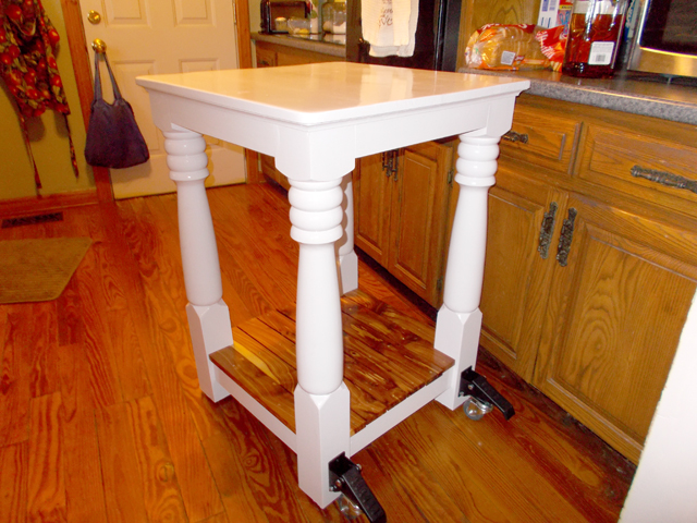

Good Lord this is finally finished!!!  Normally I stain most of my projects, but the client wanted an enamel finish for the top.  Well, with the damp weather, work and other vagaries of life this took forever.

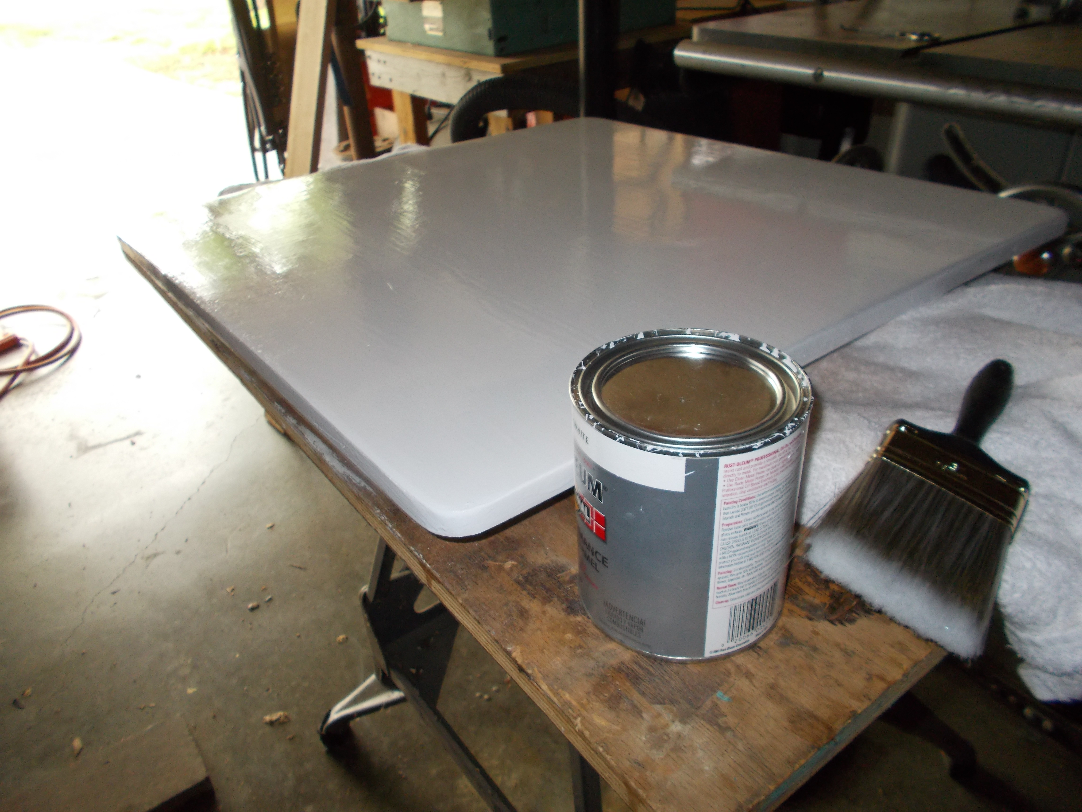

After priming, coats one and two went on and were sucked up by the driest boards I've ever tried to paint.DSCN0231.jpg.166cf3040b724792524ee1d639f59746.jpg
Followed by coats three and four along with sanding edges that had run, a 24 hour dry cycle and wet, humid conditions that complicated the whole thing.

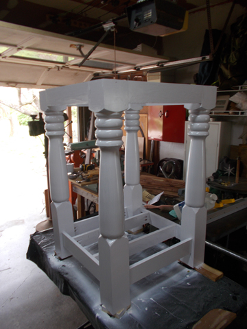

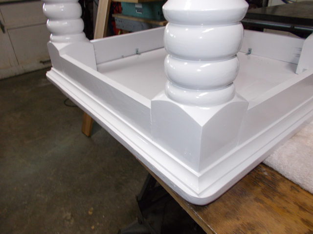

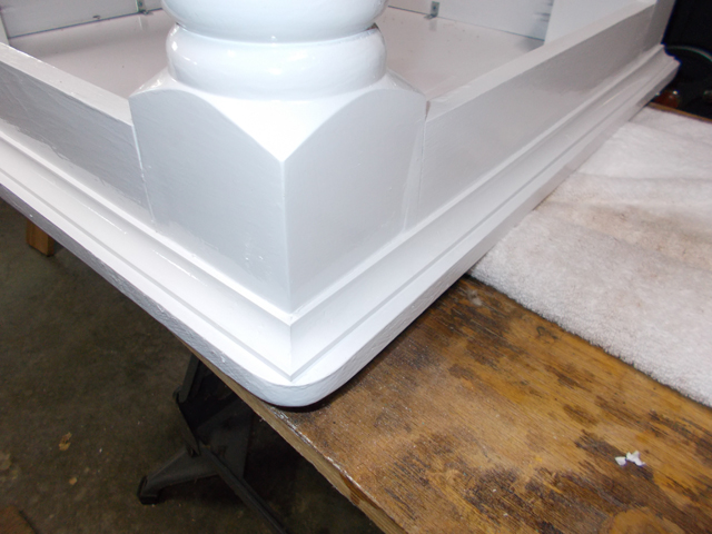

So, after struggling along I finally got to set the top this week.

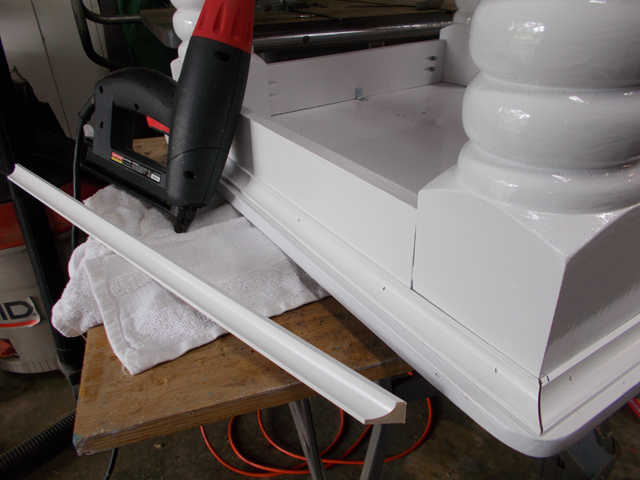

Then put the trim on to finish it out.
DSCN0236.jpg.f51e574a56f2e0f7d4e2ee43f5f29080.jpgDSCN0240.jpg.1d3a93a0d66f1776a78ade72e6711b61.jpgDSCN0239.jpg.ef9867707ffdc83778d9efac52ca8885.jpg

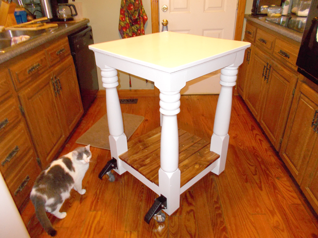

And a finished roll-around kitchen island is ready for delivery.  It is pussy cat approved as well.
DSCN0241.jpg.f71a3a2cccb611e8f08bd2ada69c4a32.jpgDSCN0244.jpg.0fae4b7cc5be70e47bd1e8fcfbb14b8f.jpg
Lessons learned:
(1) I need a better approach to squaring up the legs and rails, I wasn't as happy with how the legs turned out.  Cutting down a 6x6 would have provided a more consistent dimension top to bottom.
(2) Finishing is a bear with brushed on enamel, I needed to spray it for a cleaner finish, and I've really got to clear some space in the garage for working on projects out of the weather.  Inclement weather really slowed me down, as I couldn't work outside as normal.
(3) I enjoy retro-engineering projects.  This project has led to a second request for an island and may provide an interesting side job.
(4) This hobby is better than hanging out in the bar...but might not be any cheaper!
